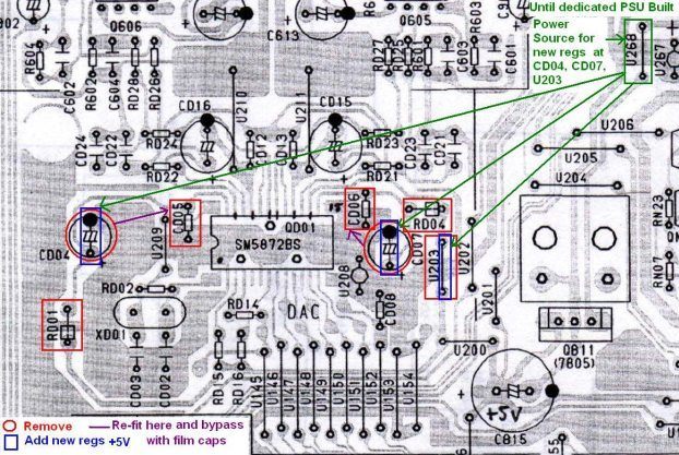

Hi Guys,
Big Internet Outage here due to Taiwan Earthquake s been incommunicado for a while. First phase of mods done (will post list with all updated Farnell and Digikey codes later) and player back together (and it works!!!) so am quite enjoying that.
I was wondering if anyone had a chance to comment on this post #4882 (move so fast this thread, everyone wants a piece of Ray and SimonT and Brent and AVR300 ... )
http://www.diyaudio.com/forums/showthread.php?postid=1068860#post1068860
It seems similar, bit not 100% the same to Ray's "OR" in the CD67OSE list.
OR: insert a separate 5V voltage regulator for the analog AVDD pins of the DAC. Remove U203 and U202. This trace is no longer used since C901 is removed. Place RD04 in the empty “+” hole of CD07 and in the empty hole of U203 that connects it to U200. Place a new 470uH inductor (+ 2 ferrites) in the other hole of U203 and the hole of U202 that leads to C901. Place a new voltage regulator on the back of the PCB, near C813. Tap power from U267 (-) and U268 (+). Place a small cap at the output of the regulator and connect it with a short wire to the empty “+” pin of C901, that will lead to our new inductor.

jksmurf said:Hi Guys,
It's about the same, only it uses more regulators to feed the different supply-pins of the DAC. Just tap power from C813, use a L-C filter if you like to supply a new regulator and output cap, and connect it to the DAC. Make sure the supply-pin is isolated first. Some regs need a 1k load to ensure a minimum output current (see datasheet) because some DAC pins draw little current (see datasheet).
Ray
Thanks Ray, sorry to sound daft again, but do these instructions apply to your "OR" mods or the ones I posted on the jpg above?
