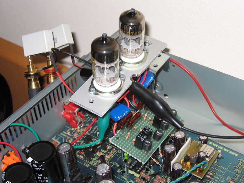

Or.....try a tubestage!
Whooohoooo!!!!!
SOUNDSTAGE!
DYNAMICS!
EMOTION!
....MUSIC!
No opamp can compete with this. I even dare to say that it sounds more....ANALOG :hot:.
This is the first attempt to get Thorstens Delta-Sigma circuit working and see what it does. So I mostly built it out of components I had laying around (especially notice the ugly blue ceramic suppression caps, since I didn't have 100n film caps...:D).
Ray.
