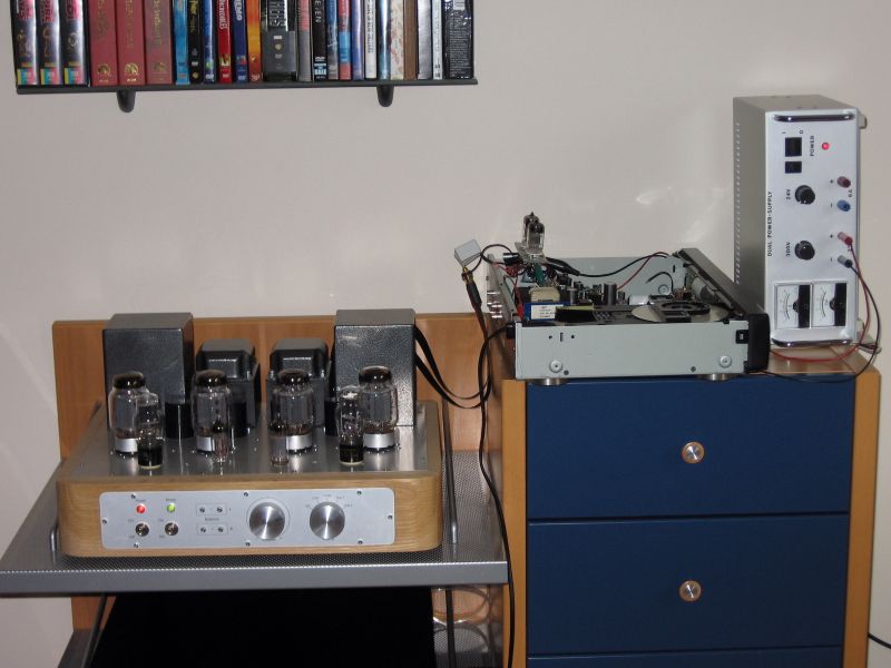

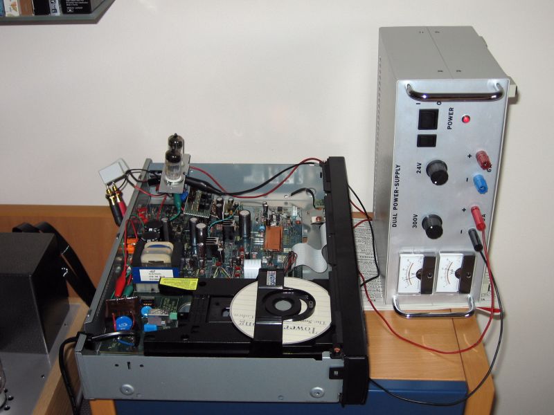

This is the first attempt to get Thorstens Delta-Sigma circuit working and see what it does. So I mostly built it out of components I had laying around (especially notice the ugly blue ceramic suppression caps, since I didn't have 100n film caps...:D).
I used a piece of aluminium with two holes for the tubes and hardwired the circuit. I wired the passive filter on a piece of veroboard and connected it to the outputs of the DAC.

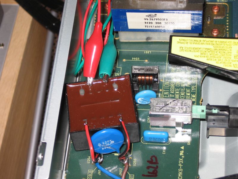

I have a HV tube PSU that I use for the supply to the circuit and used a small PCB tranny for the heater voltage. In the end I want to mount the tubes horizontally and fit everything in the player.
Ray.

Yeah, the PSU is a bit nasty, but very handy for testing purposes :D
It is an exact copy of Thorsten's circuit, and i'm very pleased with the first results, but I think there's a bit HF noise remaining in the signal (you can hear a slight hiss in the tweeter) and the output signal is not that strong. So i'm going to see if it can be tweaked, but I want to try a transformer also. See, this circuit uses only one of the DAC's voltage outputs, and a tranny can do a symmetrical to single ended conversion AND analog filtering.
It is not "that warm tubey sound" (thank goodness). It sounds like the same player with a good analog stage and opamps, but there's a lot MORE of all the good things present.
The soundstage has LOTS more space, the highs and mids are WAY cleaner and have opened-up, especially the -S and -T sound very precise. And overall the sound can be soooo relaxed, more peace and quiet in the background with Diana Krall, but if you play something like Bjork it is very dynamic and fast.

This is all compared against a modded CD63 and a newly modded CD67-OSE. The tube-player is a CD57 chassis which uses my "old" modded CD67-OSE PCB. So both the PCB's are about equally modded.
The CD57 holds a Tent XO-clock, the others a Kwak-clock. There is some difference in the parts I used (Elnas in the CD57, Rubycons in the CD67 etc. etc.) but not much. All players use the on-board supply, no extra tranny's and regulators (yet...).

Sorry, forgot to mention, I have fitted schottky diodes at the rectification stages.
I did, in my general upgrade of caps, place (I think it was 0.01uF) ceramic caps as decoupling on the servo drivers (is it TCA3072, don't have my service manual to hand), but made no other progress in that area.
