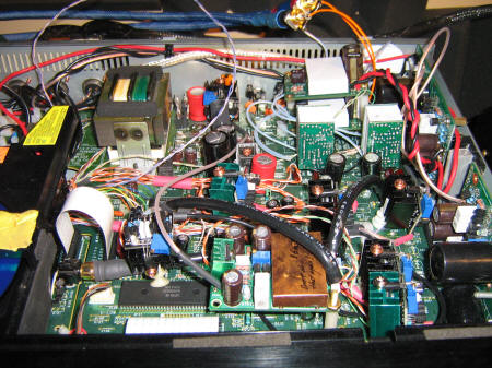

Glenn2 said:Latest on the Burson Audio homepage...
Oh that is just superb! I love those messy and full players. It looks like an engine bay...
Re: Marantz KI DP internal shot
Interesting. The former owner "biscuit" was clearly devestated when he realised the upgrade amounted to some Black Gates and a load of copper, and a filter component swap. And it sounded like that much too.
That photo shows a couple of BG in the output, and a couple at the DAC. I actually feel a bit sick on their behalf. And the reviewer's credibility? Surely taken a hit LOL

Mags said:Check out this thread for some internal pic's of the DP mod's!
http://www.hifiwigwam.com/view_topic.php?id=5174&forum_id=5&highlight=cd63+ki+
Mags
Simon
Re: Re: Marantz KI DP internal shot
That's tops! I don't know whether to laugh or cry!
Simon

poynton said:I cannot see any evidence of PSU rewiring in the internal photo. Only 2 Black Gates.!
Maybe he also removed some fuse resistors?
Apparently, according to the links etc., he adjusted their value and that of the main fuses as well !!!! Not bad for £1000 !!!
Andy
PS.. I think that means to 0 ohm with a bit of copper wire !
