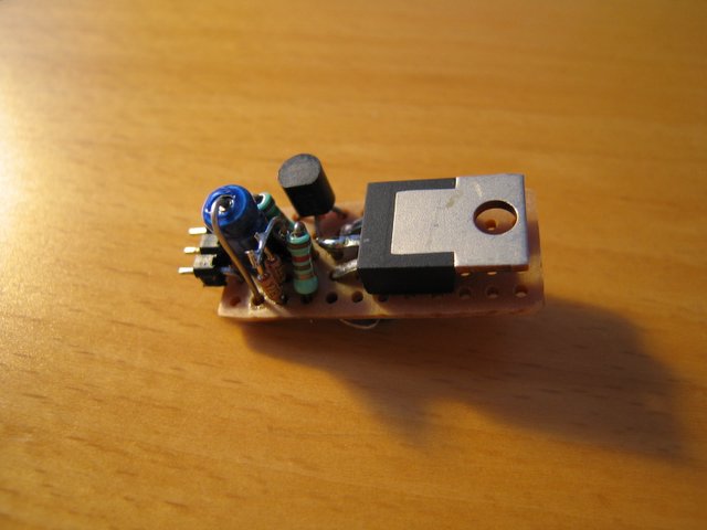

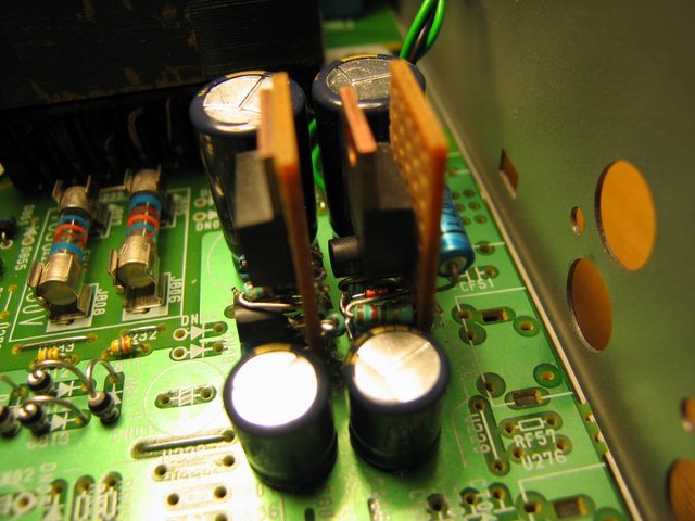

Just upgraded my Raygulators til Super-Raygulators :D by adding a gyrator / VBE and changed R2 to zener stabilisation with temperature compensation. It became a bit crowdie as you can see. Just made with standard components - the gyrator cap will be changed with something better.
Thanks to Martin at http://www.acoustica.org.uk/
Now, onto some music.

Fantastic, looks great and so small! Looking forward to your listening impressions.
Simon
