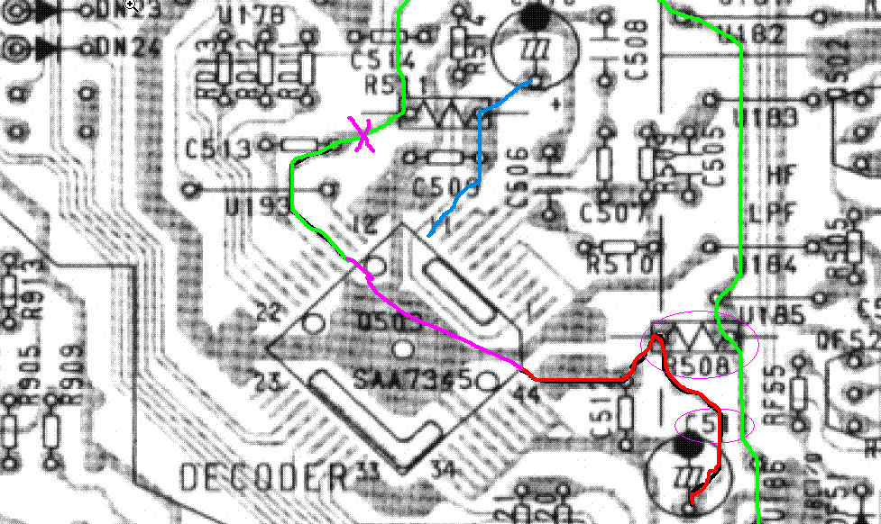

Clock signal from DAC to Decoder
I've built Flea based clock to replce my kwak clock and decided to supply clock signal directly to DAC and Decoder. After some discussions with Ray we've noticed that CD67 PCB is wrong and doesn't correspond to schematics! Clock from DAC should be supplied via RD14 to Decoder pin21 (CRIN) and CRIN should be connected to CROUT via 100k (R104) resistor. On CD67 PCB this is implemented in wrong way i.e. clock signal from DAC goes via RD14 to Decoder CROUT and to CRIN via R104!
As Ray said "This also explains why the mysterious DC offset is present on the input! That's because it's actually an inverter output!".
Re: Clock signal from DAC to Decoder
The CD63 also has a similar error on the 5v rail where pin 15 is direct from 7805 and not through the resistor. Something to change when fitting regs.
The blue link shows where it actually goes and not how the diagram shows
I cut the track and link out
Brent
renatas said:I've built Flea based clock to replce my kwak clock and decided to supply clock signal directly to DAC and Decoder. After some discussions with Ray we've noticed that CD67 PCB is wrong and doesn't correspond to schematics! Clock from DAC should be supplied via RD14 to Decoder pin21 (CRIN) and CRIN should be connected to CROUT via 100k (R104) resistor. On CD67 PCB this is implemented in wrong way i.e. clock signal from DAC goes via RD14 to Decoder CROUT and to CRIN via R104!
Brent

Re: Re: Clock signal from DAC to Decoder
I noticed that one when I was upgrading the '63 PSU. The schematic seems to be correct: pins 15 and 44 have to be connected and fed from the same source, according to the datasheet. Makes you wonder if Marantz engineers actually read it...
This input-output-DC-offset-thing never struck me, until Renatas pointed it out . I'm getting sloppy . It's amazing, they actually reversed the input and output, and it remained undetected because the player works fine .
Ray.
rowemeister said:The CD63 also has a similar error on the 5v rail where pin 15 is direct from 7805 and not through the resistor. Something to change when fitting regs.
Brent
Ray.
So how do we fix the problem, do we just switch the connection from before r508 to after it??

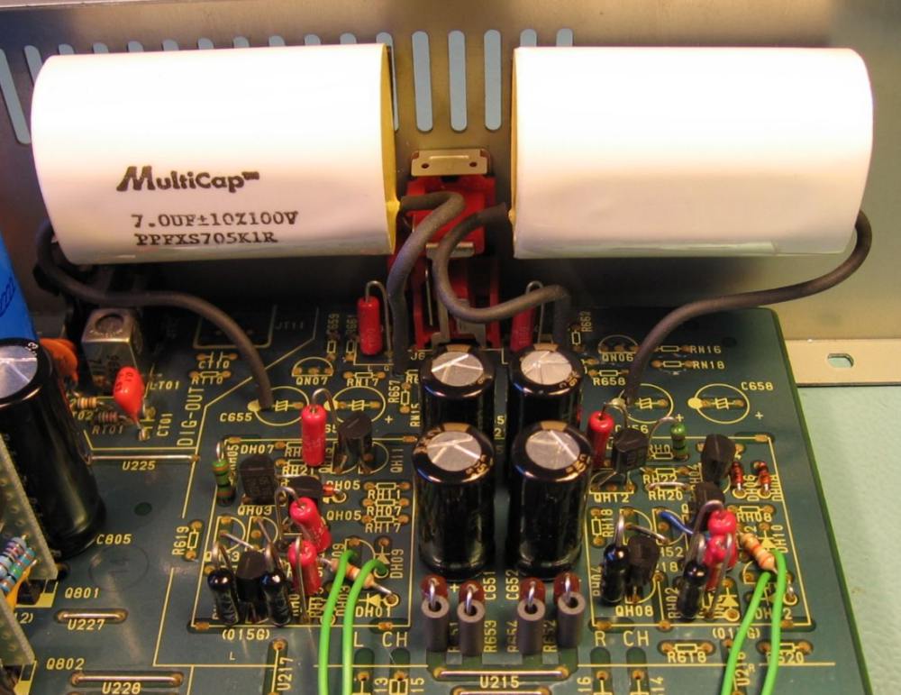

6h5c said:Hey guys,
Just finished the upgrade of my FET output stage, with Holco and PRP resistors, and big @ss Multicap polyprop & tin foil output caps .
Can't wait to plug it in...
Ray.
Ray i must say that looks stunning, and will probably sound it too. I'm seriously considering ditching my opa627+ad8610BZR combo for that output stage.
But how easy would it be to implement that into a 63 and would the parts cost a lot.
O btw, i wont have a new player for about a month as im off on hol soon, and still can't be assed to try to fix my borked player. Even though i ripped off a few tracks whilst doing the coax mod, i jumpered the correct parts, did the coax mods and cut the traces, but it still says 'disc' on teh display all the time
Re: Re: CD Enhancer
Hi Ray, oh yes, very nicely made!
Hi Ad,
If I were you I'd concentrate on getting a player working, then giving it a good old reclocking, upgraded power and new op-amps. That output stage is the icing on the cake and not strictly necessary for lovely and precise detailed sound (IMO etc.).
Simon
