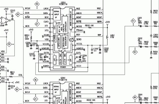

CD17 mkIII has 2X PCM1716 DAC (built in Burr Brown opamp (opa2134 quite possibly)
I can remember Thorsten talking about an opamp in a high end dac and he was disgusted they used 5534 or what ever that el cheapo is. Have no idea what PCM1716 uses.
Let me enlighten you from CD17 MKIII
Brent

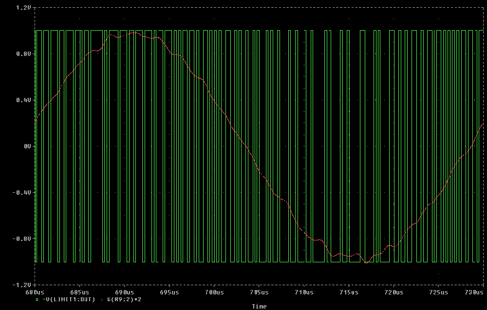

awpagan said:the sm5872 has an internal opamp
dac's without opamps have current out
allan
ps i'll see if i can find the thread.
No it doesn't!
Those are the output buffers. This DAC has no current nor (analog-) voltage out, but pulse density modulated waveform.
And there are plenty of DAC's without opamps that have voltage outputs .
Mostly you get something like a switched capacitor network in return .
Ray.
