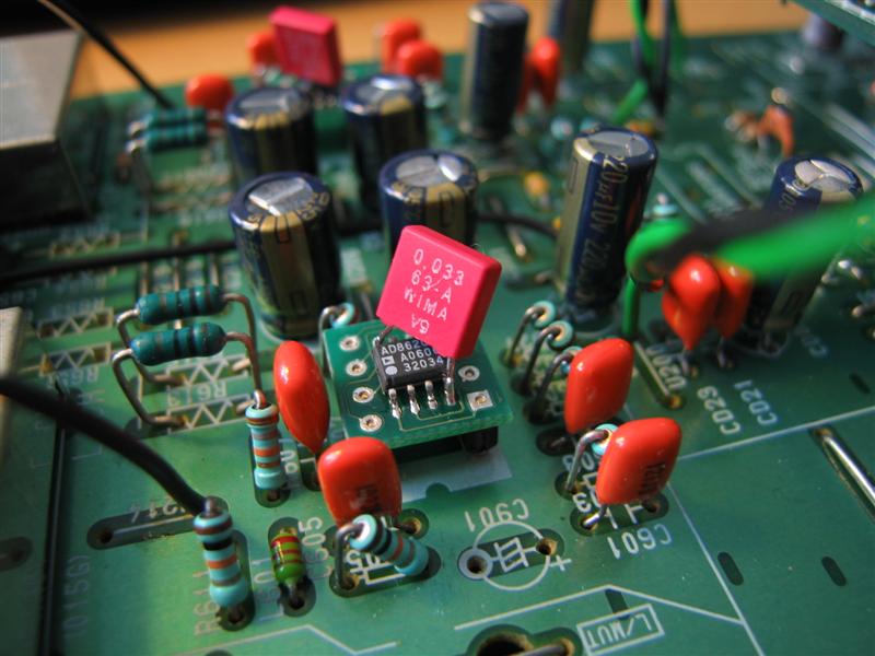

Hey Brent, don't forget to harvest the FET's out of the HDAM stage .
Ray.
I did take out the 2SK170's
Brent
avr300 said:Malefoda.
Like this !
But do have a steady hand, and don't overheat the 8620.
What kind of cap I should look for on websites ? I just see it is... quite square
There Wima caps Farnell has them .1uf should work orthers might be using something different. I knowthat I need to get some and do some bypassing in my 63
Regards
Dave

Malefoda said:Cannot edit ?
whatever, I meant a AD8620BR for headphone (BR is overpriced for audio I've red...).
Why they used a diffrent opamp for the headphone ?
The headphone opamp is cheaper!!! Ive fitted an OPA2134 in the headphone circuit and fitted better caps and my friend was very happy with the sound output.
Just treat it the same as you would for the main opamps
Brent
