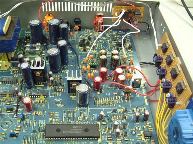

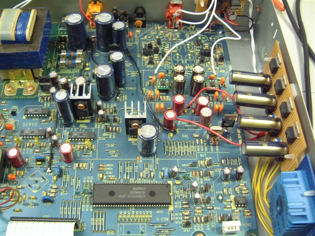

rowemeister said:Here is a pic af a CD67 I have modded for low cost. It also has relay muting.
Brent
Panasonic FC , stock Elna Silmic and Cerafine but what are those bog blue ones on your PSUs?
BrownDogs with what? Still need to match the filters, I guess? Try carbon for the analogue part.
If you have some copper laying around, build an enclosure for the xtal, maybe 2x 10pF polystyrene?
Regards, Jaap
Regards, Jaap
lol
The bog blue ones are infact FC now. I was messing with values and took the picture before I changed those.
The brown dogs have OPA627 OPA132 combo on. All caps are bypassed.
Schottky diodes , 5ppm crystal , damping etc etc
The unit is being sold so i'm not going to great lengths on it and it sounds a hell of a lot better than a stock KI
Brent
