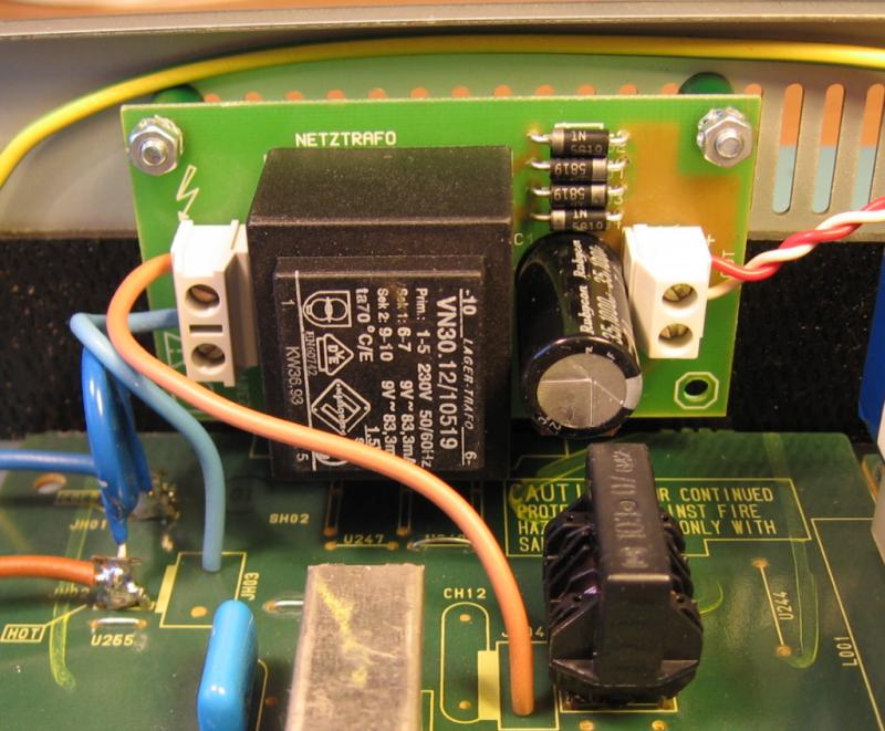

And here's a pic of the dedicated PSU. I used a ready-made module and modified it with schottky's, a nice big cap and the right tranny and a 24V regulator. Now that I think about it, in the end I only used the PCB.... So the Flea PCB gets a regulated supply. That makes it a pre-pre-regulated supply, I think . Nice and neat, eh?

Nice - I like it. Hard to get the components ?
Now - get it running and do some listing.

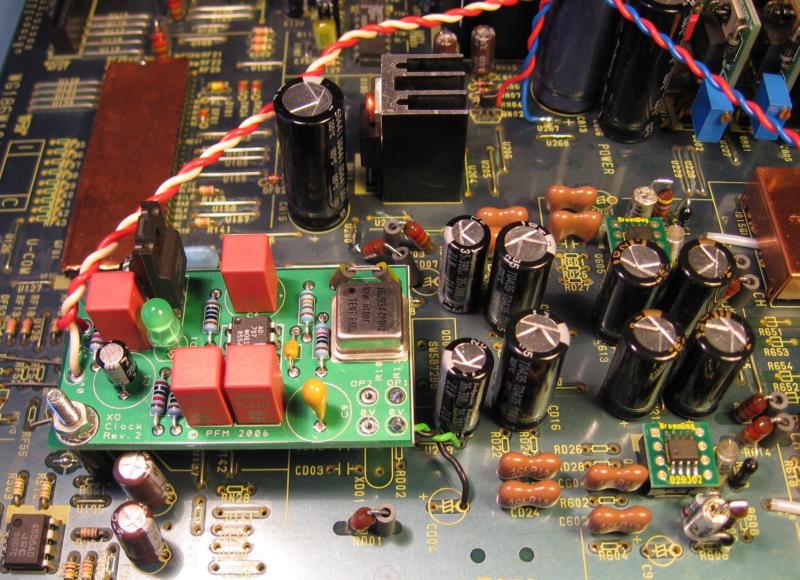

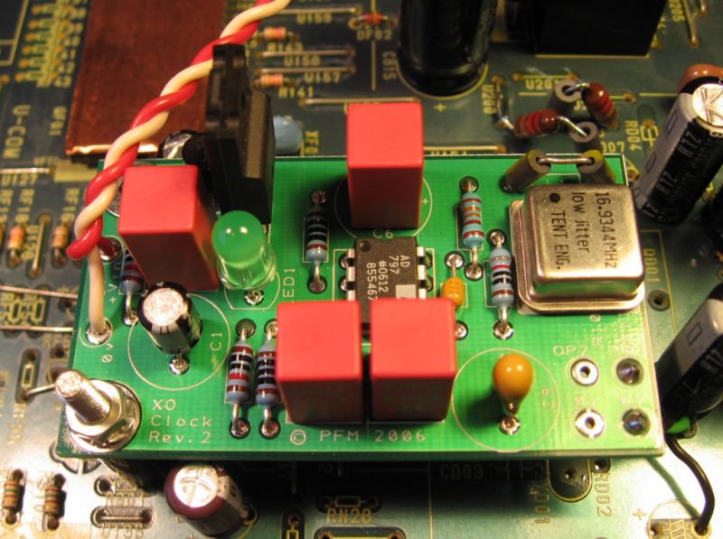

Thanks. The components weren't hard to get, but I had to wait until I scraped together enough parts for a Farnell order . I will do some listening tomorrow evening, can't wait. Almost nap-time now ...
Here's another pic.

What's the OPAMPS on the BDs ? AD8620 ?

Thanks! This player is a CD67-OSE. The Flea + PSU replaces my home-brew Kwak-clock PCB. I'm curious what the difference will be.
After the DAC I use an OPA124 (the one on the top) and in the filter an AD8510.

Tasty smal PCB Ray. Only 25V for that 1.000uF?

Nice eh? I got it from Conrad. It's a small 78Lxx supply originally, but I took (almost) everything off and transformed into 24V. By the way, look harder: that cap is a 1000u/35V ZL .

mica's and styrene's
you and Brent must have cornered there market on mica's by now
are the reg's version 2
"vari-rayulators"
allan
ps
I like the "state of the art" opamp for the headphones

Yes, Farnell is out of stock on 120p mica's now .
The "Vari-regs" are version 1.0 actually. I bought the PCB's from Eddie Wang's DIY site a while ago. But he seems to be out of stock, so I decided to make them myself for the next player, with fixed resistors. They are now known as:.........the "Raygulators"!
"That poor 4556 is all that remains"
