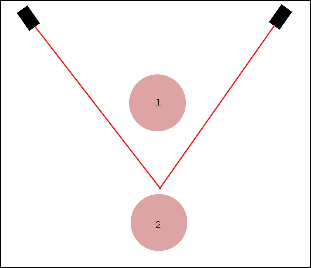

Dave,
You are playing with the TLAs today - WFW - Woofer Full-range Woofer - at least I managed to decode that :).
The WFW EL66 MLTL - is 14' x 12' too small for such a system? I have tried to provide a diagram - speakers kept roughly 10-11 feet apart, toed in approx 45 degrees, listening distance comes to roughly 9.5' for position 2, approx 6.5' for position 1.
-Zia
Dave, was studying the EL66 ML-TL plans - single woofer MLTL design also looks good - dimensions are very room friendly.
With HF+Mid Range duties passed on to a 4 inch FR, there still should be enough bass impact to beat an EL70 Micro Tower? Or am I expecting too much from 6.5" woofer with 5.5 mm xmax?
-Zia
EL166 has ~3.25 times the Sd as EL70. Take ~ 4 EL70 to move the same air. Plus the lower Fs means capability for more extension at the low end.
dave
