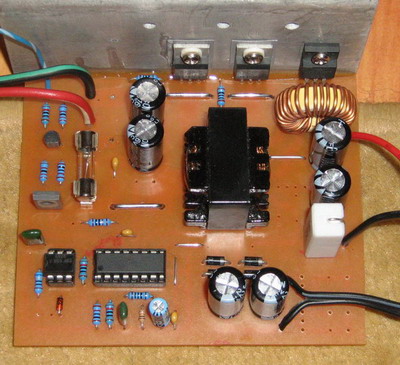

I have noticed that when i turn off switch (new schematic) one of fets for a very short time is turned on, and because of that current for that short period of time become very large (this forced transformer to make noice during shutdown,so i noticed this). This is happened probably because Voltage is not suficient for TL494 and one of transistors in it continues to conduct but Voltage is sufficient for CD4050 thus this, one of fets stay turned on.
I added circuitry that prevent CD4050 to work when Voltage is below 9V.
What is the purpose of CD4050 ?
You can obtain 150W, and more ( @38KHz ) from single EI33 core.
It's better to isolate input and output ground.
TL494 also need power supply ( pins 7 and 12 ) - drawing error ?

This is the pic of my DC-DC ( max 120W, core EI28@55KHz ) for small class D amp.

m-tech said:What is the purpose of CD4050 ?
I need those books so, please, upload them on Rapidshare.
Hi M-Tech,
Very nice proto, Please put here schematic and pcb file
by using CD4050 transition from 0V to Vcc or Vcc to 0V is much faster (t rise or t fall are very small), because input capacitance of CD4050 is much smaller than discrete transistors and output pair of transistors in IC are very fast and with low Vds so you may potentionaly spare some power.
I have used Protel99 to drew scheme, and in protel there are not pins for supply at symbols for many of ICs.

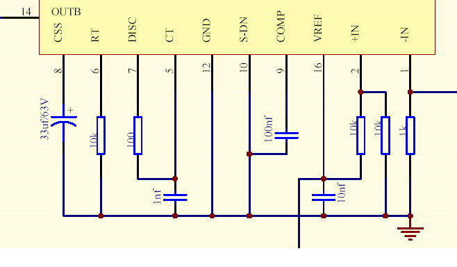

hi !
how can i calculate sg3525 ics frequency ?
i didnt see a clear formula in datasheets !
excuse me if i ask silly questions because i am not a EE !
i am an IE !!
i have a avo meter with frequency measurment capability ,
when i use both two probes to measure frequency shows 7 khz
but when i use a single probe it shows 37khz !
witch method is correct ??
best regards

Frequency (bottom of page 4):
http://www.st.com/stonline/products/literature/ds/4286/sg3525.pdf
Black lead on ground and red lead on the gate of the transistor or red lead on the output of the IC (pin 11 or 14) will probably produce the most accurate readings.
thank you perry
i used to check farchild , sg and samsung 3525 ics datasheet but they didnt put the formula on their datasheets (maybe "datashit"
but ST did it !
below picture is the schematic of my smps.
can you help me to calculate the frequency ?
i already made and used it , but i think performance is lower than expected.
i used discharge resistance as Rd =100 ohm and other values , formula says frequency should be around 136 KHz but avo meter says 7.5KHz (according to your wrotes about avo meter leads)
so what do you think ?
hint : my winding is 4+4 for primary , and i think 40KHz is suitable frequency.
