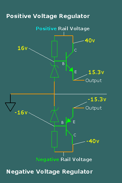

Hi Risto
First circuit if what you want to have, 200 ohm resisitors being as load, preamp. If that is not enough you can build the one on right. There are 2 power zener that can deliver more than 1A for -/+15v. For transistor you can use any npn transistor that you can
For the preamp, he would need the negative regulated output to be 15 volts below the reference (ground) not 15 volts above the bottom rail.
He would have to use a PNP transistor for the negative regulated output. The zener and resistor on the negative regulator would have to be reversed (zener connected to ground).

Ah my mistake. Thanks for seeing it

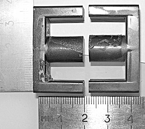

Hi all!
Can you help me to make transformer for SMPS (http://sound.westhost.com/project89.htm)?
I found core from very old AT power supply and now I have some questions
1) May I use this core?
2) Max frequency for SMPS with this core?
3) How many turns for primary ?
4) Diameter for primary wire?
5)How many power I'll get from SMPS?
Thank you and sorry for bad english.
Yes, that's a ferrite ETD39 core. It's an excellent choice. You should have a bobbin though to hold the sides together.
I don't know the material it is made from but I would guess that 150kHz is not unreasonable.
This depends on the flux excursion and wire resistance. If you're running it off of 12v - ( I haven't read that article in a while, I'm assuming it's an automotive dc-dc ) you would want perhaps 8+8 turns if you're running at 50kHz. This is just a wild guess. "YMMV"
This depends on the power level. If you're trying to get 500 watts out, you would have an average current of 40 amps. This would mean at least 2 12 AWG wires in parallel.4) Diameter for primary wire?
Less than 500 watts.
These are just guesses. There are many important factors to consider when designing a power supply. The magnetics (transformer) are in my opinion the most difficult part to design.
Good luck. Interleave the primary with the secondary so that you have low leakage inductance. If you're kind of hacking this together anyway you want to at least do a good job where you can.

Thank you a lot!
It's just what I looking for!
