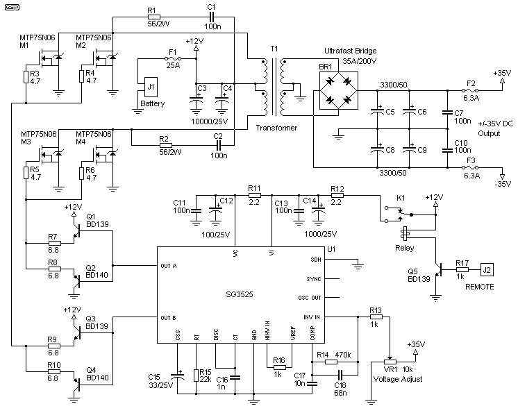

now, th regulation: i dont know how to implement that with sg3525....can i get any schematic/link on that?
Thanks again!
I don't use the SG ICs and they work a bit differently than the 494/594 but this is essentially what you'll need to do.
You'll use the internal comparator. Create a voltage divider with 2 equal value resistors. The top of the divider will be connected to the regulated 5.1v of the 3525. The bottom of the divider will be grounded. The point where the resistors connect will go to the non-inverting input of the comparator.
You will use another voltage divider to feed back the rail voltage to the inverting input of the comparator. One of the outer terminals of the pot will be connected to the rail voltage. The other outer terminal will be conected to ground. The wiper will go to the inverting input of the comparator. You'll set the pot to control the regulated voltage. You can make the adjustment a bit easier by adding a resistor between the rail voltage and the pot.
You'll have to select a pot with enough resistance so that the voltage across it will not produce power dissipation greater than its power rating.
Page 6, figure 8 has a similar circuit. It's a different IC but they function the same.
http://bcae1.com/temp/sg3524.pdf
Hi
You didn't read this thread, or any other, did you?
On first page you have schema of smps that has feedback/regulation. Thats one way of doing it...the other way, you can find where I posted my supply, it is not 12V supply but if doesn't matter...if you will search for it and find it, just look how opto is connected, not what is on secondary side....just how is connected to SG. And there is another way... but there you don't have insulation between primary and secondary...your choise

i have made a simplest circuit using the pcb from this thread....which works on 37khz....
i am building this circuit again with the PCB and 100% according to the schematic...
now, the feedback in this circuit is taken from +/-30...
dont you think it need to be adjusted since i want to use it on 42v single supply ?....
what do i need to change in the feedback circuit to achieve that or can i used the same as is?
Thanks again for your help guyz !
Hi
If you are going to do FB with zeners, just change zeners so, that they will add to what you want. Original was +/-30=60v so 2x 30v zeners, in your case you will have to put some other, zeners don't have to be the same...
If you will use same board as in this thread you need to change only zeners to set output
Ps: but when you get to transformer winding, say so here, I don't want you to just wind it as easy as you could...you should do it the right way

This is the easiest way to control voltage. Just use a pot between the inverted input and the comparator input as in this schematic. If your not using for an Audio amp ground noise wont be a problem.
you are right....
well...it was my mistake....now, both of them works like a charm...
i am now, using the optical version....which works like a charm....

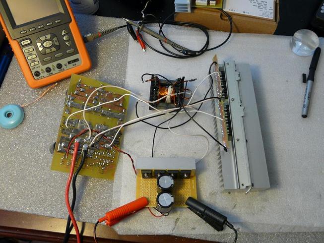

i have used the original pcb with 4 mosfets...:
got arround 4 amps out...
then i have moved a bit furthur...
i am using 5 mosfets on each side
with BYV72 rectifiers.....in a brigde.
results till now:
44v at 9 amps.....i have'nt tested it furthur...since i had to leave my battery for charging...
on the transofrmer: (at the moment)
Core: ETD49
Primary: 0.4mm (26-awg) 16x 4 turns
Secondary: 0.4mm (26-awg) 8x 12 turns
I will post more results once i figure out the transformer ratio.....
i will also post pictures by tommorow morning.
Thanks again !

6 strands OF 14-awg wires for primary, 2 or 3 for secondary... I want to see pictures, lol never seen ETD49 in 12v smps
i have used 24 strands of 26-awg for primary
and 12 strands of 26-awg for secondary....
still testing...results are satisfactory...will post some results soon.
till then, here is a picture.
You're going to have to minimize the resistance between components to get significant power out of the supply. The thin wires between the various components are going to induce significant loss in the circuit.
What load are you using to test the circuit?
Are you connecting the load from the center tap to the positive output or are you connecting it from the positive output to the negative output?
How low is the voltage dropping across B+ and ground?
