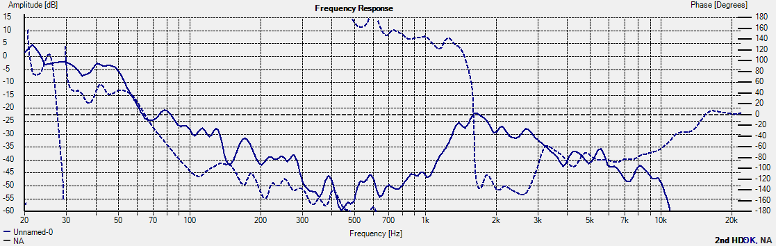

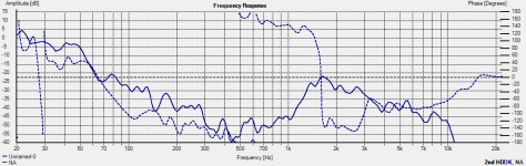

One more with a flatter W shape Planar. Measured fullrange 1 meter

I haven´t used DSP. Just some smoothing. Maybe sunday I will find time and space to make a nerfield measurement
Raw respons

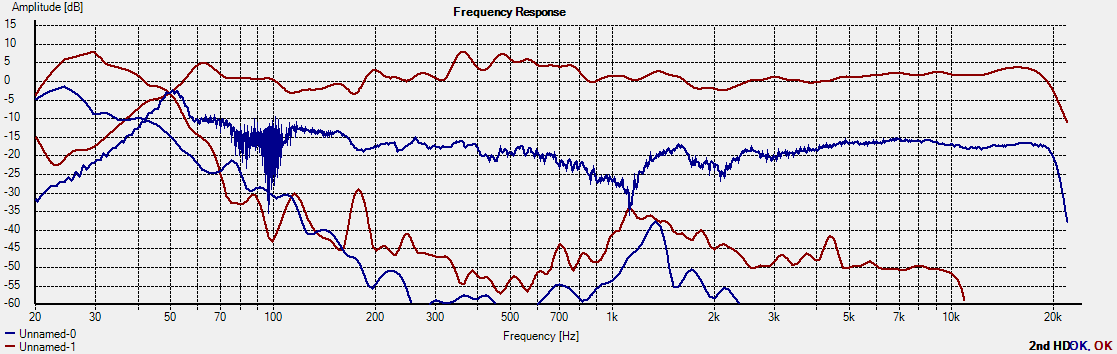

Red curve distance 1 meter. Blue curve distance 1 cm raw respons.
Distortion goes up at 1300 hz ???.
that looks really good to be honest. the increase is due to phase cacelations , thats why you see the dip, when the ouput lowers the distortion goes up. can you scale a bit down ? since half of the disortion plot falls of the chart
but looking really promising dude!
a complete wave at 1300 Hz is 26 cm when one wave is reflected half a wavelength in extra travel time it creates a dip.
there should be a problem with a distance of around 13 cm anything measuring 13 cm ? in you construction ?
try to have 1 2 3 harmonic to be in one plot
you can hunt down this problem by using REW put the generator at 1300Hz, then use the scope thing where you can read disortion live, and play around with covering edged of magnets for instance, or it might be the grill itself or the slots.

This isn´t my own speaker. But one I sold years ago I just chanced the planar to the W. And I think your right it is proberply the grill for protection of the ribbon. The next version for my self will be without the grill. I can make I a new planar in case .
I will try that REW. Holm only one distortion in one plot.

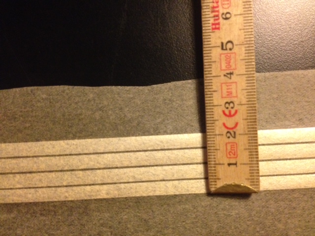

I take a picture when I get home from work of and unfolded ribbon. So there are no misunderstandings

very nice dude!thanks for the photo, how did you manage to layout the 4 micron alu so nice. you cut it from bigger roll on wetted glass?
this cap paper is this the verry well damped stuff, tha paper that not make noise on its own if you know what i mean when you wrinkle it.

I tighten it up with tape on a bent MDF plate, then I line it up before I glue it. I don´t think that paper that thin and soft, damped with contakt glue and alu will make noise, but I am not sure .
PS use the soft toilet paper ;-)
sorry im not really clear in what i write. i ment. you paper is the sort of paper that does not make sound when wrinkled (indeed as toilet paper as well but thats to sloppy to hold any shape?)
