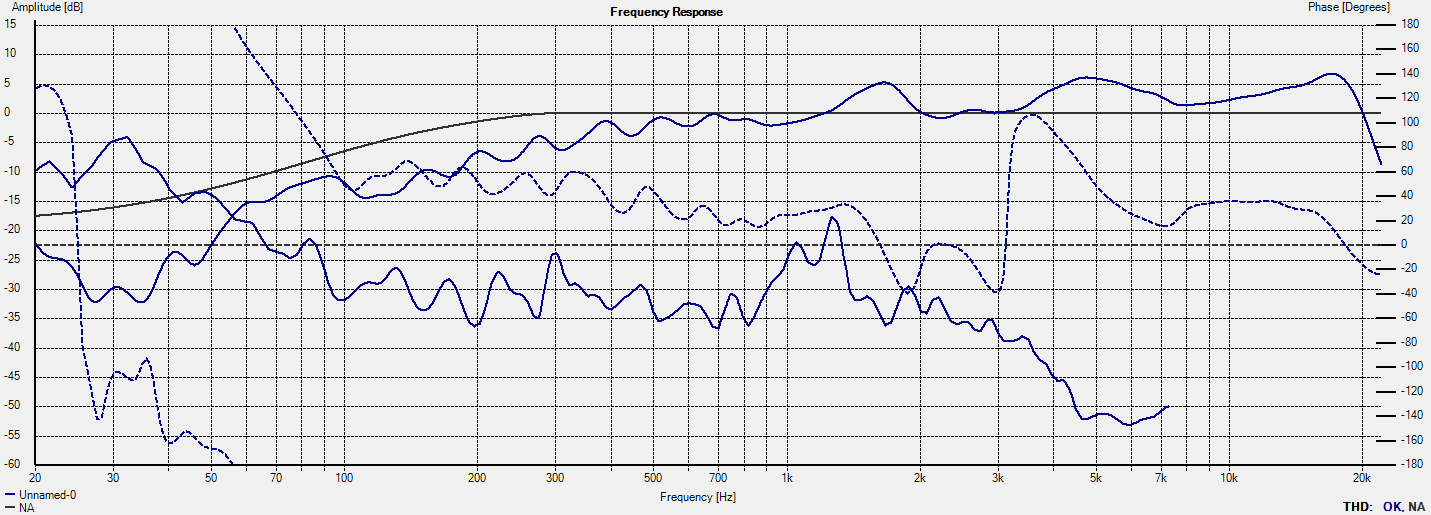

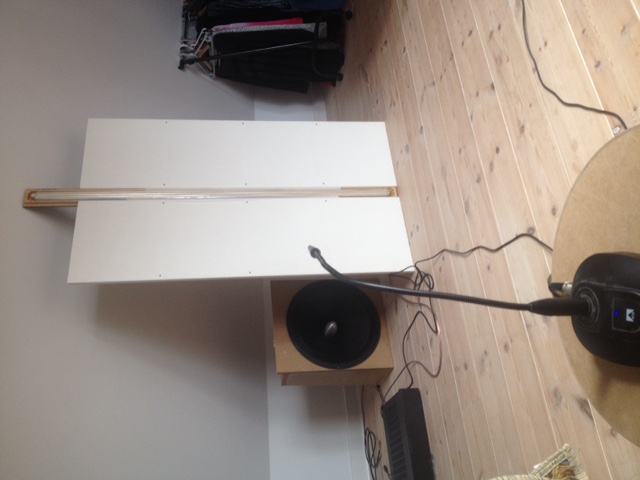

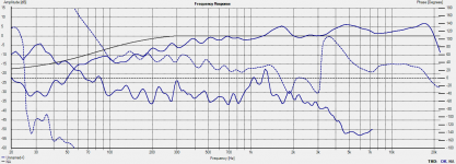

Made one with little flatter W. Measuret 1 meter with no baffel.

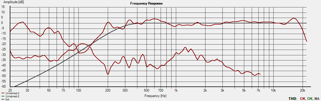

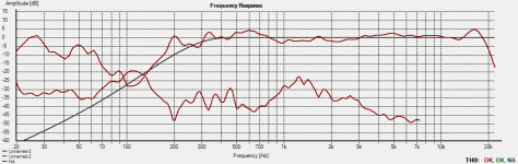

Maybe like this
  • Sharp01@vestfor.dk_20160323_165206.pdf
i used it as this
N\/\/\/\/\/\/N
S...............S
Ofcourse my current did not go one direction but every pleat/fold it switched from down to up
i used 4 x 40x20x5 mm magnets, not the biggest :)
your design is
N|S/\/\/\N|S like a normal ribbon
this first one has side ways movement. i did measure all failures be it not well documented. but the amt was by far the most efficient. (be it verry low resistance, but the others had that to :))

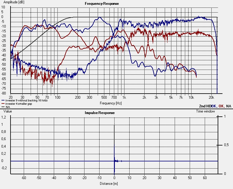

Here's a measurement. with a 16 folds membrane. but thats it the limit for the 30 mm gap, or have to find some reinforcement without Upping the resonance freq.
BLUE AMT STYLE
RED W style in normal ribbon magnet structure.
both measured at same distance around 25 cm, and resistance is almost the same. 2 Ohms so very low but good enough for testing. both there distortion is a tad to high for my taste but i think there is a margin to gain lower distortion. for instance my magnets also influence the pieces where the tracks go sideways, this will result in upward movement. not something you want :) but since this one is so small 2 cm of the total 10 cm high has these sideways tracks. so have to make a bigger membranous and dont drive it the full length. (at least thats my theory)
and i have some hearable resonances left, witch i should be hunting down so i know what to do with it next time
i am very pleased the thing extends to 20khz. something i was afraid of with the deep folds
