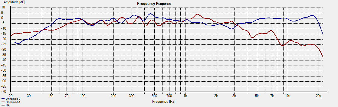

Measurement of A&E dipole 18 (red) and the Planar (blue) 1 meter and same condicions.
Will work one a crossover with minidsp this weekend
Yes hopefolly 24db 250hz.And a 5-10db boost in the low end. A&E claims 93db 1 watt :).

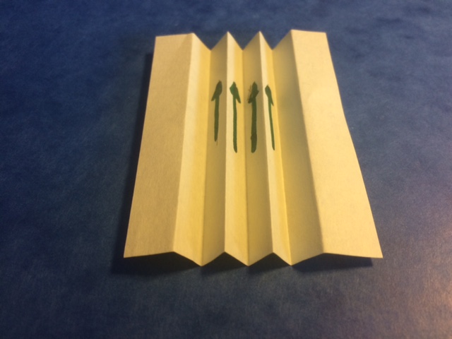

I'm thinking whether it would make sense to only run the alu on the two mid folds leaving out the outmost, or make a fold more to act as the "suspension"?
I'm thinking that the outermost folds are very restricted in movement as one side is attached to the magnet.
Intuitively I would think it would make the movement of the "coil" more linear, and thereby decreasing THD ..... but on the other hand you would have two sides moving but not directly driven by the coil.
.... guess it should be easy to test, just disconnecting the two outermost tracks, measure and compare THD .....
I think it is a briliant concept ans it allows for large movement and it seales the sides, thereby both hlping for very low freq response. Cool :)
On the other hand I think the folds here will have a slightly more complex movement pattern (not just back and forth) because of the folds hinging together and making some sideways and twisting motions too. This compared to a normal ribbon, moving very much only back and forth, or for AMT where the motion is highly "sideways, because of their more flexible hinges taking "making up" for the movements.
How do you handle 4mu alu?? Cutting and gluing? .... and where do you get such thin material? (are both paper and alu from a large paper capacitor?

I made a planar like that some 10 years ago. I just didnt realize just how good they were :).You could place the first fold with out conductor closer to the center of the magnet. So you don´t lose sensivity.
4 my alu, use water and glass :).I got it from a now closed capacitor factory sorry. Use ordinary alu from Irma (danish shop :-( ). and eks toiletpaper no joke.
