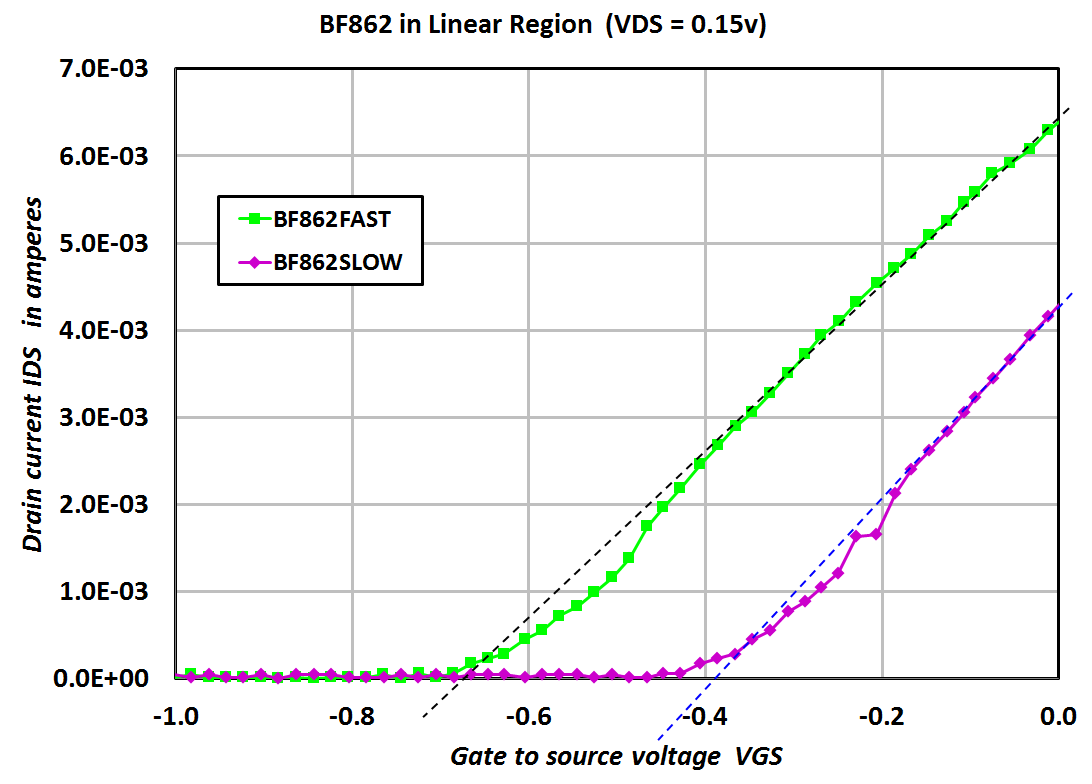

FWIW, to determine the pinch voltage, the usual recommended lab procedure is to measure Id vs. Vgs at a very small Vds (so in the jfet linear region), determine the linear region of the Id-Vgs curve (so make sure the subthreshold part is avoided, also avoiding high current effects, which are usually saturating the drain current at high Vgs) then extrapolate this linear region to Id=0.
From post #10
568344d1473183317-ltspice-models-worst-case-bf862-jfets-linear_region_find_rsource.png
fast: -0.672V
slow: -0.389V
does this have to be corrected for the 38mV mismatch?

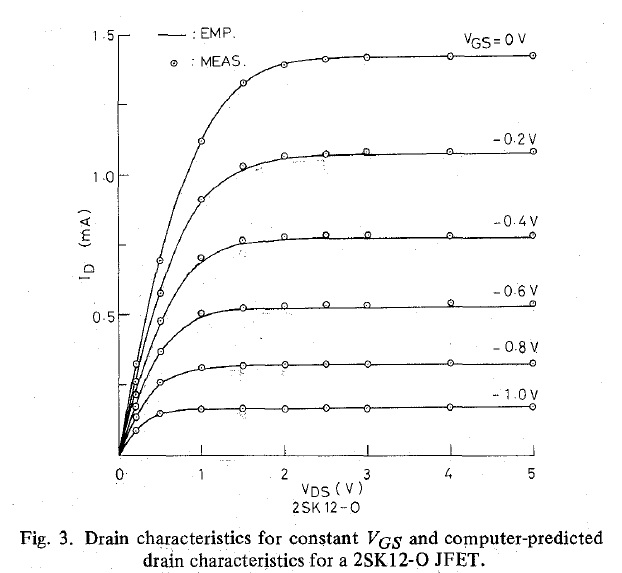

I tried the Sansen & Das JFET model just now; it was reference [10] of the Wong paper that Scott posted. I couldn't get it to fit very well at all; it was much worse than the Taki (hyperbolic tangent) model fit shown in post #48. Taki model was equation (1) of the Wong paper.
Wong cautions that the parameter "K" in Sansen/Das's model is "crucial to the smoothness in the transition region" and maybe I'm not fitting it properly. But after several dozen restarts from different initial points, I haven't gotten S/D results that are anywhere near as good as Taki. Go figure.
This is a tough problem, I admire your energy. I could send you Taki's original paper, his examples are the Toshiba JFET's close to everyone's heart and his curves fit very well.

Thanks, Scott. I've already got Taki's paper in pdf format. It's on those JSSC DVDs that Tim Tredwell of Kodak made for the SSCS around 2005. Gotta say they are sometimes a lot more handy than logging into IEEE Xplore Digital Library. Sansen and Das's paper is on the same set of discs. On the other hand, the Wong paper that you uploaded, was from Trans.E.D. which is not on the discs. Thanks again for that.

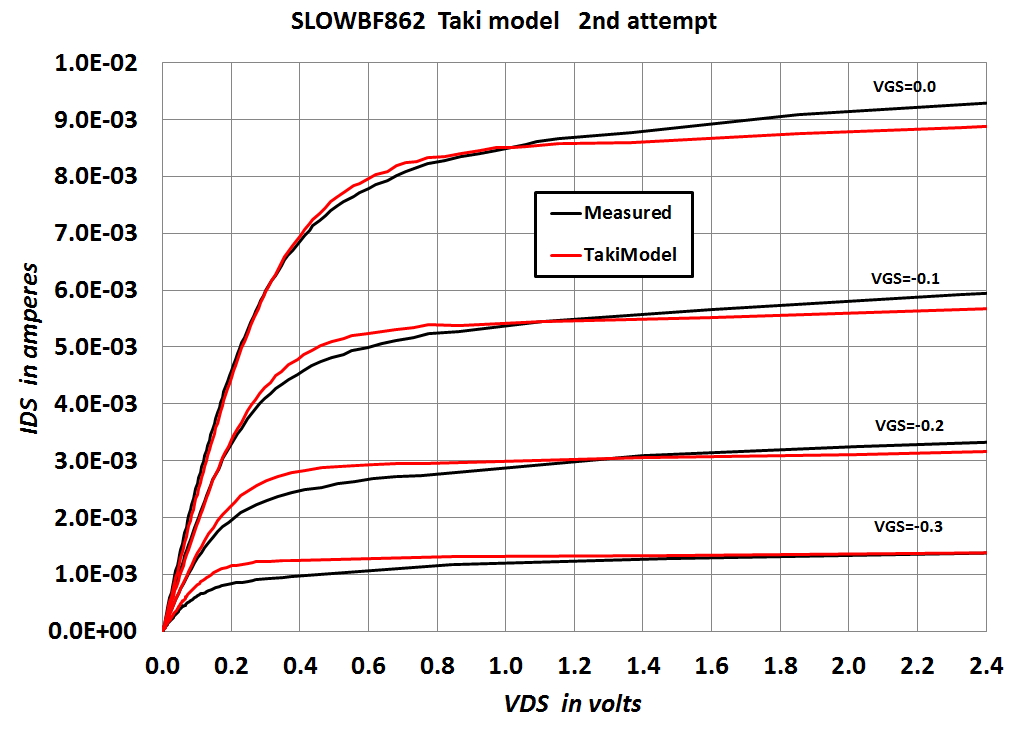

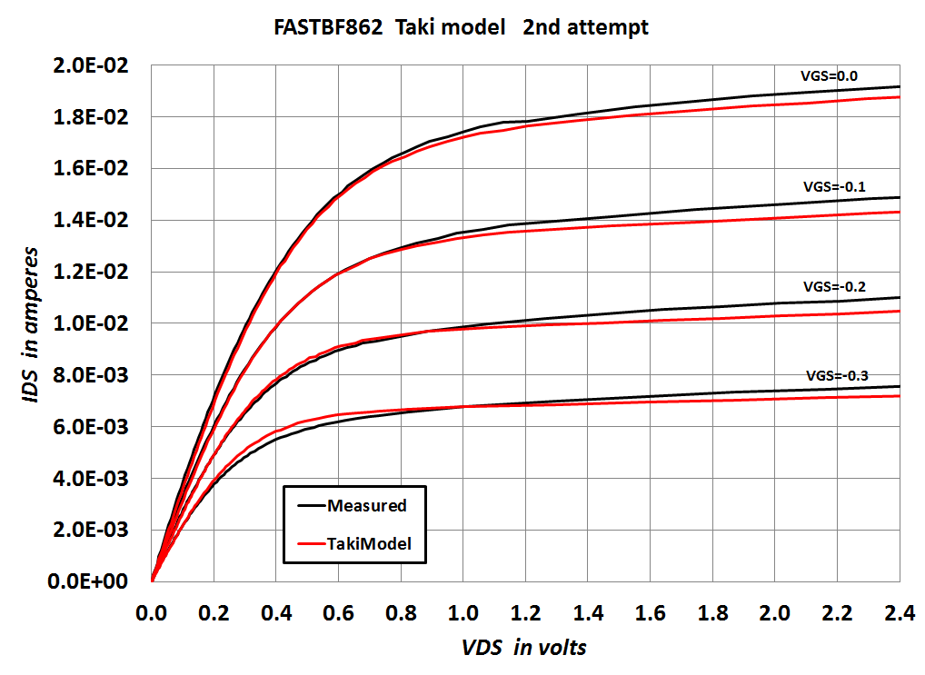

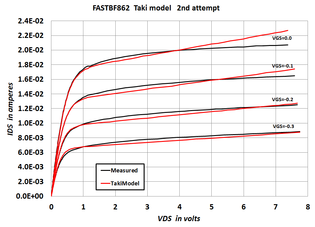

Taki revision 2
I had another go with the Taki model, to see what happens when I place more emphasis on tightly fitting the linear region (low VDS). Even though the Taki model is not yet available in LTSPICE. I also found a way to cancel the 38mV offset in the curve tracer's VGS; thus the plot labels are even multiples of 100 millivolts.
The JFET's linear region can be fitted rather well (Figs 1 and 2), but this leads to larger mismatches in the saturation region (Figs 3 and 4). The bumps and wiggles are artifacts of the low cost curve tracer, not of the model equations.
I think that's about all I've got on this one. Never did succeed getting the Sansen and Das equations to fit.
