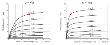

I bought qty=50 of the -7 suffix units, but haven't tested them. If real-life, real-world parts resemble the I-V curves in the datasheet, which they might or might not, then 2SK3557 offers a possibility of operating nicely at lower VDS.
I put a red dot on the I-V curves from the 2SK3557 datasheet, showing where I might one day dare to operate the transistor in a circuit design: at VDS>=1.2 volts. The datasheet curves presumably display a "typical" unit. Perhaps if we somehow obtained an I-V curve of a plus-three-sigma "FAST" unit from the population of -7 suffix parts, its red dot might lie at, oh let's make a guess, VDS=1.7 volts.

Doesn't make much sense. Saturation onset is at Vds=|Vgs-Vp| and twice this value ensures a good saturation operating point. For devices working around Idss (Vgs=0) this is at 2 pinch voltages, that is not more than 2V (worst case). I've used BF862 at Vds=2.5V without any problem (noise or linearity wise).
Low noise jfets should be run at the lowest possible Vds, since otherwise there's a good chance to degrade the noise performance by hot carrier injection (from the reverse biased gate-drain junction) in the gate.
4V is probably not to bad for the BF862 anyway, but other devices like the 2SK3557 (Vdsmax=15V) are not that happy (noise wise) at Vds=4V, I can tell you that. Also in your post #18, it appears the "fast" DUT you are using as an example has a measured Vp well in excess of 1.2V (around 1.6-1.8V eyes only estimate) which is highly unusual and definitely outside the data sheet (Vp=1.2V max). Strange enough, since high Vp always leads to a lower transconductance (for a fixed device geometry, and barring any short channel effects).

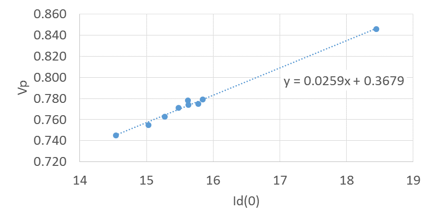

More real life experiences, thanks.
Did you determine the Vp values Borbely-style and what were these?
In my batch I find -845mV for the Id(0)= 18.5mA one and -745mV for the device I measured at Id(0) = 14.5mA. Both Vp values taken with a DVM that has 1MOhm input resistance. Id I "measured" at 0.8uA.
I get higher values with a 10MOhm DVM, but these are dependent on how I look at the DUT, so I put them to one side.

You probably all know this, but I see it the first time and I like how it looks :)
Id(0) - shown in mA - measured with +10V, a Drain resistor of 100 Ohms and Gate tied to ground. Vds thus varies with Id.
Vp - shown in V - is measured Borbely-style with 10V and a 1MOhm DVM btn Gate and Source.

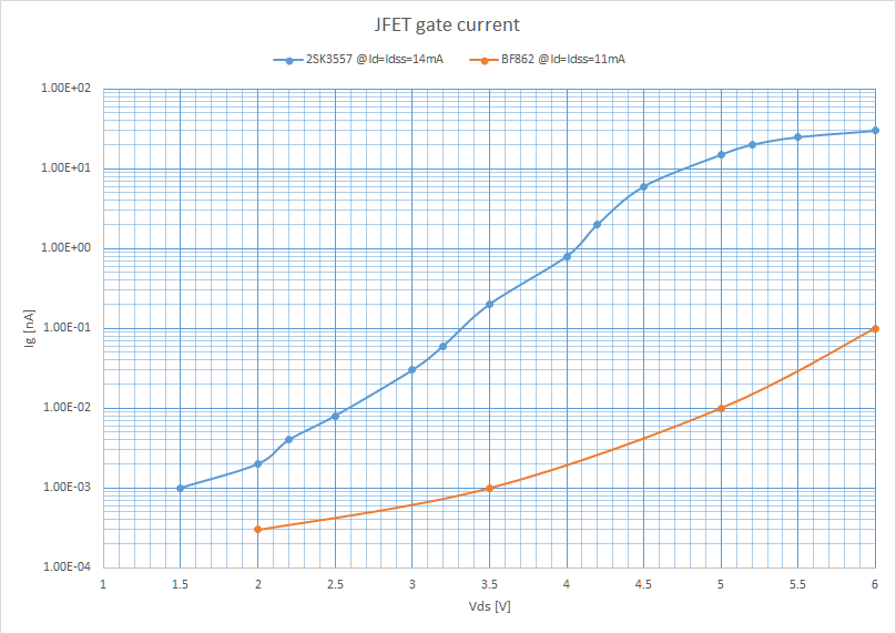

As I said, not me doing the skunk work, but I will ask and be back ASAP.
With permission from a former member here, the jfets gate current vs. drain-source voltage, at Id=Idss, measured with a Keithley 616 electrometer. The BF862 data points are, more or less, matching the data sheet.
Please recall that the gate noise current contribution per rtHz is SQRT(2*q*Ig). Also, as usual, paralleling devices increases the gate noise contribution by SQRT(N).
As you can see, the 2SK3557 gate current @Vds=4V is over two order of magnitude larger than the BF862.
My further comment:
- At Vds=4V, Inoise~18fA/rtHz.
- It takes a source resistance of about 20kohm or higher to have the gate current noise contribution relevant to the total noise budget (considering the channel voltage noise contribution 1nV/rtHz).
- 20kohm is a rather high source impedance in audio, but for a MM cartridge preamplifier it could matter, anyway BF862 could do much better.
- The 2SK3557 gate current contribution to the overall noise would be really critical for an electrostatic microphone preamplifier.
