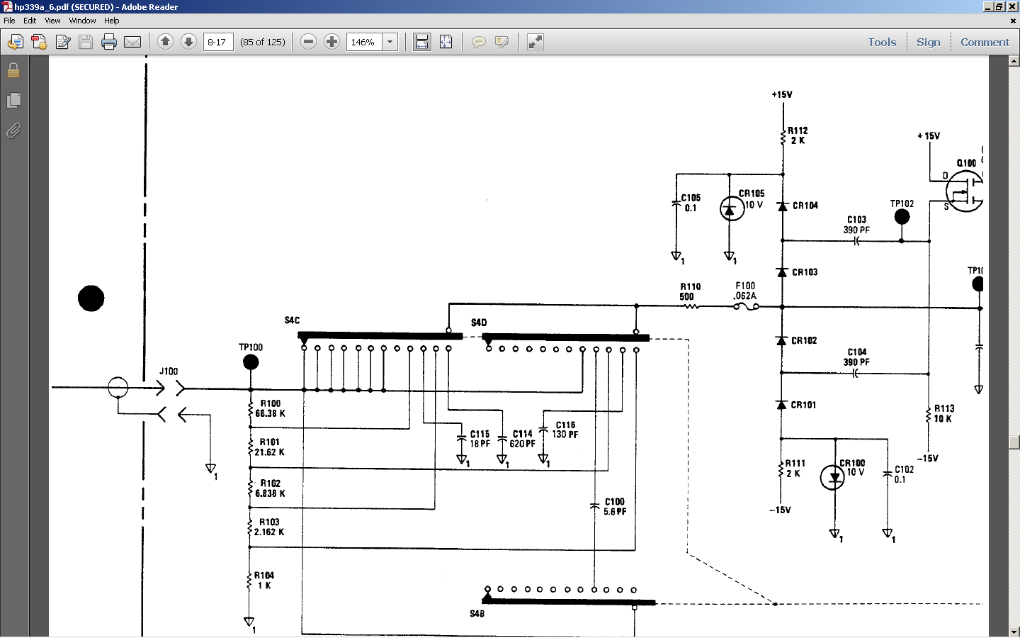

Do we really need an input impedance of 100K? The input attenuator does not keep a constant load on the input amplifier's input. The overload protection diodes are suspicious. The dual gate fet is a big question mark. If we add gain at the input amplifier we improve the SNR at the cost of 3 times the distortion. But again I don't trust the QA400 at higher signal levels.
I'm still wondering about the huge amount of second harmonic on the TP for the dual gate fet in the input protection. It's coupled through some 390pF or thee about.
As we are measuring outputs that can drive <600-2K Ohms or at least 10K, we dont need to use 100K (noisy) Z and other R's can be scaled down as well with the new opamps in place.
The dual-gate mosfet is for protection (CMode?). Shouldnt do much unless overloaded.
Protection of what? It's coupled to the center of the bias string clamp through 390pF caps.
There is a lot of 2nd H on TP101.
HF/RFI Common-Mode. Take it out. shouldnt matter much re protection. See what H2 does after that. -RNM
I did take it out. It didn't do much so I put it back in. This is the first answer I've got for asking this question.

No, I think a better statement is that the FET wants to stay in the triode region well away from Vp. What you want is very high Vp which happens in general to go with long channels. The down side is that high Vp low Idss FET's are higher resistance and it's harder to make them be just a small portion of the feedback mechanism. The linearization tries to keep the FET looking like a resistor centered on the origin rather than off to one side, hence the trim tweaks the seconds. This trick is very old BTW well known when I started in 1973.
