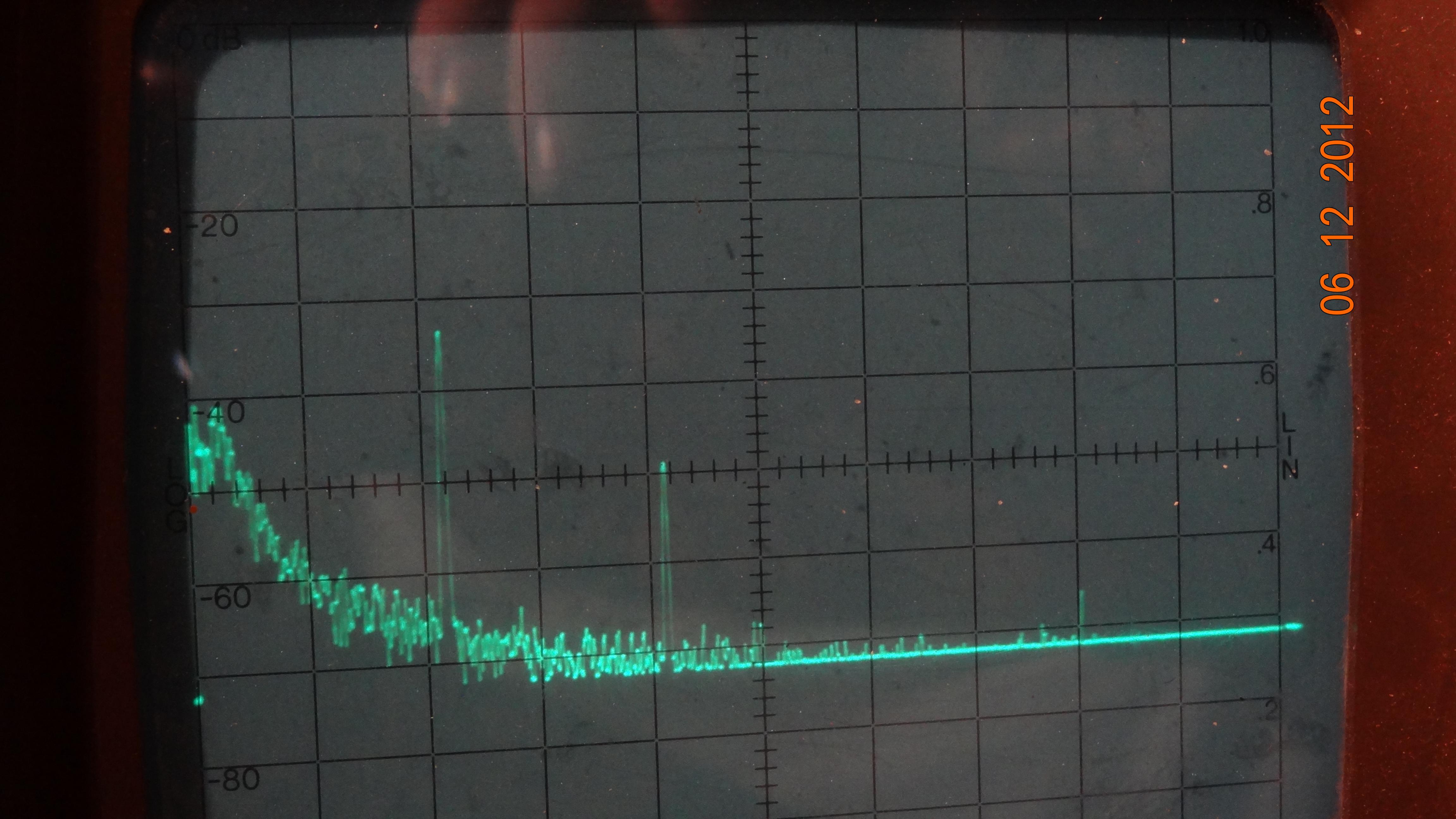

My point is that, looking at the monitor output with a spectrum analyzer, switching in the stock 80kHz filter raises the noise floor significantly over leaving it out, which should be the higher noise case. The effect is less pronounced with the 30kHz filter, thanks primarily to the much more restricted bandwidth, just as Sam points out.
Yes, getting rid of the noise that's running around post-notch is needed; but a filter that increases noise instead of reducing it, isn't really that helpful if you want some filtering before the ADC. You're right David, we have to reduce the broadband noise somehow, regardless of whether we want to read a meter or drive other gear.

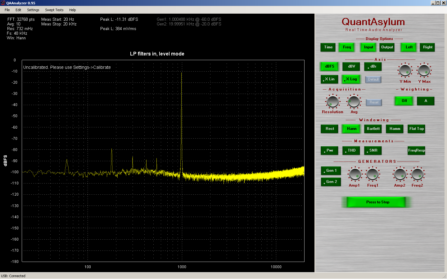

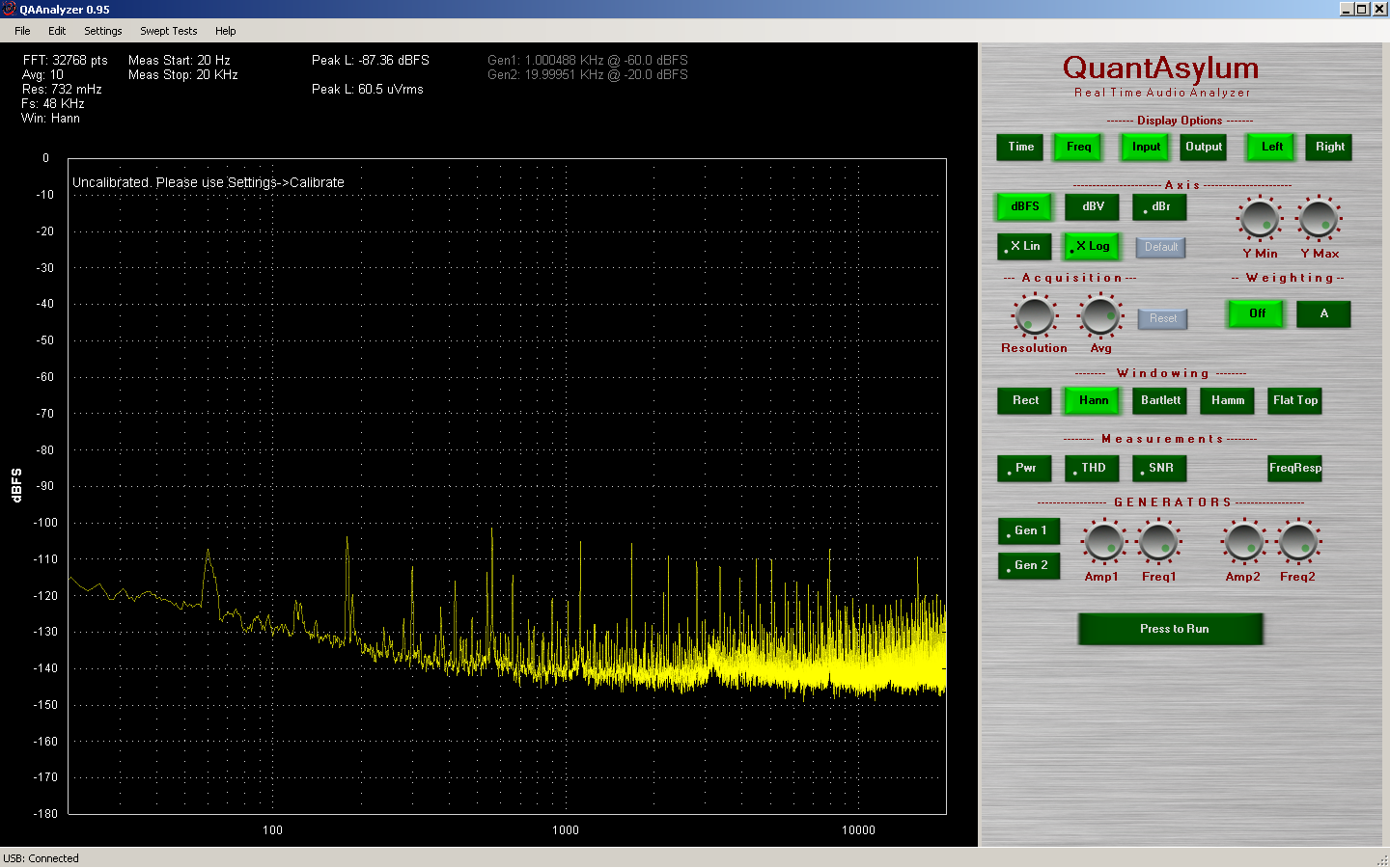

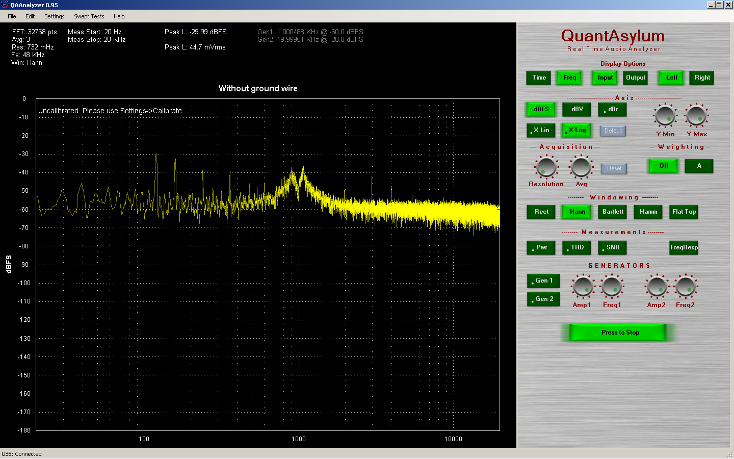

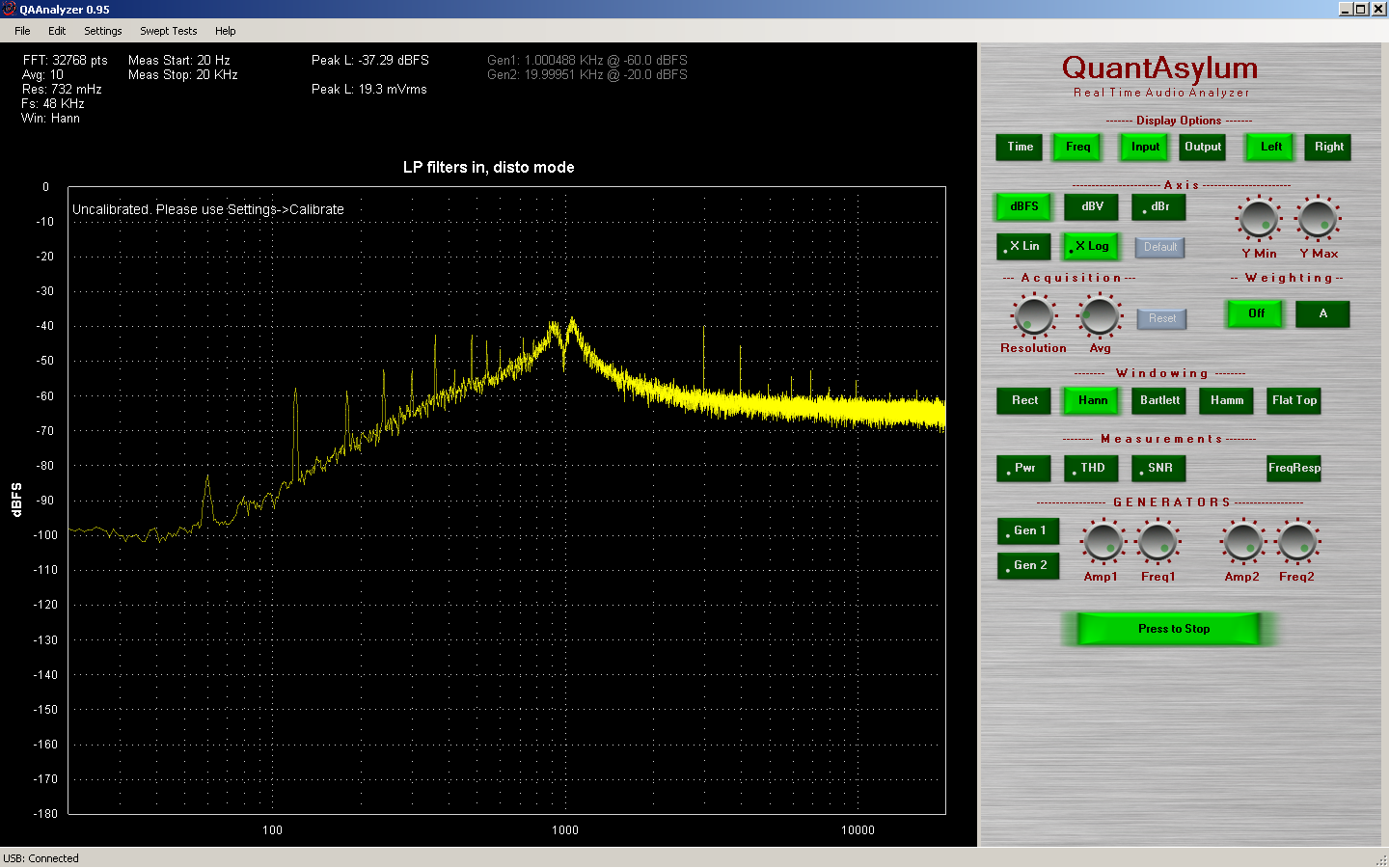

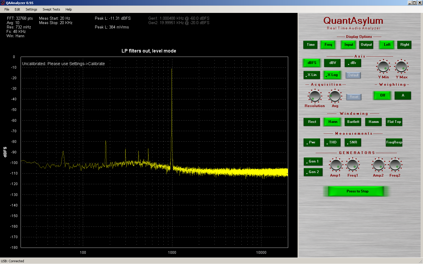

339a grounding
With just the QA400 connected to the 339a notch amp output.
The spectra looks like this.
And with just the ground to my scope connected tot he ground post of the 339a monitor output the spectra looks like this.
I would suspect something wrong with the scope but I get RF parasitic oscillation just connecting the ground of my HP3581C to the ground post of the monitor output.
Maybe Rick's filter amp swap-out will tell us something, as I think he's chosen the right amp for the filters... Can't remember David, which quad you used.
That op amp is deep. Wouldn't you know it, can't find a working flashlight around the house.
I think it was a quad low noise jfet type.

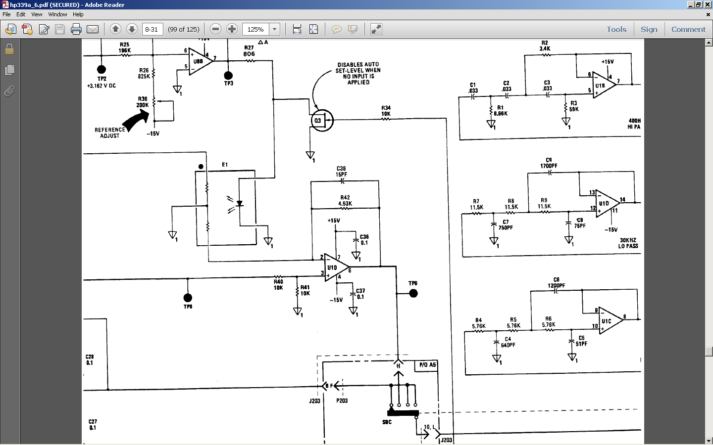

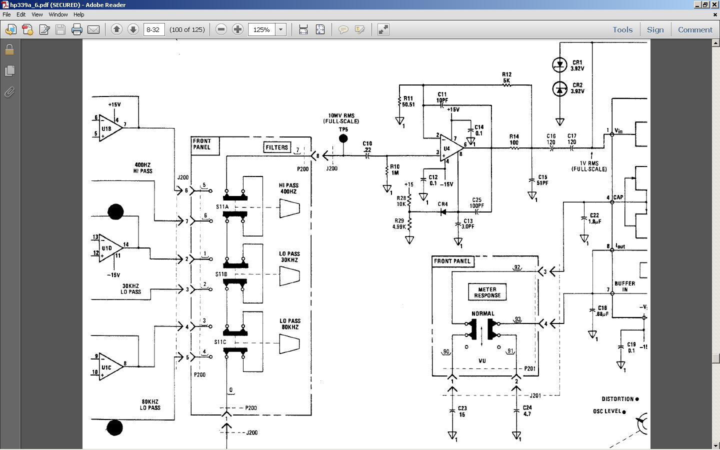

I think what we need to do is isolate each stage and look at them individually. With such a long chain it's hard to tell just exactly where the noise originates. Speculating is good but it not getting us anywhere. We might find everything is where it should be and the problem is fundamental to the design. I do know that there is large amount of high frequency noise viewed on my scope off the monitor output which significantly drops when either of the LP filters are switched in.
If we look at the schematic, we can see the post amplifier after the filters is the one that has a gain 100. This means that the filters noise is being amplifier by that amount. One could reason that there would be better SNR if the filters came after the x100 amp. There is a trade off here. With higher level we would see higher distortion from the filters and that would be added to the measurement. Instead HP went for the higher noise. It does satisfy there base line with the filter in.
We can test this by rearranging the filters and post amplifier. Make the x100 a preamplifier to the filters and see what happens.

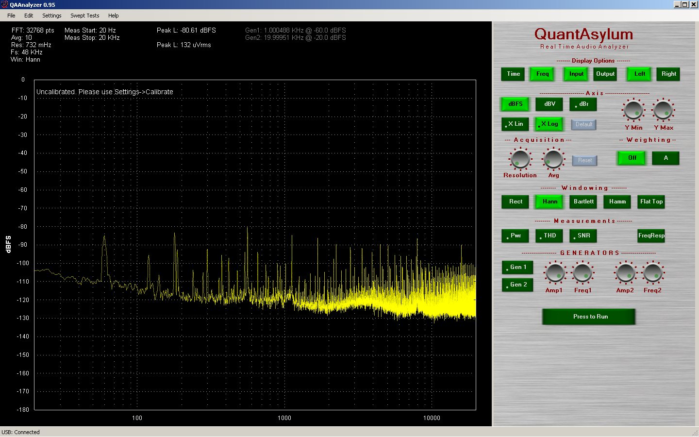

But the bulk of the noise isn't coming from the filters it's from the analyzer it self. There is a huge difference in noise level between level mode and analyzer mode but both have the same scale.

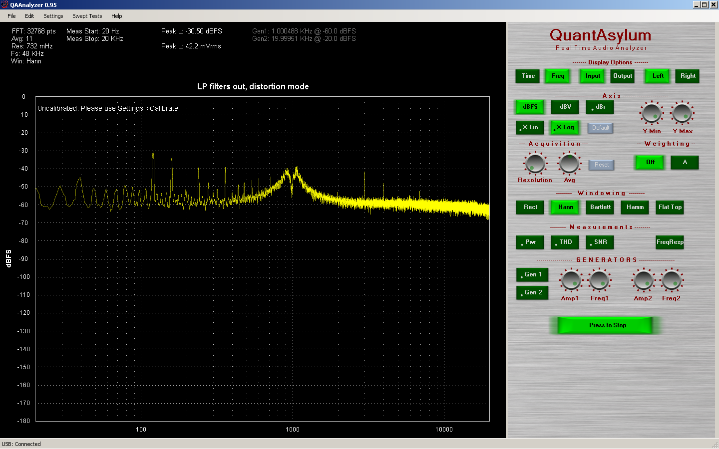

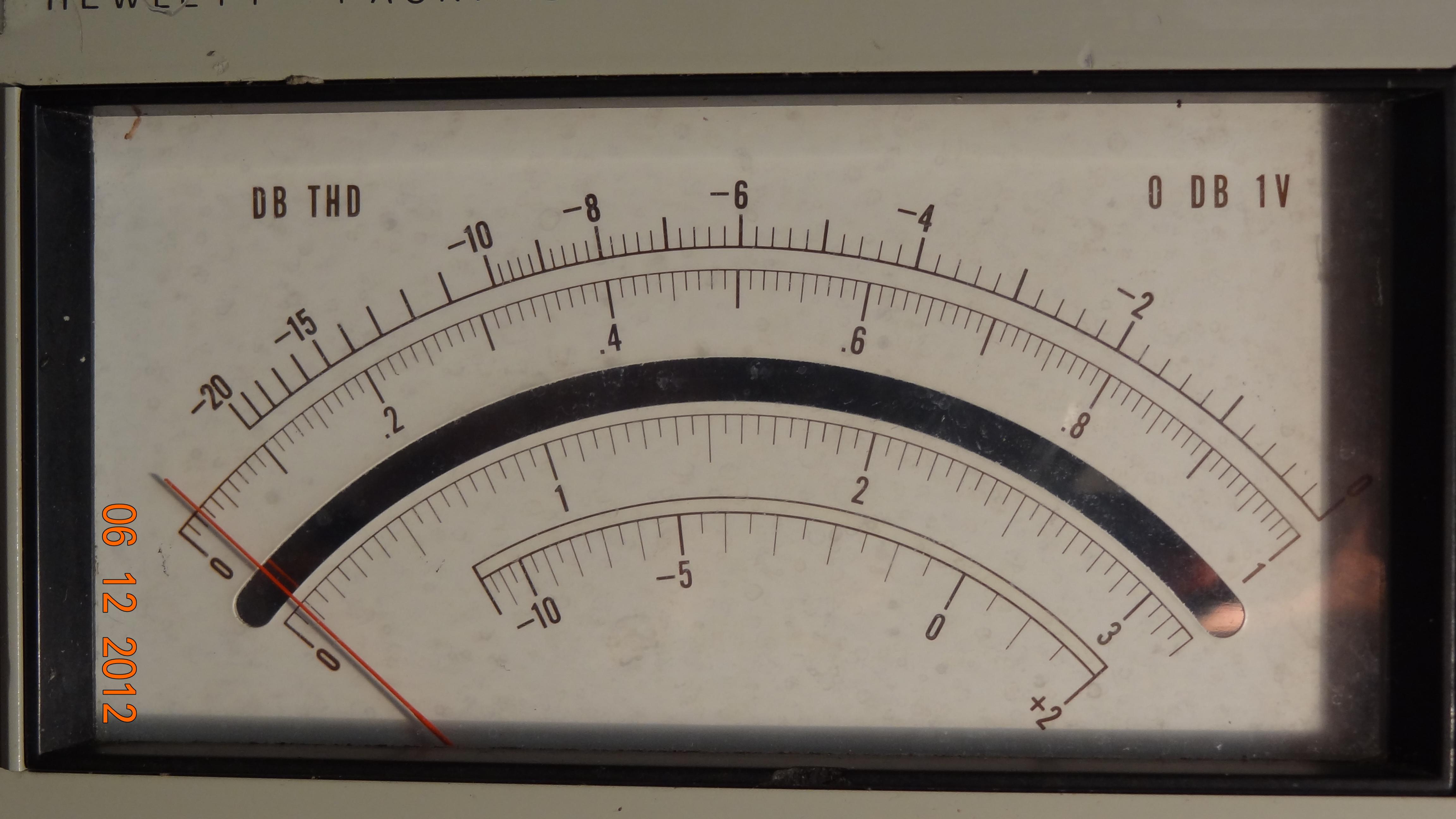

I just notice something. I have the 339a with just the oscillator connected to the analyzer.
The meter is reading near 0.004% with the LP filter off. The range is -80dB with 1Vrms at the notch filter input, what I've been using with all my measurements. With nothing changed from the above, when I connect the QA400 to the monitor output the meter pins at over full scale. Even with just the QA400 ground connected, the meter pins. With the LP filters switch in the meter goes to a reading of 0.0015%.
So what does everyone make of this. I say there is something very wrong with the grounding in this 339a

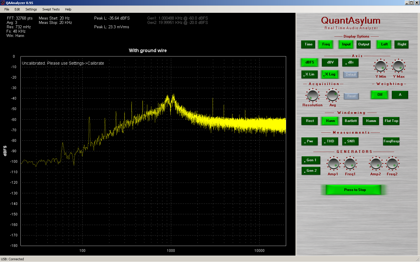

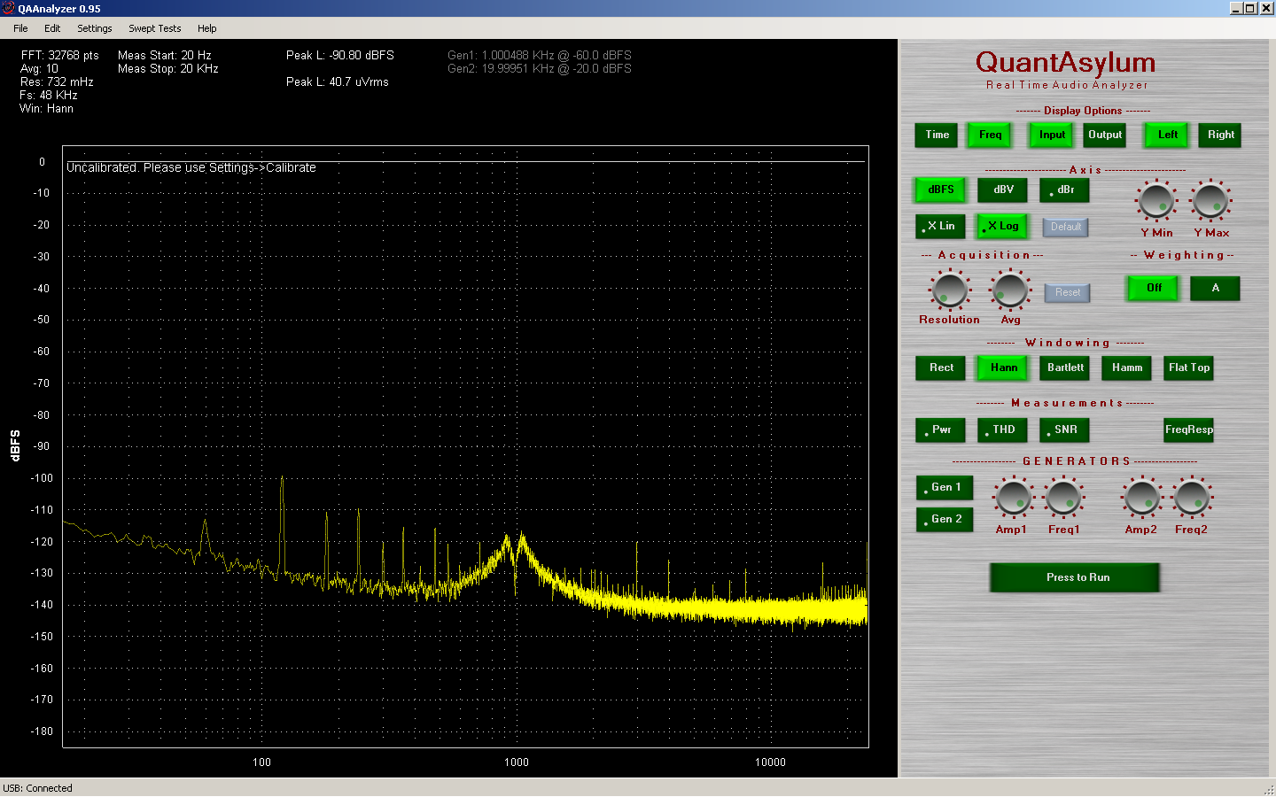

Grounding problem
It seems I have misinterpreted the problem.
As it turns out this is a low frequency problem. The ground selector switch is not doing
a very good job of grounding the in chassis to the outer earth grounded chassis.
This can also trigger RF parasitic oscillation.
Look at the difference when I ground the inner chassis to the outer chassis with a small piece of wire.
The meter reading dropped 1.5 orders of magnitude with the LP filter out.
Seems more normal now at 0.004% reading LP filters out.
With the 80KHz filter in it reads 0.0018% and the 30KHZ the usual 0.0014%.
I can't get to the ground switch because all the set screws for all the knobs are frozen.
Nothing quite like a earth ground loop.
Cheers
