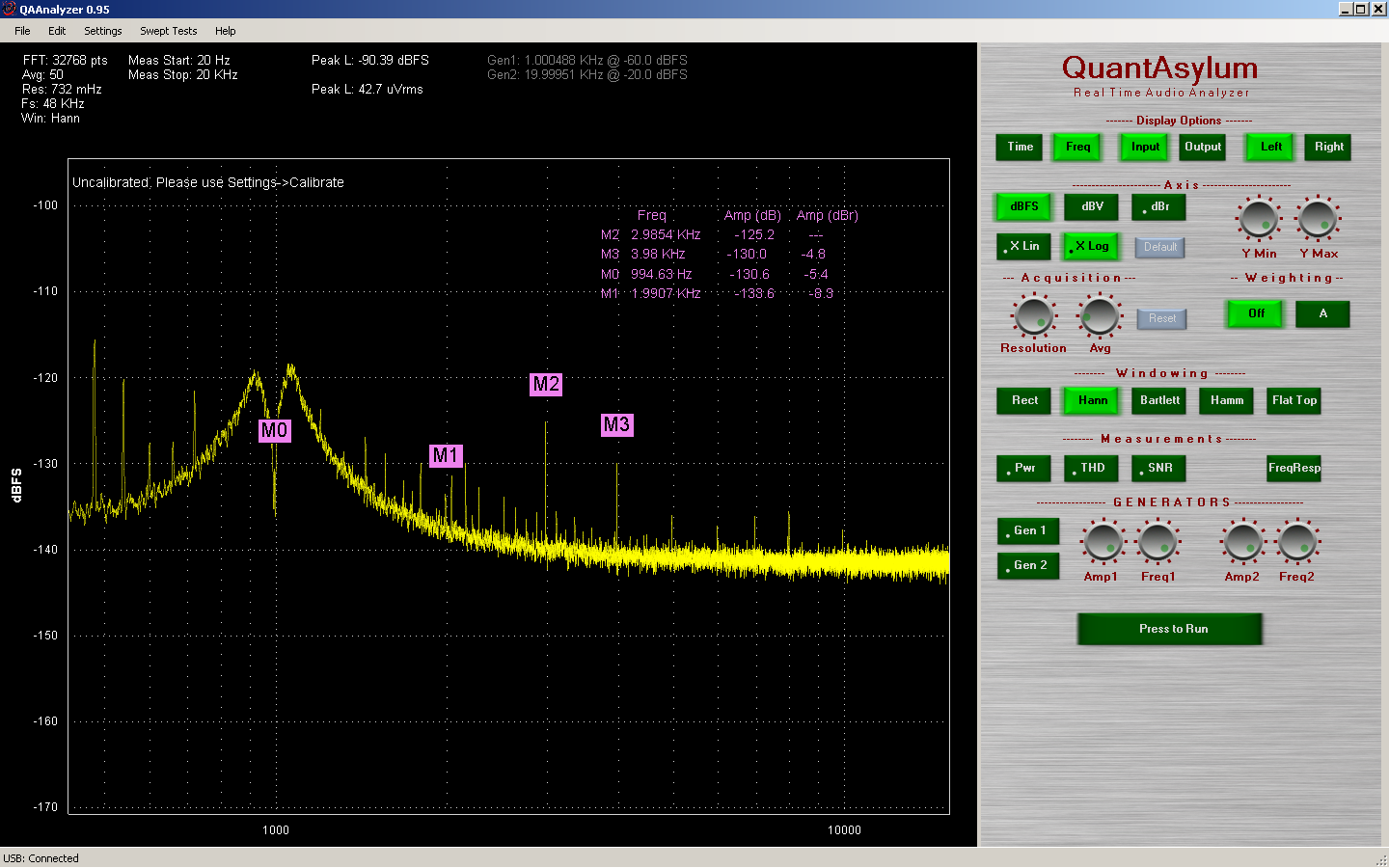

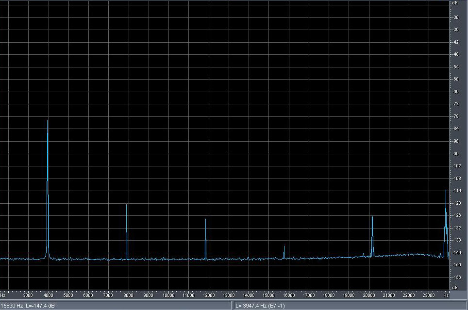

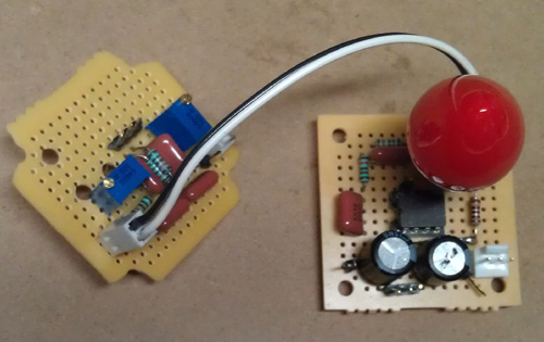

Cleaned up my supply and added trims on the notch (>70dB). First the AD797 and second the AD844 just in case you thought a CFA would not work here. I suspect the thirds are down to the lightbulb's residual. This is a great find for anyone that simply want's to spot check a design, 30dB better than the 327 lamp oscillators that I built 20 yr. ago. There are two spurs left from my display drivers (easily ignored). It does take 10 or more seconds to settle, this goes hand in hand with the distortion. The correction is add 10dB to seconds and 5dB to thirds.

Have a close look at where the 2nd H is now. This is at the expense of higher frequency performance. The distortion at it's best at 1KHz and 1Vrms into the notch filter.
I forgot to mention, in the list of what's been done, I put a 50k trim across A3R48 and trimmed the total R to 10k. This forces the LDR to operate at a lower resistance much the same as putting a trim in series with the LDR. It has the same effect.

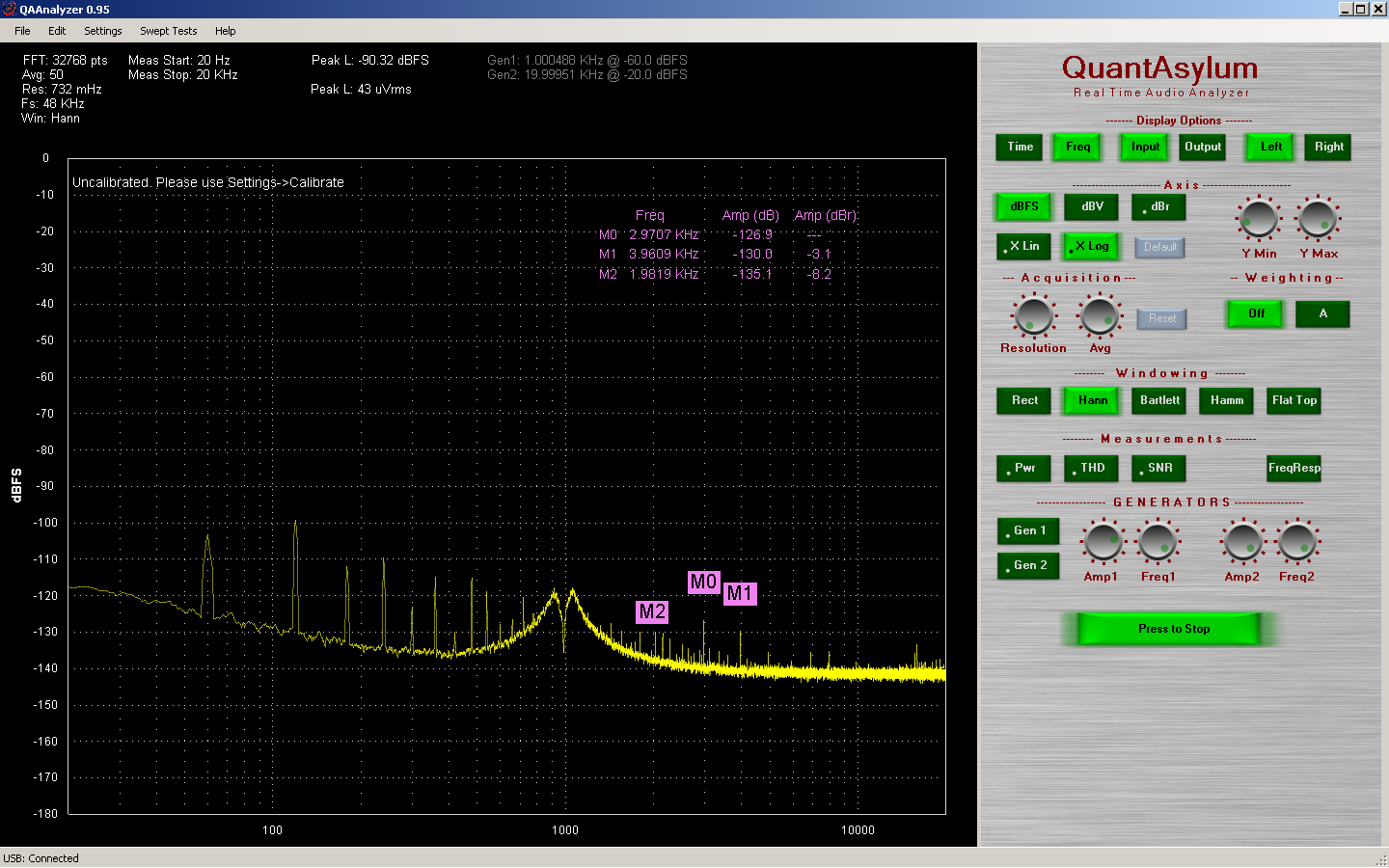

New stuff.
I removed capacitor A1C46. Cut the trace at right at the pin5 of A1U1 and added a 33 ohm
cheapo $0.06 carbon composite resistor in series with pin 6 and the output trace.
Tweaked the Jfet distortion trim and this.
I'll see if I can fix the high frequency performance with out losing the 1KHz.

Rick, I think David meant pin 6, to add a small isolating resistance between the output of the amp and the load of the rest of the circuitry. This has worked well for me a couple of times -- I used 47 ohms recently on the output of an LT1468. But I haven't done anything to my 339 as yet -- still have a few other fish to fry first.

Hi Dick,
Yes I meant pin 6. Sorry. I worked late into the evening got tired.
It is the isolation resistor.
