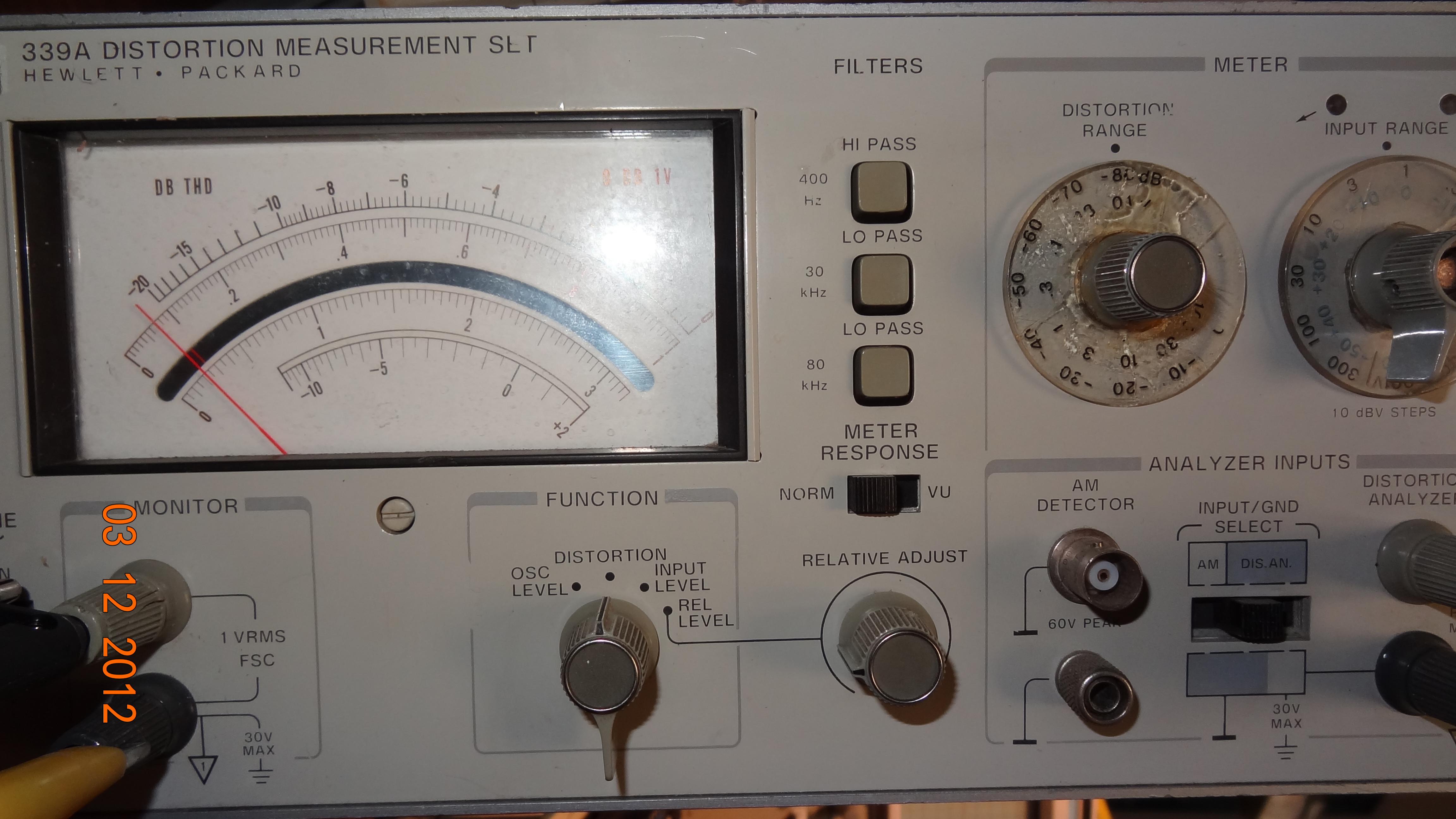

So far the complete HP339A system -- reading its own oscillator at almost stock (osc + analyzer distortion) - with just a tune up and changing the two null trimmers (using a 3580A spect analyzer on the output monitor port of the 339A) -- gives a noise floor of -145. The H2 is -105 and the H3 -130. Its a good beginnng and its getting better! :) Thx-RNMarsh

"gives a noise floor of -145" This would have to be a calculated noise floor measuring on the monitor output. With the gains in the 339a a noise floor of -145 is not possible with direct reading. If so something is wrong.
Each 339a has it own characteristics it seems. Some are in better shape than others.
Yous sounds like it is great shape.
My aim here is to do these mods with as little impact on the original as possible.
However I might break the rule a bit with the input upgrades to new op amps that don't require the compensation components. What ever I do though is completely reversible.
I don't like to hack. But the coupling between the input buffer and notch filter is directly connected I think. For this to work 10dB attenuation needs to be added.

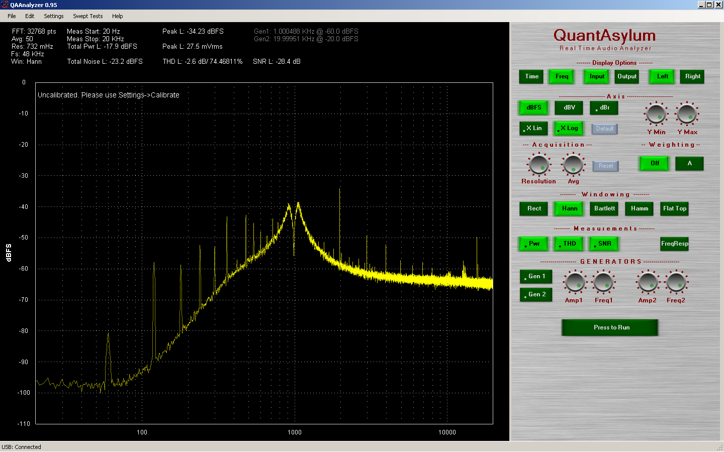

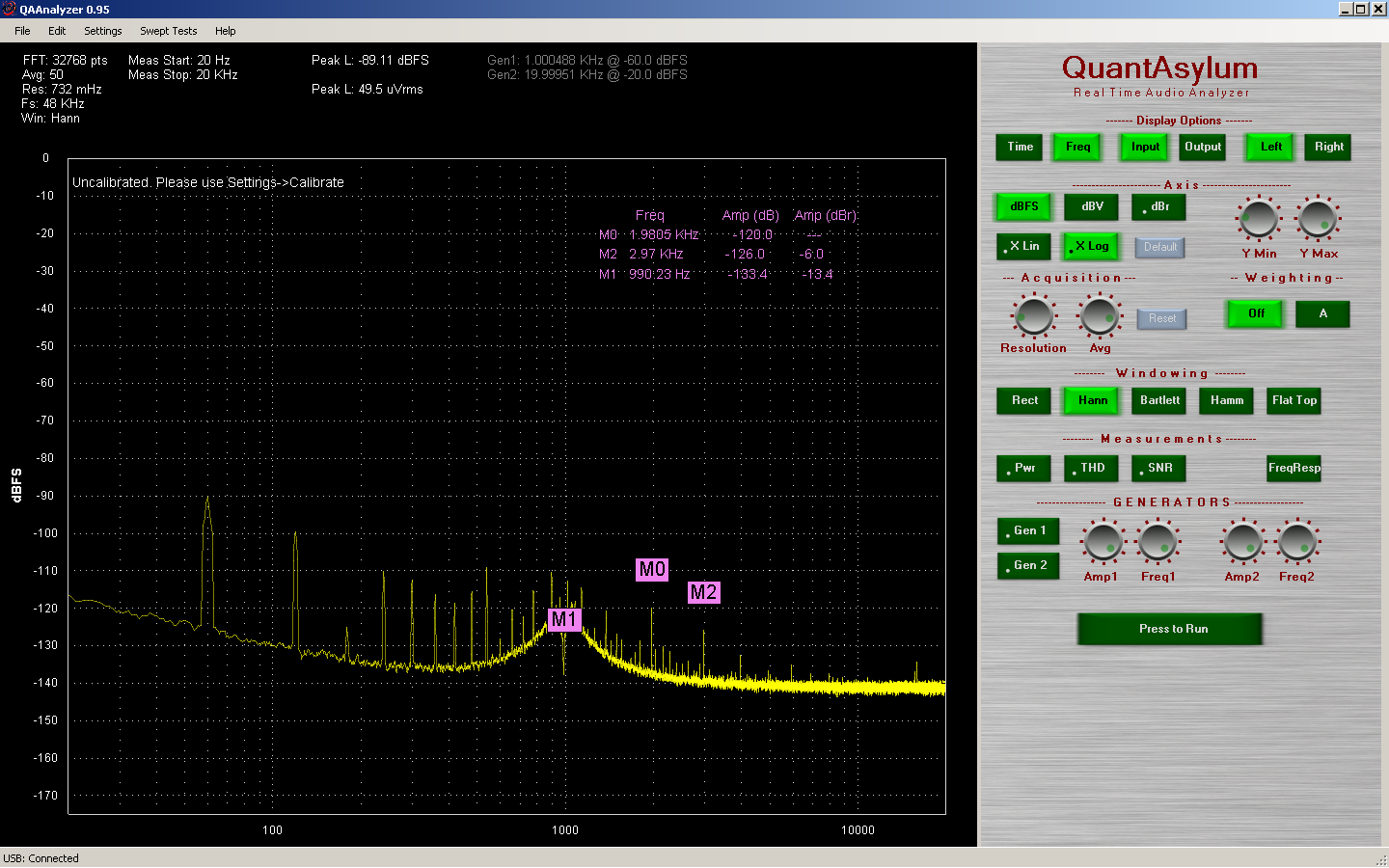

339a with input circuit connected
This is with the input amp and buffer amp reconnected.
I increased the input attenuation by 10dB to match what I had before into the notch filter.
What the notch filter is seeing is 1Vrms @ 1KHz same as before.
The Analyzer is reading about 0.0015% THD+N with all the filter in.
With the filter out it reads .08% and with only the 400Hz out it reads .0018%.
Evidently I have a big noise problems with this 339a. The wide band RMS meter measures the entire band width of distortion and noise to-3dB but continues to measure far out beyond this and if there is peaking or parasitic oscillation going on some where.....
I have noted parasitic oscillation in the lower sensitivity range setting with certain ground connections. I can't use my HP2581C connected to the monitor out without a low level rf parasitic. It doesn't take much to set the 339a analyzer off this way. There is a reason why HP put wide band rf series chokes on just about all the inputs and outputs. I've had problems with these chokes causing small resonance and triggering rf parasitic oscillation in another oscillator connected to the analyzer input. These are things to watch out for and can artificially raise a distortion measurement or level for that matter. I spent two days trying to trace an oscillation that turned out to be a grounding problem. Won't get followed again.
This looks pretty good. You can see a slight rise in distortion. I don't know if this is enough to justify further input circuit mods other than changing the scale. I'll leave that up to the individual but I may try it for myself.

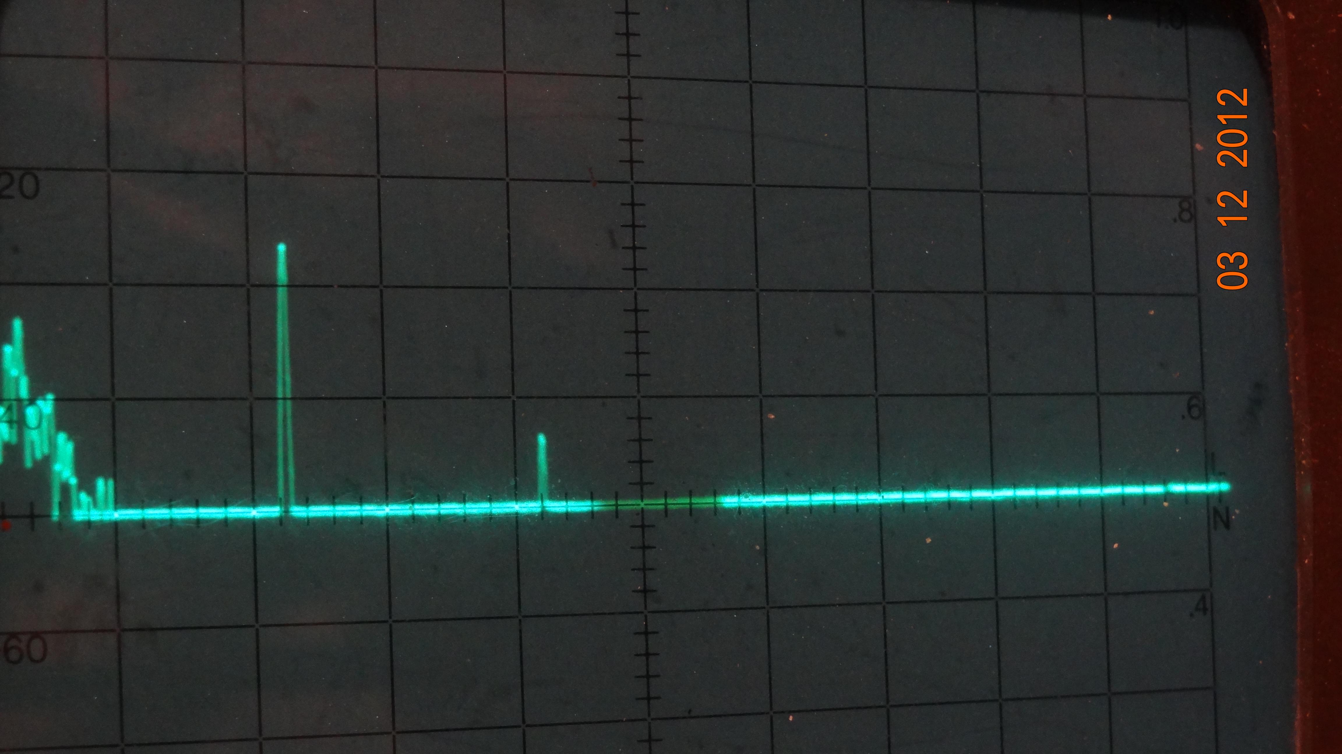

My numbers are also with all filters In. Its pretty useless with the filters out.... just measuring noise. And, I did take care to configure my external grounds/coax to eliminate ground induced hum components to a min.... floated the external scope and analyzer from ac ground and the like.
The noise floor (-145) and harmonic levels are from the FFT analyzer looking at the monitor output.... not a direct measure from the monitor output with a wideband rms voltmeter.

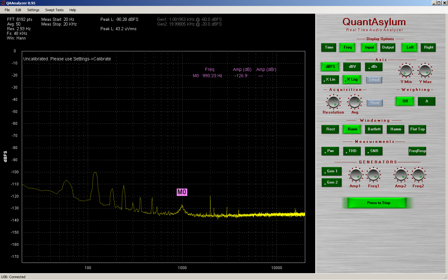

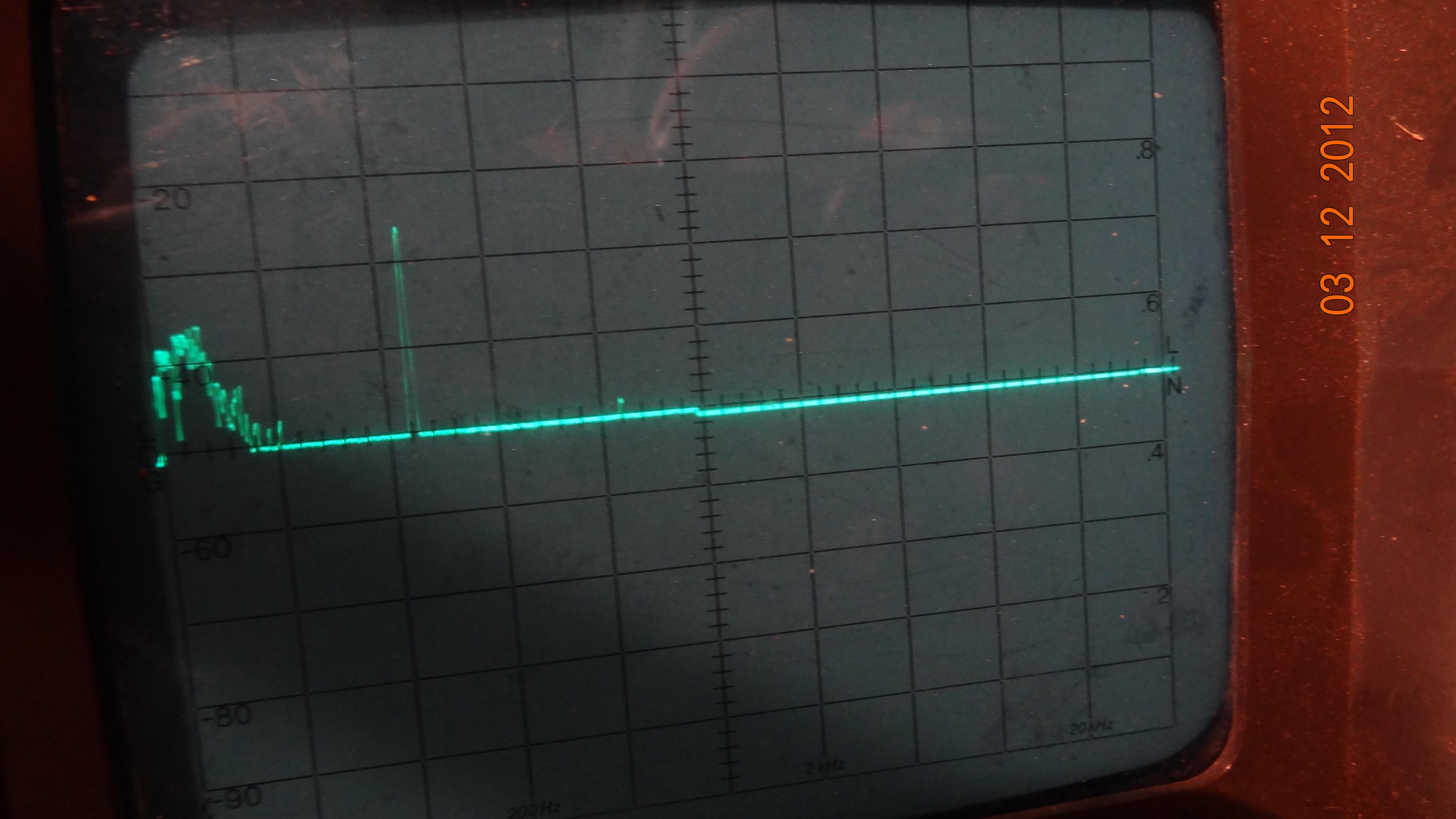

Monitor view
Here is a look at the monitor view after all that's been done.
We can see the scale is about right with a bit of added hash higher up.
The noise floor is near scale as well. So the distortion is confined to the input and notch filter.
One thing that occurred to me is with positive feed back in the notch filter the shoulders are less attenuated with the notch. Further more the notch deep is traded off for band pass flatness. But with the added distortion maybe we can afford more band attenuation from the notch filter. This would correct for residuals and deepen the notch and shoulders at the same time. The amount of feedback is then just a calibrated measure. We would need to precisely know the harmonic levels of the source and this might just be a matter of carefully injected level at the harmonic frequencies. One nice thin about the 600 ohm arrangement is a second oscillator can be easily added.

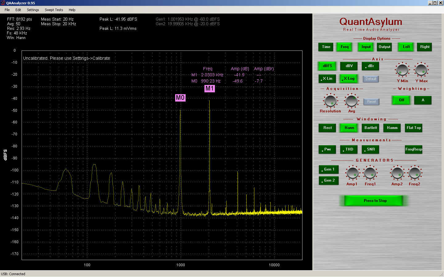

No positive feedback
This is with no positive feedback on the notch filter.
Notice there are no shoulders about the notch but the harmonics are attenuated too much.
Too bad we can't have our pie and eat it as too.
But maybe there is a happy medium. That will require injecting level at the harmonics.
A amount of fundamental must be present for the auto tune to lock onto but at this attenuation I don't think a calculation is necessary if the injected signal is large enough.
More investigation is necessary.

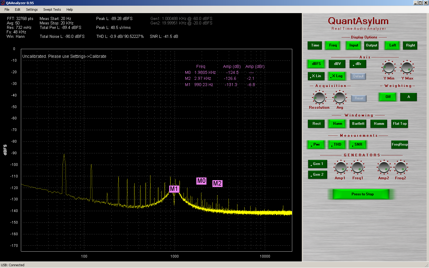

Injected harmonic level
Here both fundamental and second H level are set to -30dBV.
We can see the effect of the notch filter with out feedback.
The second is attenuated 12dB. Also the the 2kHz seems to be effecting the auto tune.
The fundamental is not being fully notched. The second oscillator is not great on distortion but surely is not generating sidebands.

The milk is getting creamy 5dB at a time
I replaced U1 on the oscillator board with an LT1468, removed C45 and C48.
Not wanting to remove any more components or cut a trace I clipped pin 8 off the IC.
Pin 8 is not used but has rail voltage on it. I wish I could use at 1468 in the buffer stage but they don't do well with a 600 ohm load.
The feedback in the notch amp should stay as it is. As it is it's down 1dB at 2n H.
