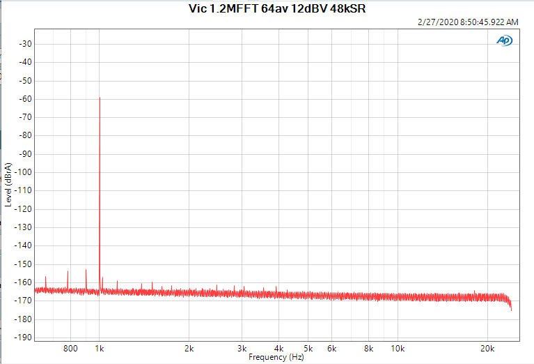

You get the lowest noise floor with the narrowest bin width. The narrower the bin, the less noise it receives.
Bin width = sample rate/(number of data points). So I set it to the lowest SR for 22k (48k), and max FFT length (1.2M). Higher output from the Vic (+12dBV, 4Vrms). And averaged 64x.
See below. Another 10dB down.

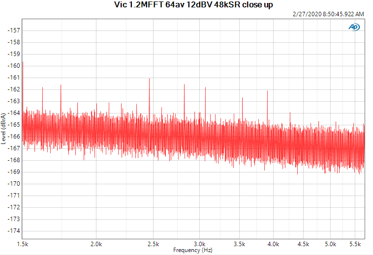

Finally, the close up hints at 2nd at -163dB and 3rd at -164dB. Wow!

Is the FFT locked somehow to the incoming fundamental?
If not, the obvious calculation:
48kHz, 1.2M FFT - takes 25s one calculation
64x averaging - takes 25 x 64 = 1600s = 26 minutes
Bin width: 0.04Hz
What is the chance for the fundamental/harmonics of a freewheeling analog oscillator to stay in the 0.04Hz bin for 26minutes?

Honestly, I do not think it is possible to sync a 1kHz analog oscillator to 0.04Hz precision for tens of minutes + keeping the ultra-low distortion at the same time.
IMO you would need to zoom the freq axis in to see individual bins adjacent to the fundamental/harmonic freqs (no idea if your tools offers such level of zoom, but e.g. exporting the FFT values to CSV would do).
Look at this discussion Average FFT Magnitude in bins - more averages of shorter FFTs with a bin large enough to cover your fluctuating frequency for the whole measurement period may be the way to go, IMO.

I'm using AP's proprietary equiripple window. My 2722 at home has the option 're-align and move to bin center' , but not the 525 I am using here.
That may do what we need here as it is specifically meant for spectrum analysis in what AP calls 'open loop' meaning an external oscillator.

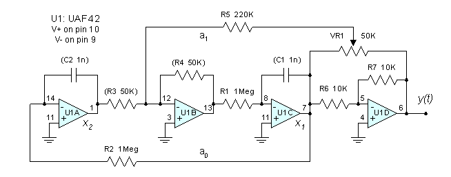

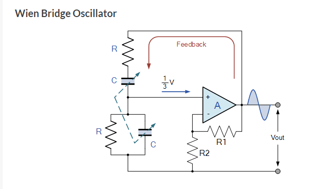

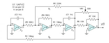

Attached are the simplest basic schematics I could find for both Wein Bridge and State Variable oscillators. What would be the best injection point?
Both the KH4400 and Victors are Wein Bridge oscillators. As I remember I tried injecting in the - input of the amp. It should take only a little to lock the oscillator if its close. I know that its really hard to prevent locking with crystal oscillators and special amps have been developed to improve input/output isolation.
I would look at injecting directly into the gain control element somehow. As I mentioned before I had an oscillator stabilized with a precision Tel-Labs PTAT resistor, it would only lock for a minute or so before thermal transients de-stabilized it, but when locked in the Q and THD were incredible. By Q I mean the noise sidebands, never saw anything like this.
In the tracking notch I put the filter quadrature output and the fundamental into a 1496 phase discriminator which then outputs a control voltage that is minimum when the notch is 'locked' to the fundamental. I can imagine that you could insert this control voltage into the oscillator control element to 'lock' it to the external source.
