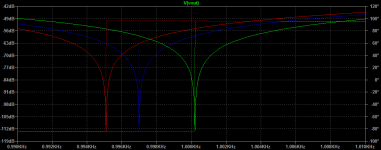

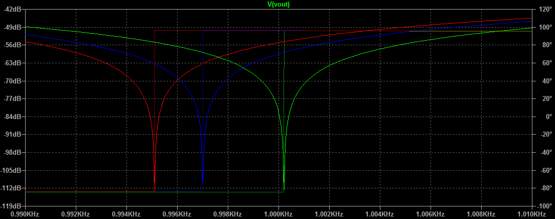

The second plot shows what happens if I only adjust the "R/2" of the T, for the same range of 31 ohms as in the plot before. The notch depth suffers much too hard for my liking, that's why I went the extra mile and used a bunch of relays.

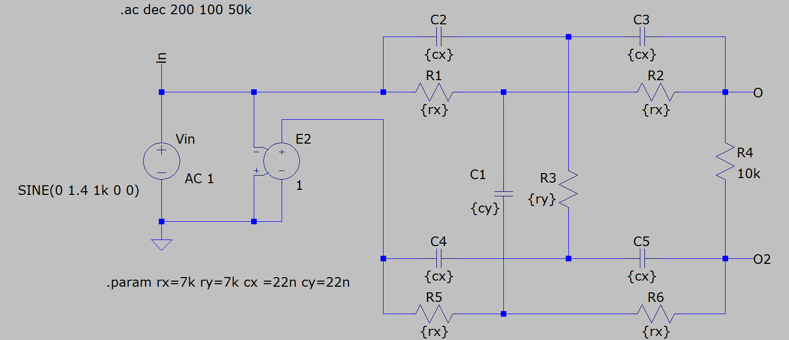

Hi Lasse, I am trying to follow this interesting thread but stumbling upon your post leaved me a little confused, when you write "R/2" what resistor are you actually referring to in this schematic below?
Also, how big are the changes in resistor value for each curve drawn in the second picture and what is the resistor value in your notch filter, thank you.
I did not use the symmetrical schematic that you are referring to. If you were using only the upper half of that scheme, I'd be referring to R3.
The changes are made with 1R steps for almost 32R total (31R1 actually, leaving out the contact resistance of the relays for now). The resistance value for the T is about 16k1.

Did another simulation run with the Bridged Differentiator in direct comparison to a Twin-T. Looks like it stacks up pretty well (the notch is almost equal for both) and is much easier to trim for a couple of Hz. Why didn't I knew that one before I started building the Twin-T? Now on to find its weaknesses .

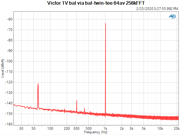

... and this is Viktor's 1kHz oscillator, 1V balanced out, via de bal-twin-tee. First independent verification I have seen that his oscillator is clean down to at least -150dB. Viktor, chapeau!
The bal-twin-tee is not yet in its intended enclosure, hence he mains spurs.
Jan
Jan

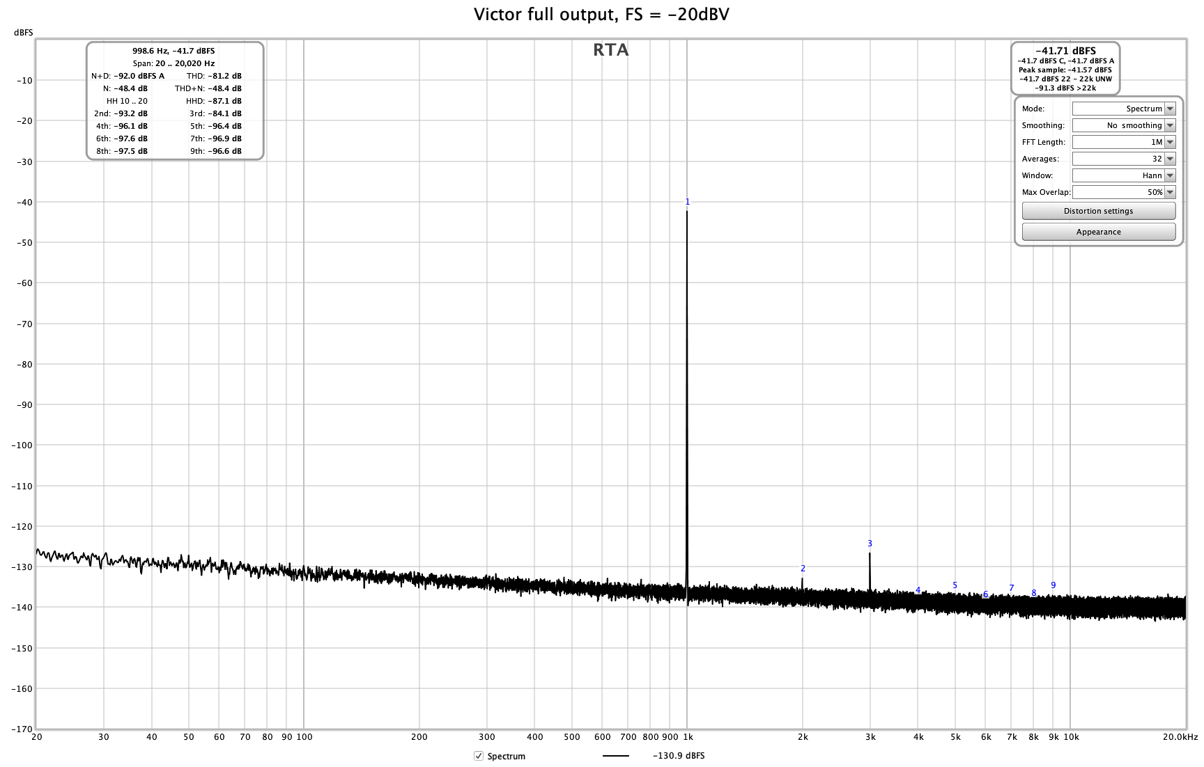

I find that it is clean to down below -155dB (3H) and for 2H even -160dB.

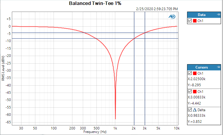

Balanced Victor with notch filters from Victor, in balanced configuration.
Victor output is 14.6dBV, full scale is -20dBV, and notch attenuation at 2H and 3H are 9.4 dB and 5.4 dB, respectively.
