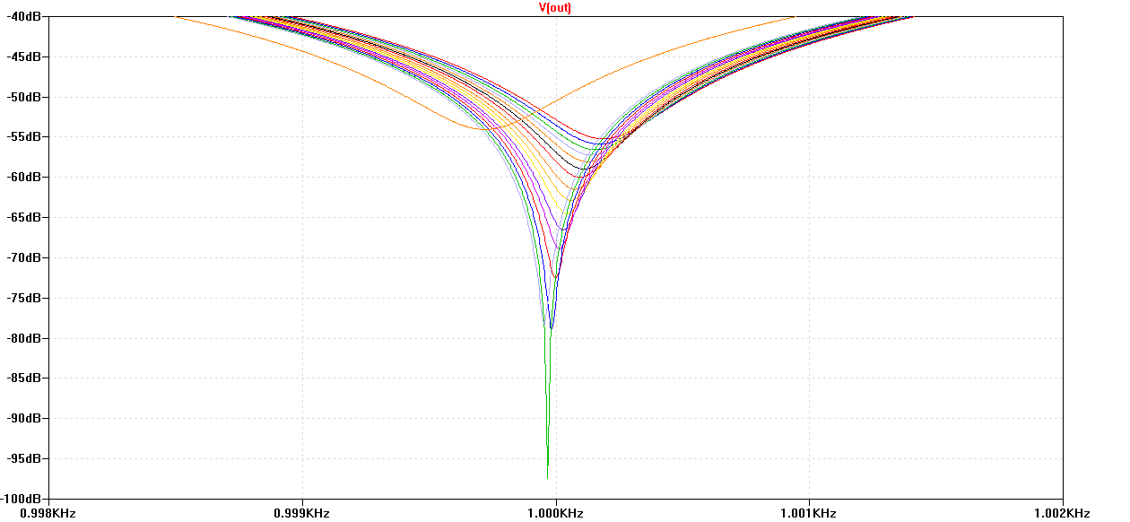

I am currently building an active Twin-T with a sharp and deep notch, so the attenuation at the 2nd will be minimal (0.1dB or something). To be able to keep the notch spot-on, I add a 5-bit relay switched threefold trim resistor (registered trademark ). This will allow me to shift the notch by about 1.5Hz for 1kHz center frequency, with just a single rotary encoder. Hope this works...
Are you saying that each step of the rotary encoder shifts it 1.5 Hz, or that the entire range of all 32 steps of the rotary encoder gives a 1.5 Hz shift?
Your approach is obviously the right way to accomplish a shift with fine granularity and minimal notch degradation. However, I have found that just trimming the shunt resistor in the twin-T network will shift the notch a little bit with quite small degradation in notch depth. I have not simulated that effect (e.g., notch depth degradation vs. frequency shift), but it might be useful to know in deciding what approach to use in a given circumstance.
Bob

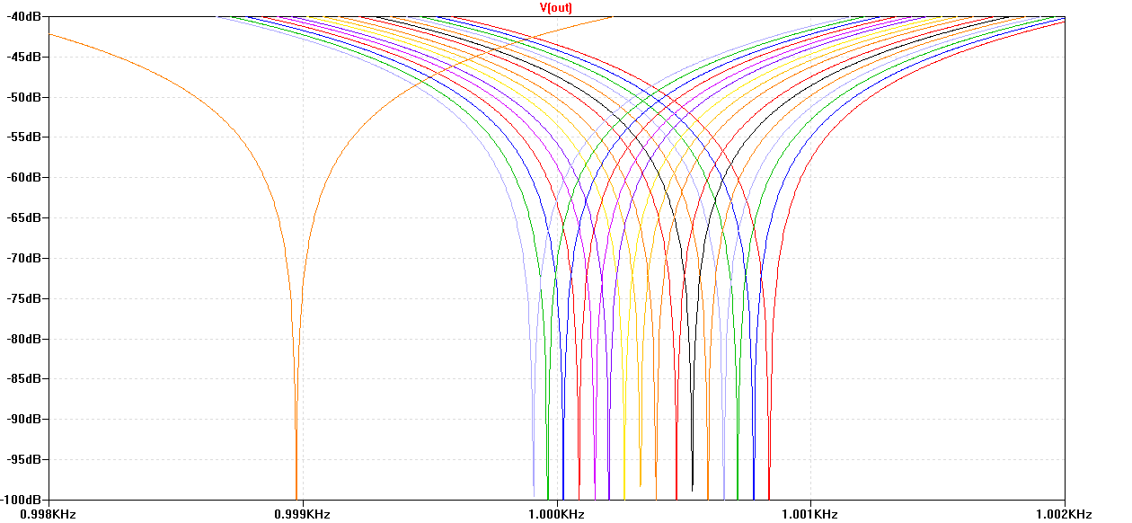

The entire range of the circuit I'm building according to my simulations will allow a shift of ca. 1.8Hz, with a step size of ca. 0.06Hz (or 60mHz) for each of the 32 steps.
Here are two simulation plots. The first one shows what I'm expecting to achieve. This is with capacitors of 10nF matched to within 2pF and pretty much ideal resistor values; in reality I expect to get around 80dB notch depth, probably even better with an additional pF here and there.
The single steps cross at around 72dB notch depth, which should be some kind of worst performance limit I suppose.
The second plot shows what happens if I only adjust the "R/2" of the T, for the same range of 31 ohms as in the plot before. The notch depth suffers much too hard for my liking, that's why I went the extra mile and used a bunch of relays.
Thanks for doing these sims. Looks good.
You're welcome. When I have the prototype up and running to compare it to the simulation, I will open up another thread to show the results, including simulation files, schematic, matching procedure for parts, ASM for the uC and all that stuff. Maybe it will inspire others to build one for themselves - I won't be building them in numbers like Victor does with his oscillator though .
