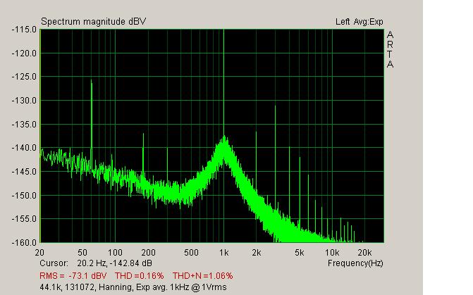

here is the 339A oscillator. !kHz @ 1Vrms.
44100 ksps, 131072 point, exponential averaging.
The first is FlatTop and the second is Hanning.

If you have a reasonably pure tone that is centered in a bin of a known value I would think they will all give about the same number. Its a number that can be measured with a conventional meter to pretty high accuracy.
Differences can also be due to drift, a problem with large (1M point+) FFT's where the signal moves from bin to bin during the measurement.
Well, you see in the pictures at #3916, above, exactly what I see with the two win filters. I might actually have to call A-P to explain it.
THx-RNMarsh
I see that. However the noise should drop not the harmonics. At least not that much.
There is small differences in what I posted. Those difference are inline with what's predicted for those two windows.

Coherent sampling requires precision and stability not possible with an RC oscillator. If you lock it to a clock linked to the ADC you can get there if the locking doesn't add too much distortion. The melt noise feature of the QA400 does the coherent sampling thing if you want to try it.
I modded a KH4400 for this and it works but open loop it does not. Triggering the sampling on the oscillator won't work. The trigger is not perfect enough.
Coherant sampling with no win (rect win).
What's the setup for this plot? As far as I know there's no way to get the "corehent sampling" mode to work correctly with a notched signel--you need the fundamental for this.
The "flat top" window is the best to use for THD measurements as it gives the lowest (IIRC a fraction of a dB) amplitude error of all windows available in the SYS-2722. It has poor side-lobe behaviour, but that's no issue as the dynamic range is low after the notch filter.

See A-P's 2700 Series user's manual (575 pages :eek:) on the DSP Analyser. Chapter 11. Pg 225 of my manual.
I would think the sampling would be locked onto the signal before the notch. but, Hey! What do I know. I used the HiREs A/D @SSR for input setting, if that helps.
All previous data was with Flat Top. It shows higher than Demian and David's levels. That is the issue to understand.
