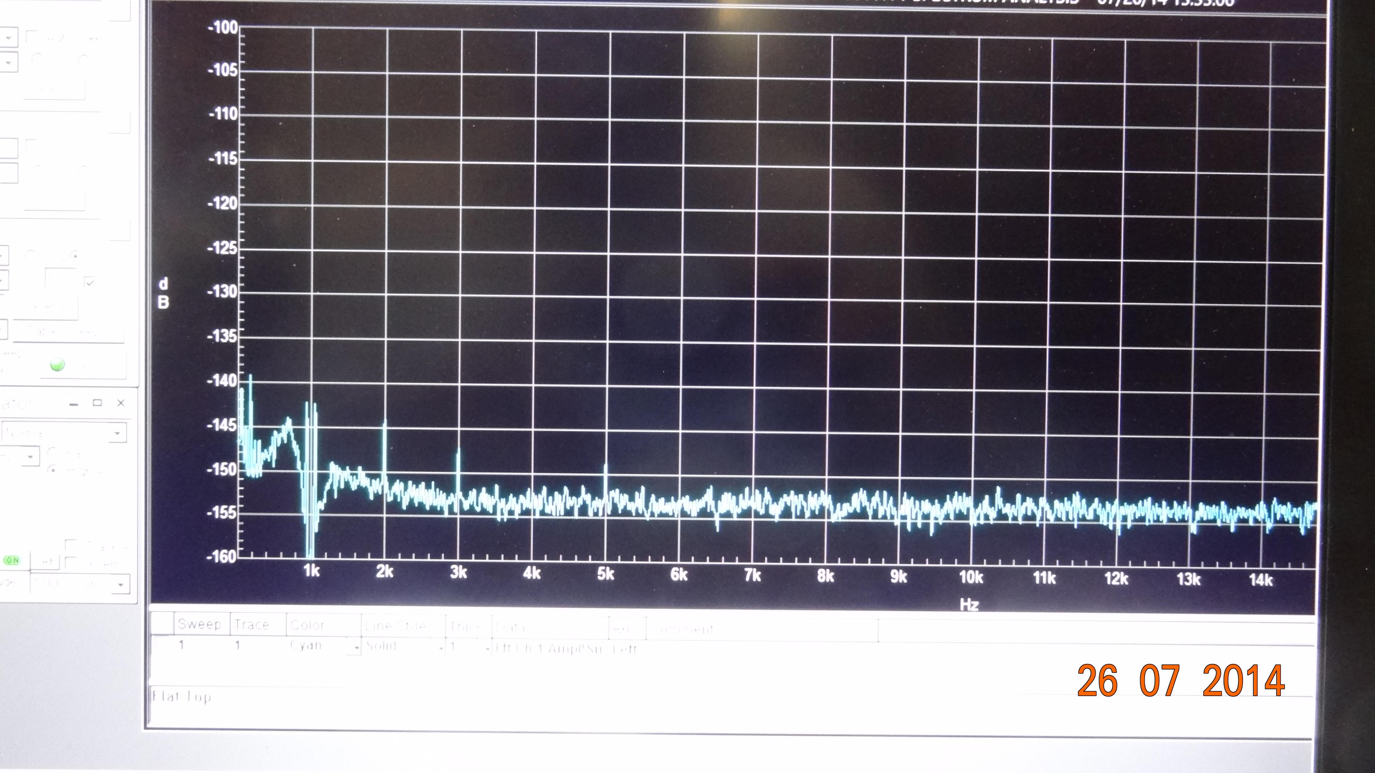

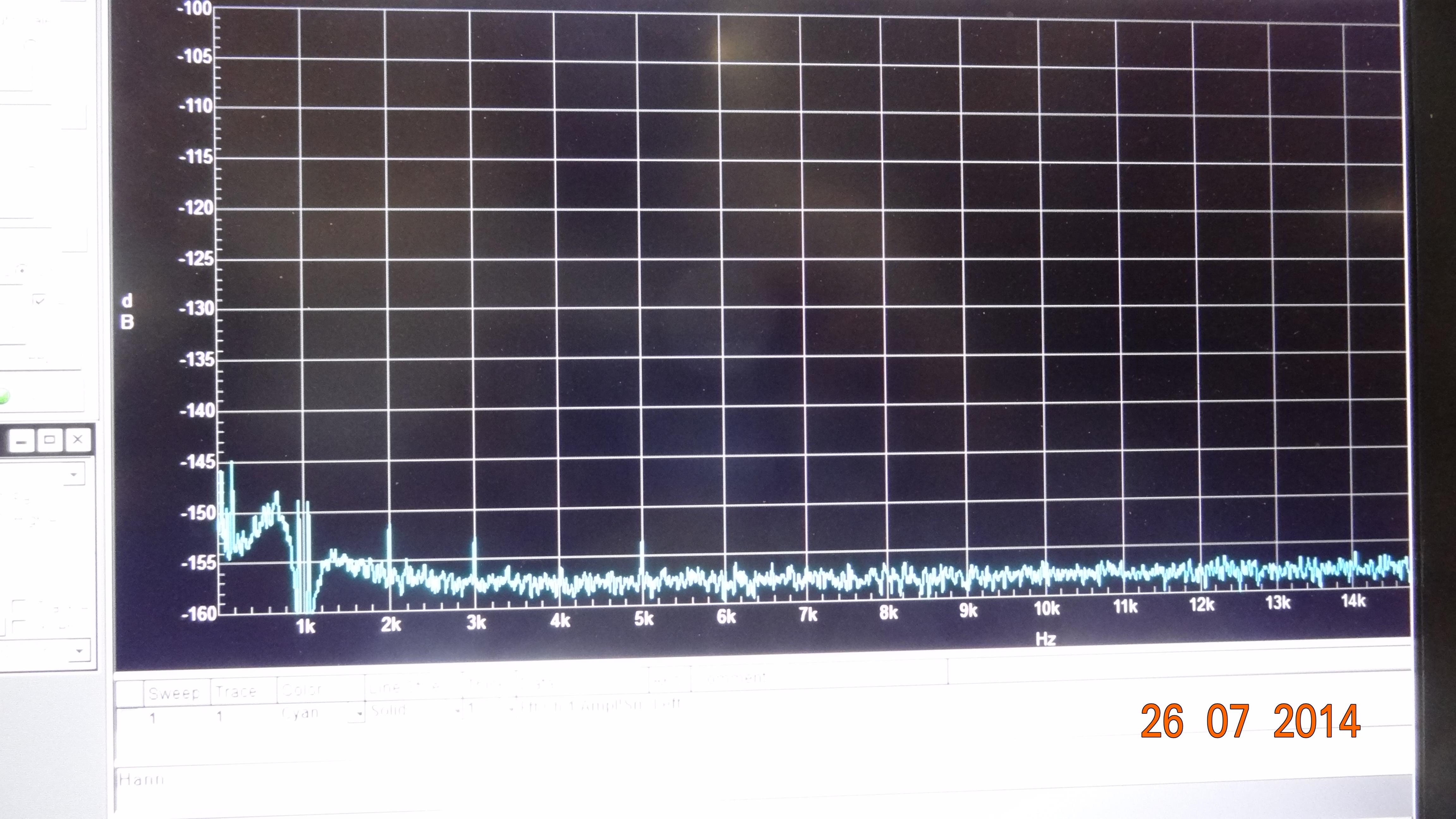

Thank you, all. The Hann gives excellent resolving power for the first -50dB down. The Flat Top is better from -50dB and lower.
Here is the A-P results of using its own internal osc/gen with the Flat Top and using the Hann at < -140dB levels:
As you can see, there is a 4-6dB difference. [as reported, I have seen with other higher levels of thd/spectrum, differences of 9dB]:
FFT Flat Top.jpg Flat Top
FFT Hann.jpg Hann
In all cases, the Hann always gives the more optimistic number.
I tend to think the higher amplitude number is more accurate. But, how does the noise floor difference relate to this difference in measured levels? I notice it is the same level change as the harmonic amplitude differences... cant be a coincidence.

It depends on the resolution used. How much noise power is in the bin, the width of the bin
and measurement bandwidth. At different RBW you'll get different results.
Nothing changed between the 2 tests.... same BW and same rbw etc.
OK for now... just note the difference of an average of 5-6dB in levels. And, if we dont standardize on one or the other window filter for these tests. That is -- if I measure -146 and it is -151dB with a Hann FFT window filter... it is really the same DUT. The noise change is due to filter BW and shape.

You shouldn't be getting that much of a difference. I certainly don't just using a active TT, Emu0204 and ARTA. Something else is going on. You need to here from someone more familiar with the AP. What I see between flattop and hann is a higher noise floor with flattop. Very little difference in harmonic level.
