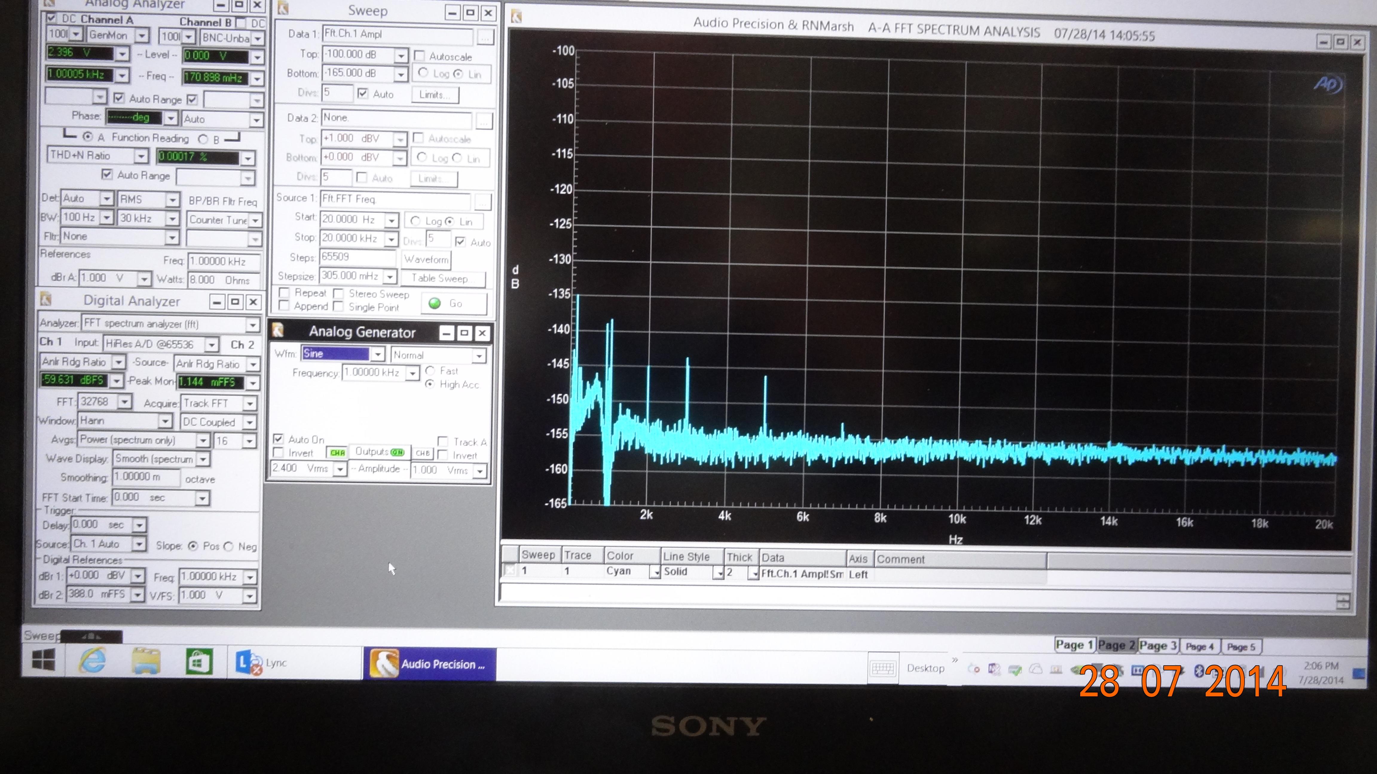

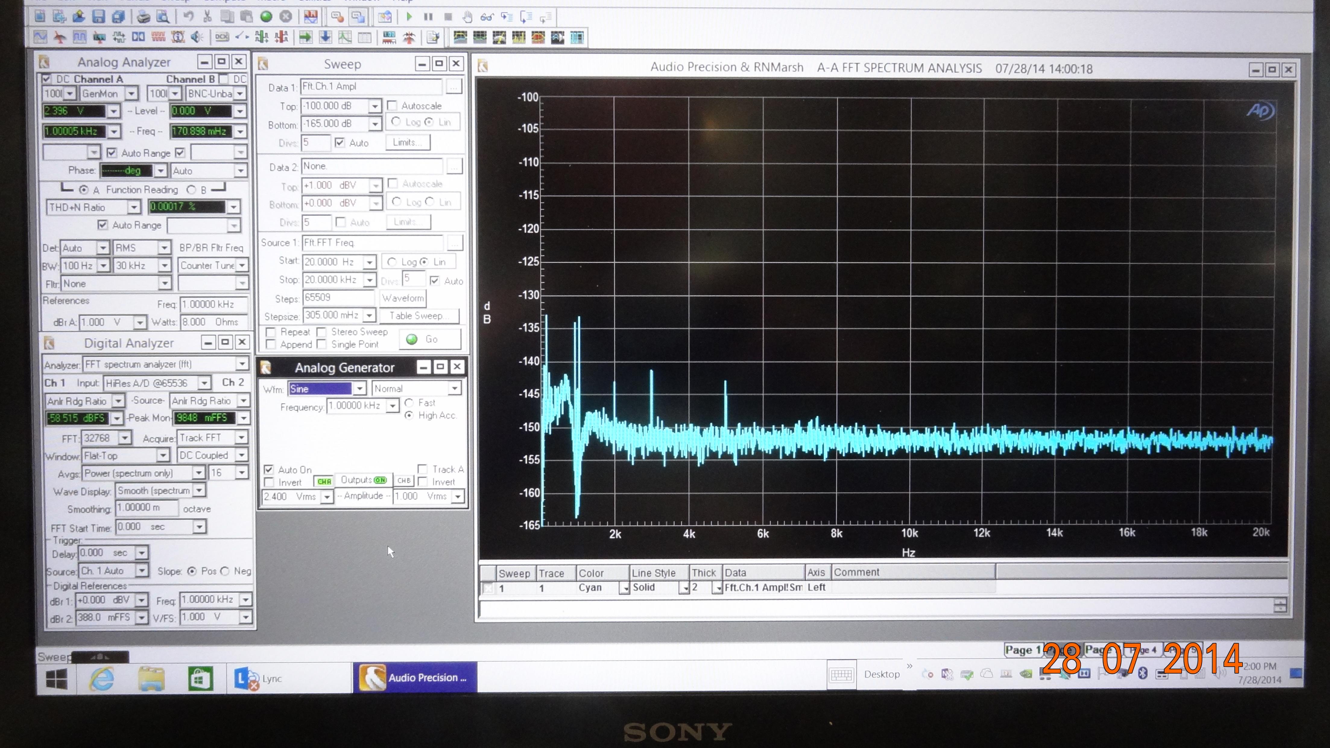

Windowing compare
Right. One reason I got various noise levels shown was due to my changing the BW settings. But like I said, i dont want to know the noise.... but why the harmonic levels weren't closer. I think I have zero'ed in on it.
Originally, I wanted to see what was a rough estimate of the harmonic level.and was fighting EM noise intrusion. I said it showed about -146 (1KHz) using Flat-Top. When I try for more accurate testing, i get closer numbers to the Hann. But there is still a small difference with Hann (Von Hann, if one prefers). That difference has been narrowed to about 2-3dB. Hann is always lower, still. At these low signal levels and noise nearby, I can get variations from test to test. Not much but its there.
On absolute terms, there may be differences from my use of higher sampling rates and larger FFT size and/or step size etc. Not to mention the peak freq detector algorithm.
Flat-Top
Hann
This may be the most accurate method at locating/measuring the peak level:
Flat-Top
Hann
View attachment Peak det algor.pdf
THx-RNMarsh
