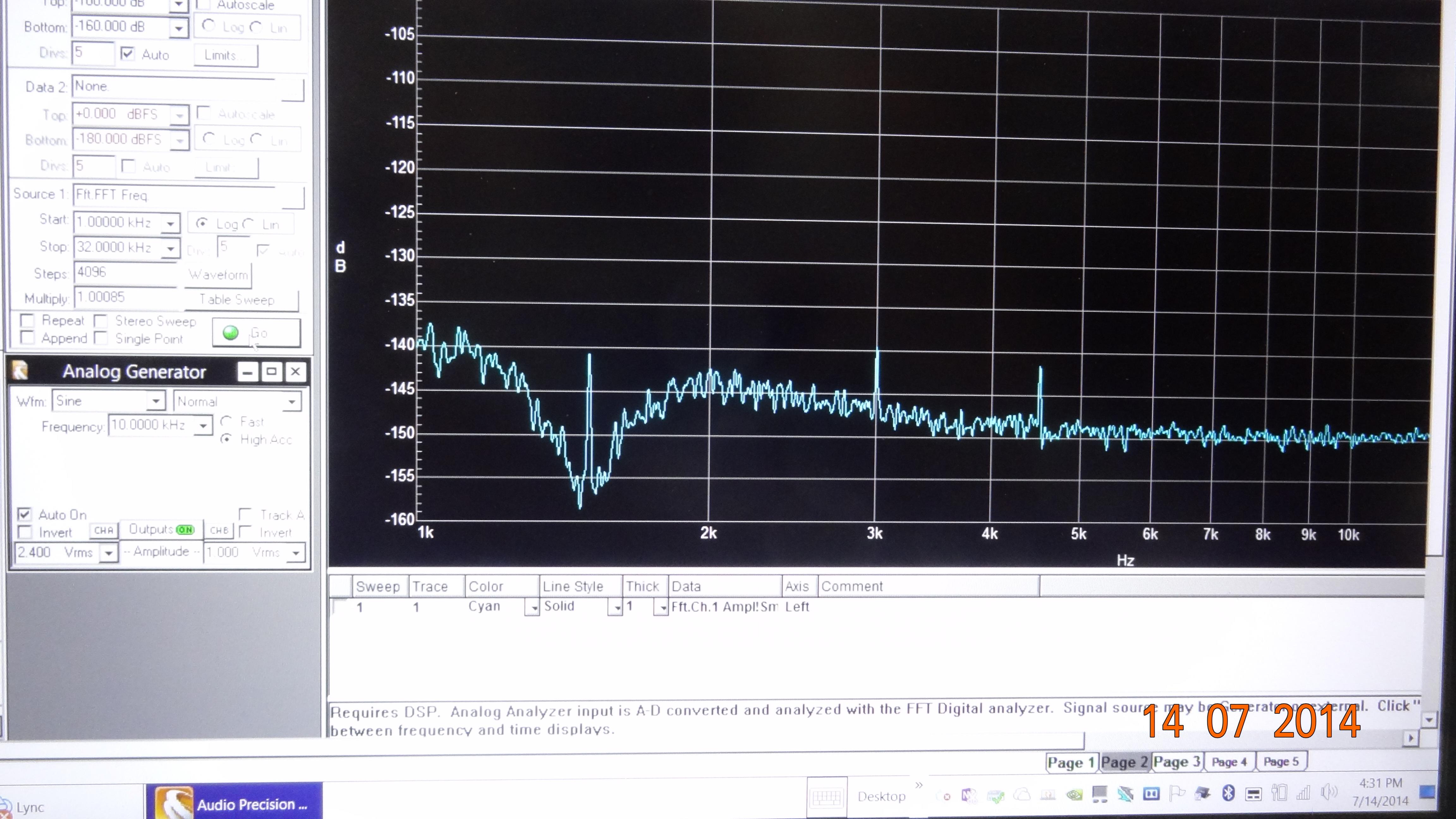

Here is the 2H and 3H of a 1.5KHz signal from david's osc/generator source. No 10KHz :)
THx-RNMarsh

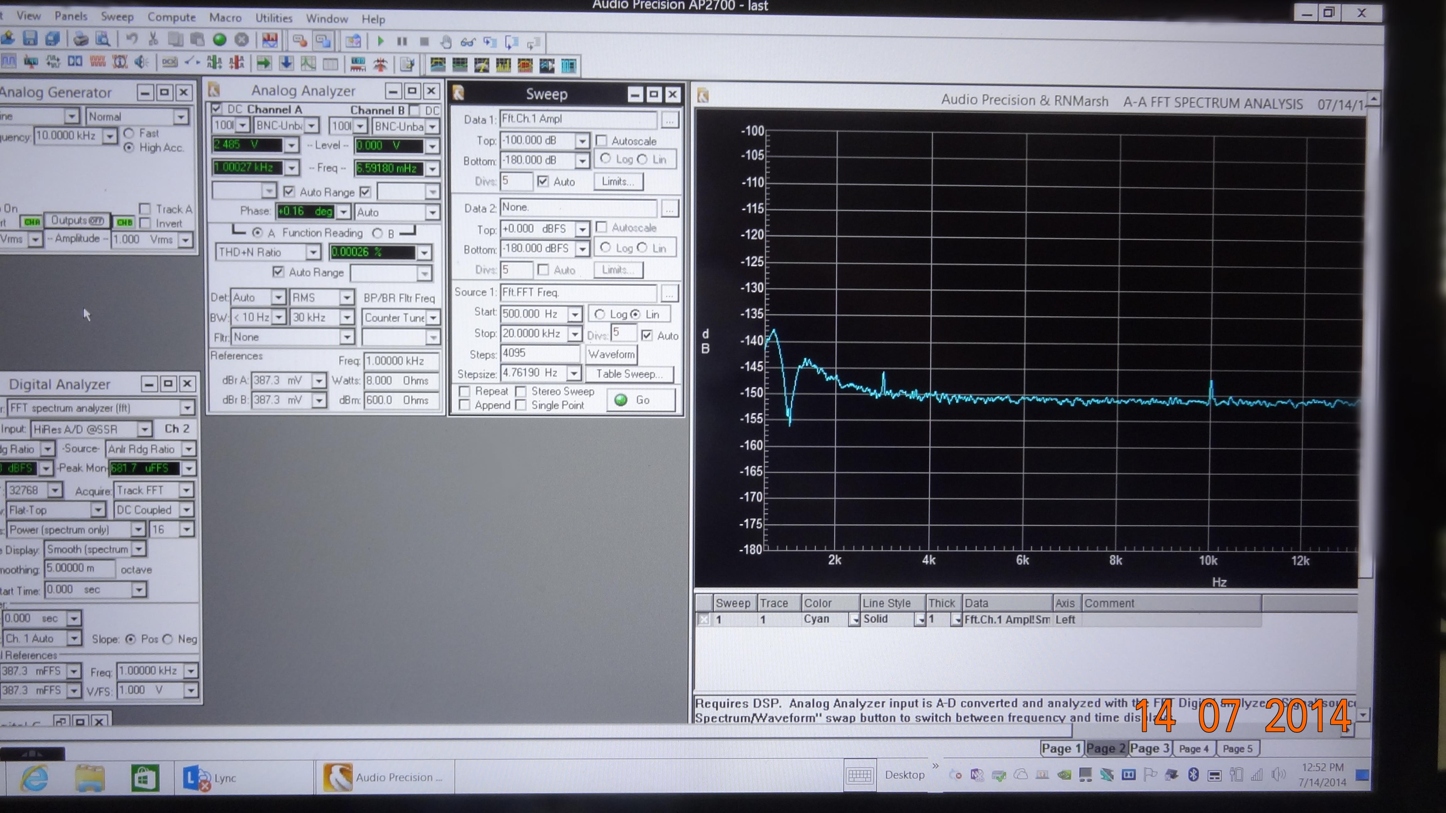

Here is the true (according to A-P 2722) level of harmonics of a 1KHz signal from the osc/generator that David has designed;
David.... YOU designed this. You did the study and figured the best way and did the hard work. Yes, many here at DIY contributed input and help in various ways. That doesnt make it part their design... help is help. It is your design/work and you went thru all the permutations and sorted out what would be the best way. A 2 year effort deserves a big round of applause. Now here 's the fruit of your labor:
THx and I really mean THX, Richard Marsh

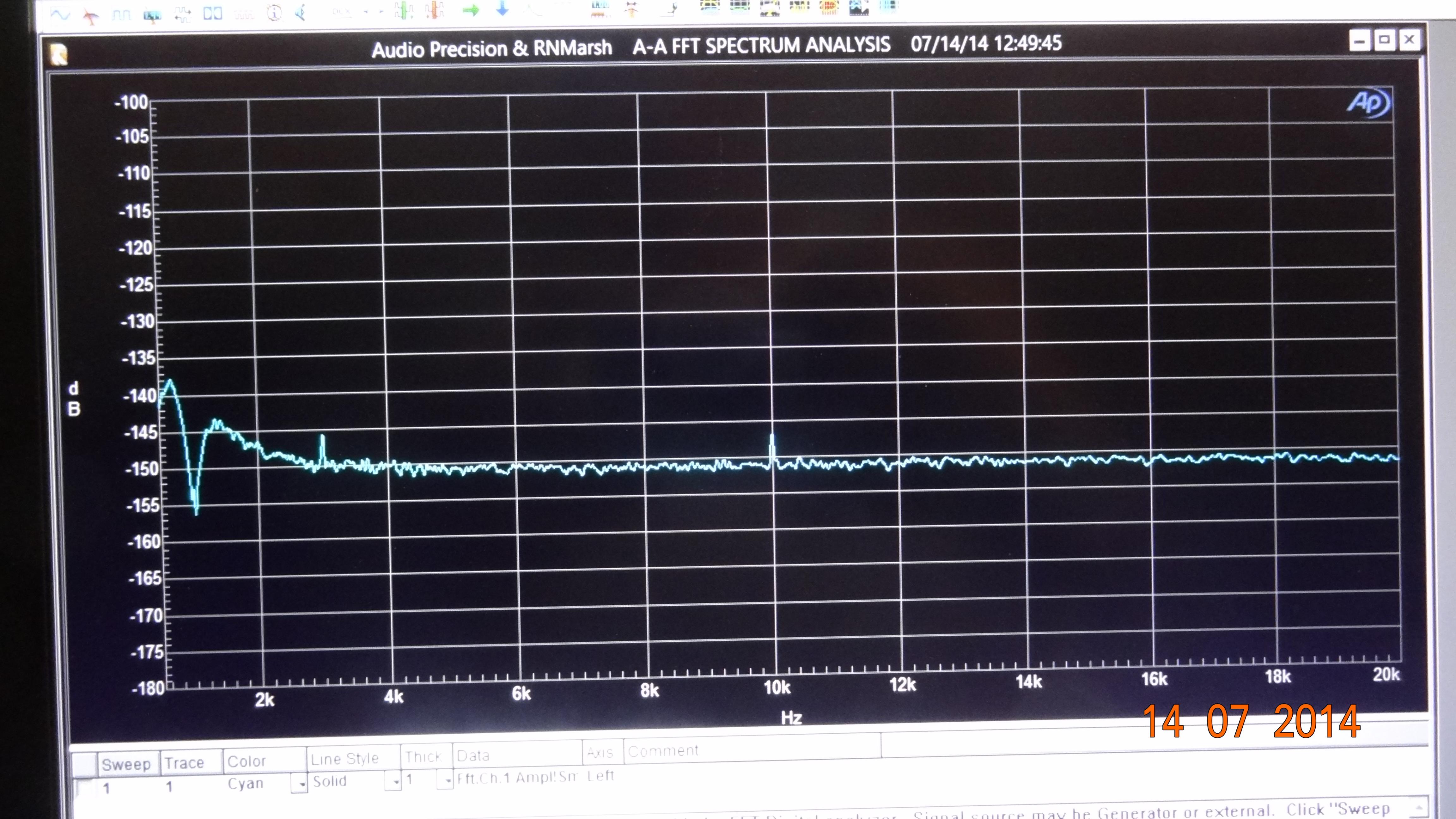

Here is david's osc at 10KHz freq. 2H and 3h level at about -140dB
THx-RNMarsh
Richard the 10kHz distortion is elevated by leakage from the sync signal off the zero crossing detector. It is this signal that's routed to the micro controller for frequency counting. This showed up at the last minute when I was packaging the SVO to send to you. I didn't have time to clean it up. I thought the shielded cable connecting the boards would be enough, but it isn't. The isolator IC has schmitt triggers at it's inputs. I think the sharp edge is causing the problem. I might try a different form of isolation like a miniature transformer.
A digital audio trafo might work fed by a sine rather than square wave form. Control signals have to be shaped to a soft form in oscillators or we get this sort of thing.
The input to the micro has a schmitt trigger. I don't think it needs to be done twice. It improves if the shielded cable is disconnected from the control board.
It's not causing the 10kHz problem at other frequencies though. This signal is in phase with the oscillator. It is derived from it.

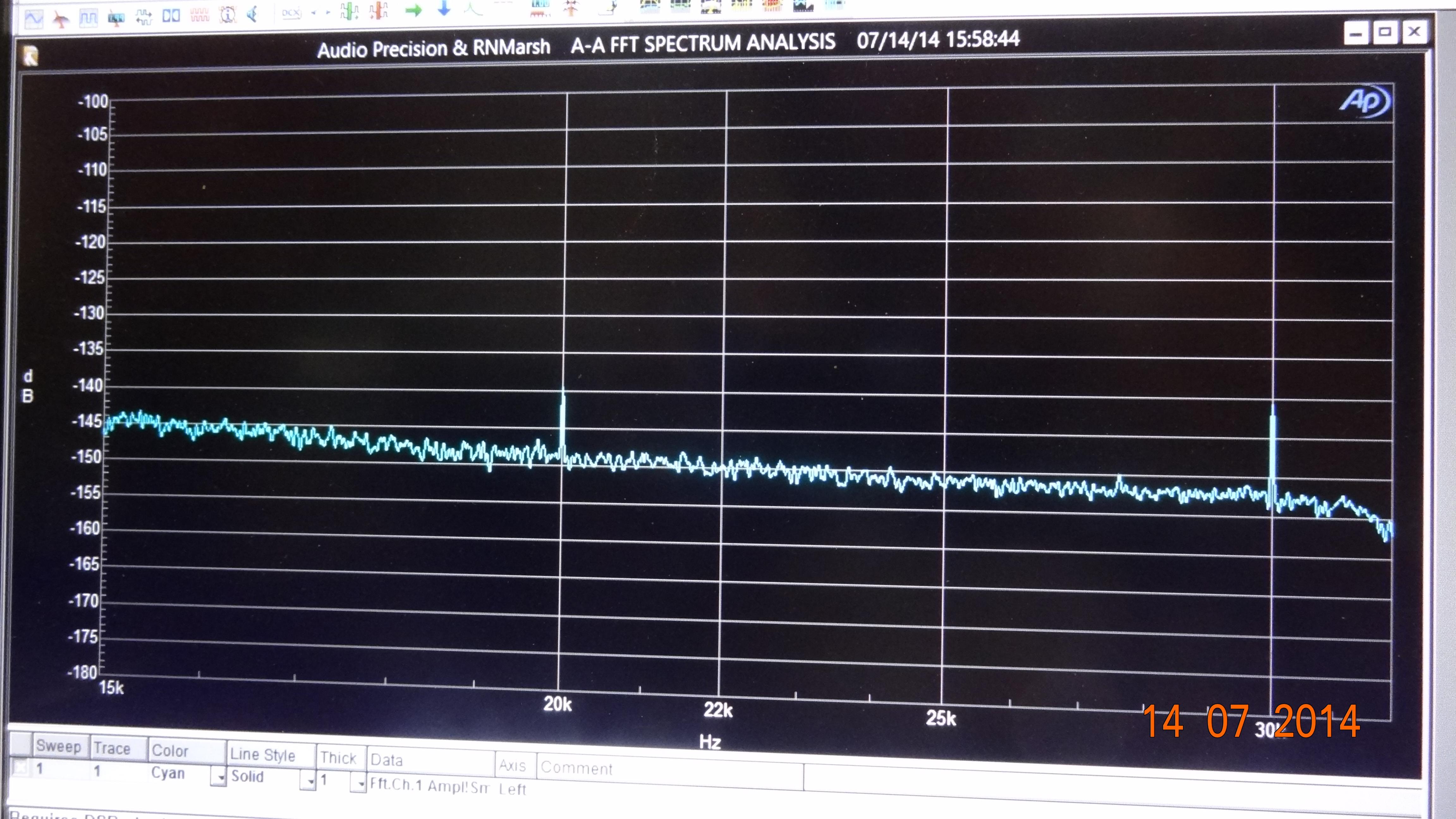

Richard, are you measuring David's oscillator distortion or AD797 based AP front end distortion?
Beginning to ask myself the same question. I dont want to go the last cm to find out as the time goes up exponentially.
This osc/generator is cleaner than the A-P generator. Noise about the same. The A-P analyzer is very very good though.
I might have to get the ShibaSoku 725D analyzer and look at its monitor output on the lowest range to get an answer. I think Demian has lowered the noise some amount in it and that will help go deeper with the distortion analysis.
Otherwise, as a stand-alone audio signal generator, one could assume anything they measure in an audio amp, at least, will have to be better than -130 or -135dB before running into test generator issues. Or better than .000032 to .000018%
