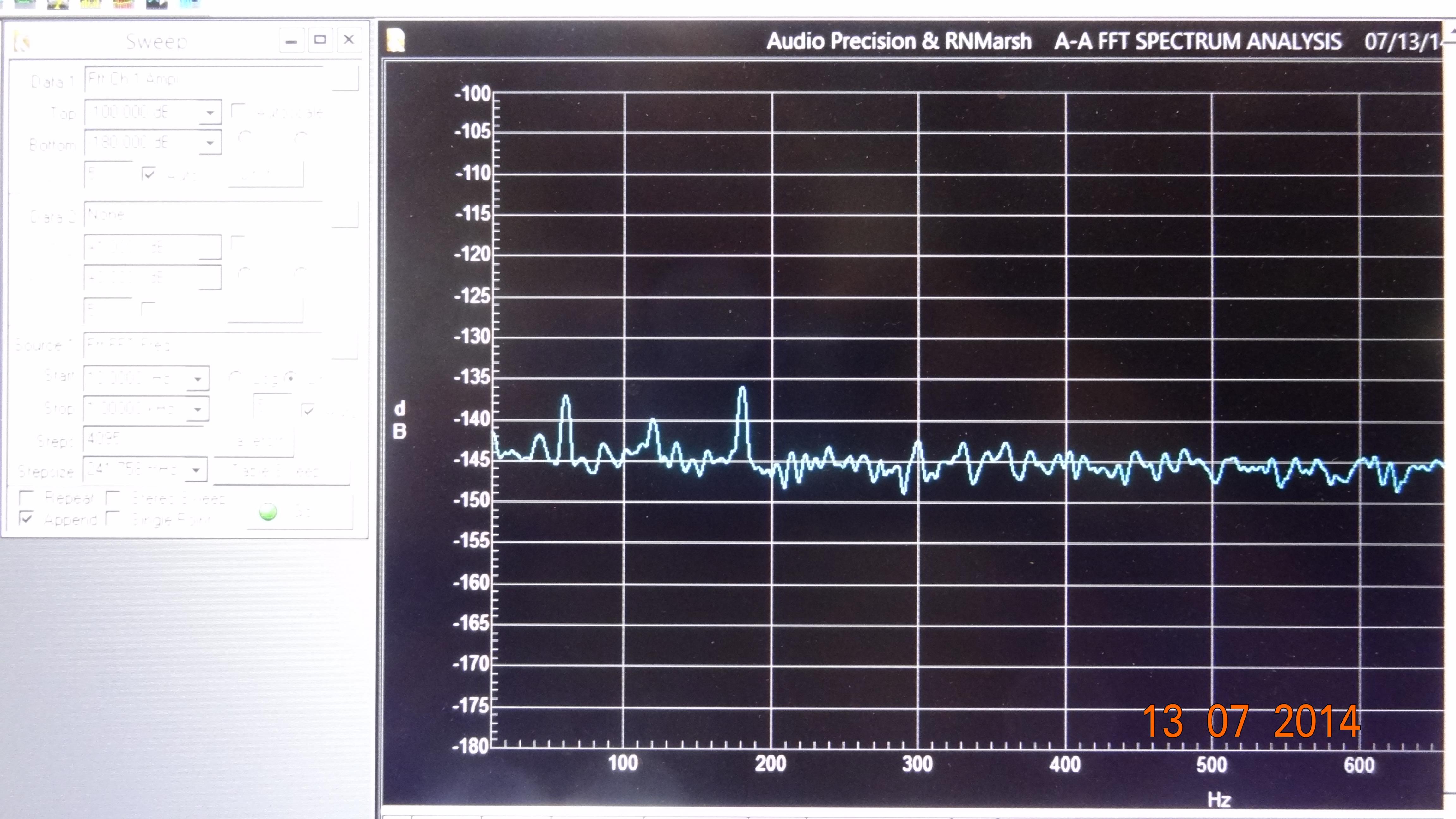

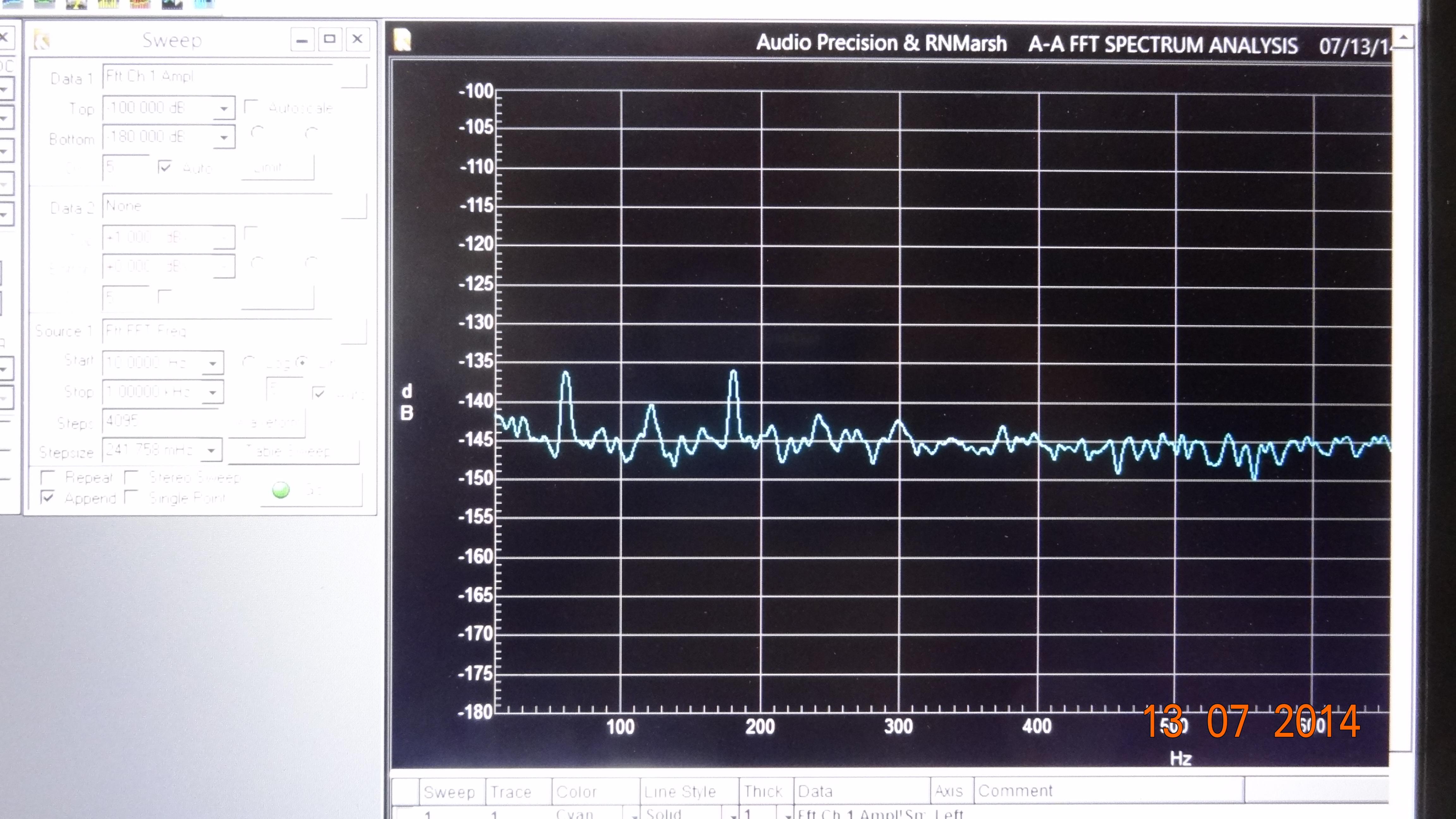

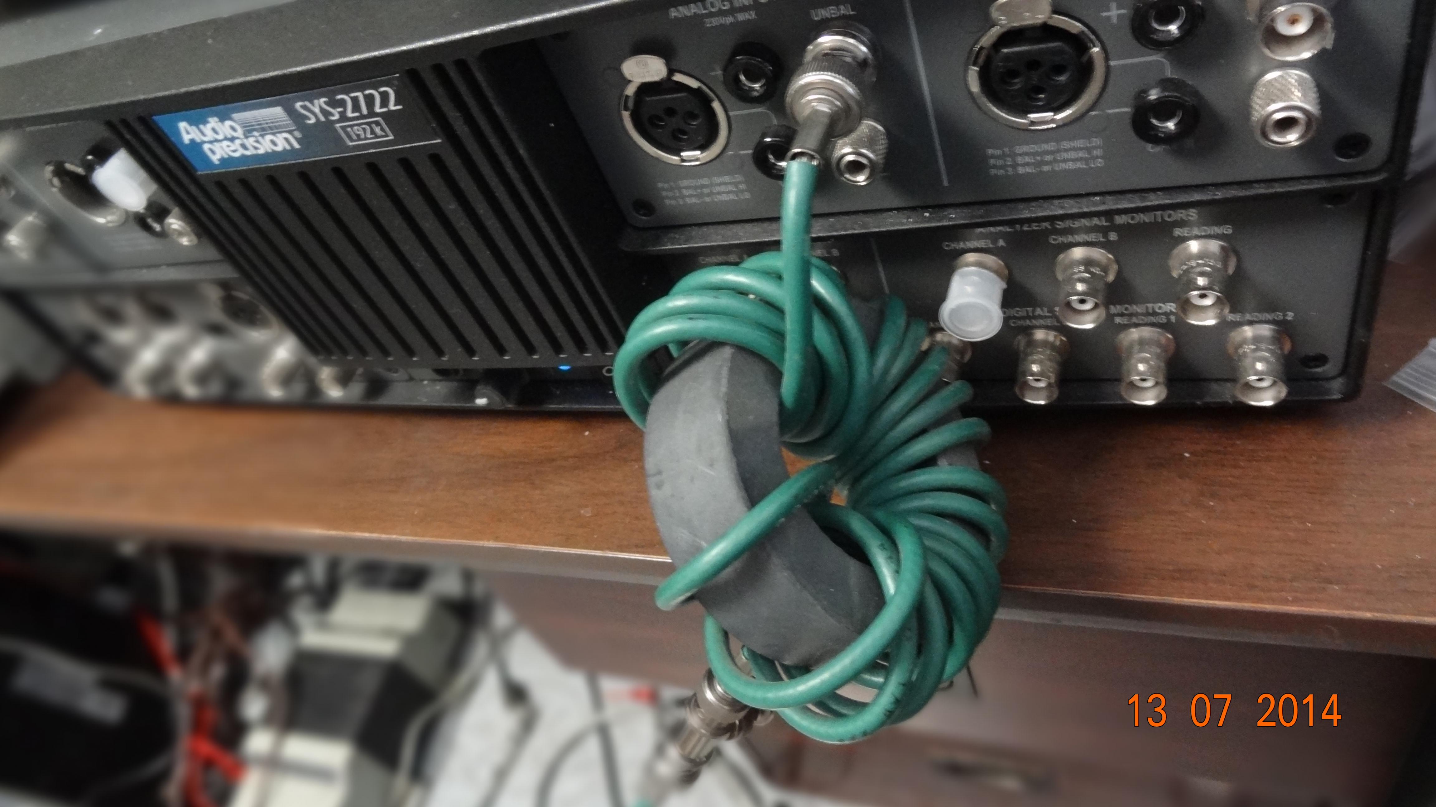

As I said yesterday..... I checked the single-end/coax for Common-Mode utility power field coupling into the cable. There was no observable change. So, now I have eliminated all but the shielding. Next up shielding affect.
Along with distance from powered equipment, the steel box the oscillator was put into did the most good.
From my plan yesterday, a 1/16th inch thick steel enclosure [isolated from the prototype and the batteries] was grounded separately to the A-P chassis ground near the input. Power supply and no other cables going in or out --- just the osc output coax. [A-P not grounded to utility ground]
And 1/8th steel box should do it.

see my above... #3813. Completed earlier this morning.
BTW - this morning I went out and bought a small 20gal garbage can with lid. That is what I put the osc and batteries inside. Galvanized steel.
comment please. Now I can go back and measure distortion without separating out all the artifacts from the DUT harmonics.
