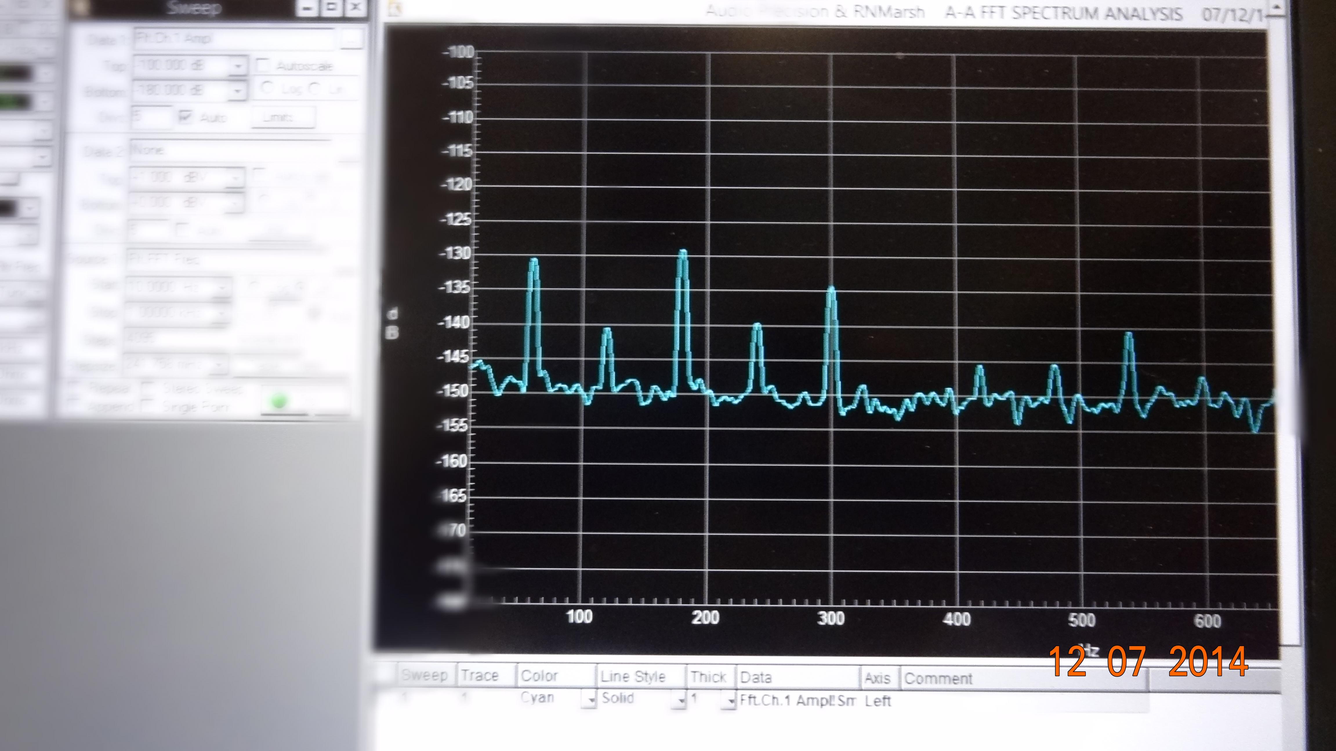

Here is what I did tonight ---- I found that you can set the osc with the SW on the XP and then remove the USB cord and the freq stays where it was set. Now no noise/ground issues from the XP. Still same problem.
I also moved the WIN8 A-P computer USB over to the XP computer and ran the A-P software from the XP. Same data. So, it is now less likely from the USB(s).
I also added 25 Ohms in series with supply with 10,000 mfd to ground after the 25 Ohms for extra filtering. no change. Noise changes around here and there but I am focused on the line freq harmonics.
I played around with power cords, isolation transformers and power grounds. No removal of those pesky line harmonics; no change in thier amplitudes.
Tomorrow is another day. I'll try batteries for +/- 15 v ... using 12v batteries (13.8v, n.l.). The current draw is fairly high -- 200mA per side as I recall. But just to see if the line harmonics diminish... if it is the HP power supply. Then on to extending the osc far from every thing else.

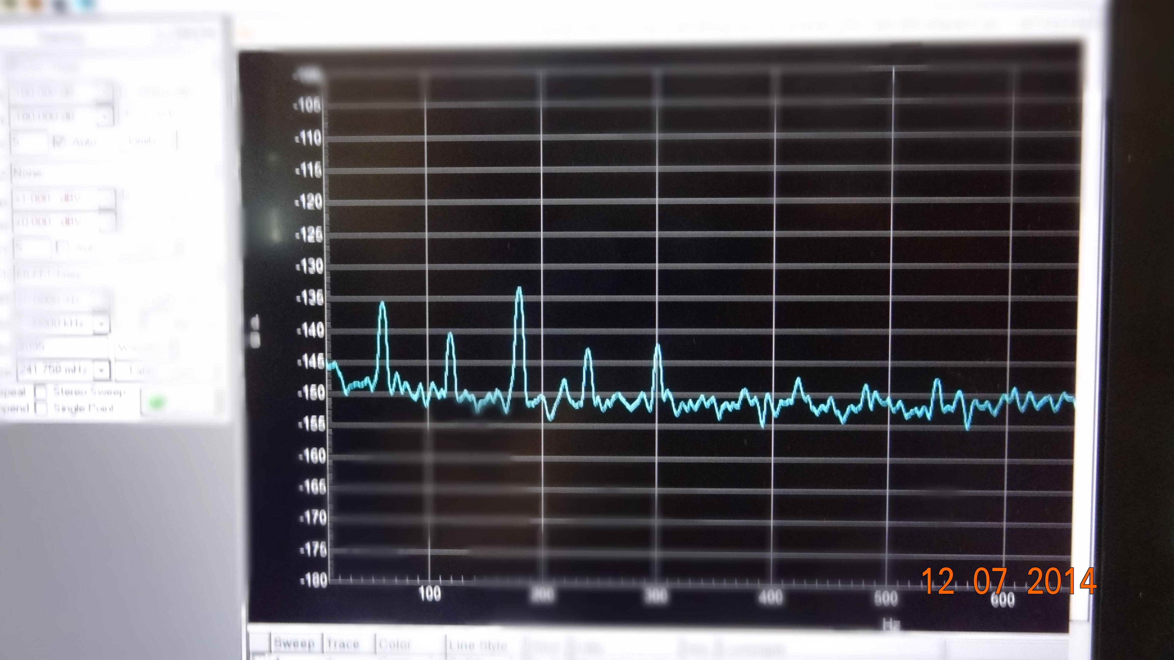

Here is the distortion at 100Hz.
The levels of 2H and 3H are very low... -132 and -135dB. However, I cant get a good reading on THD+N due to the 60-120-180Hz line freq getting into the picture.
I looked at the output of the freq gen without the USB control input and the line harmonics are still there at same level. Only the other computer's USB to the A-P was connected to freq gen.... power running on battery only.
The +/- 15 supply is very quiet but I added 10,000 mfd across each PS output with No measured change in power line harmonic levels. So, Tentatively conclude it is coming from supplies inside the osc chassis? What do you have in the way of internal power?

We both look at the same thing and see different results! I use log scale on my FFTs and you use linear, but for what it is worth the odd order AC line harmonics are dominant in your results. That to me is the signature of transformer distortion. Even order harmonics seem to indicate rectification noise. In my playing increasing the filter capacitance works when you see even order noise and for odd order shielding works better.
Now where the noise is coming from is a different issue. Trying to improve shielding is actually quite difficult. I find even moving a .062" thick piece of steel between the source and the receiver has little effect. Now distance would help if the source of the noise were small. Often it isn't (for example the currents in the power wiring are a very large source size) so moving things about may have no noticeable effect. When the noise source is small and close i expect to see more high order harmonics than you show.
This is where a Faraday cage is supposed to be the most benefit, but not having tried one on odd order distortion I have no useful contribution for that.
What I have started doing is setting the lower limit of the FFT above the harmonics to get a better reading. As noise is constant bandwidth the loss of say 600 out of 20,000 hertz bandwidth ain't too bad.

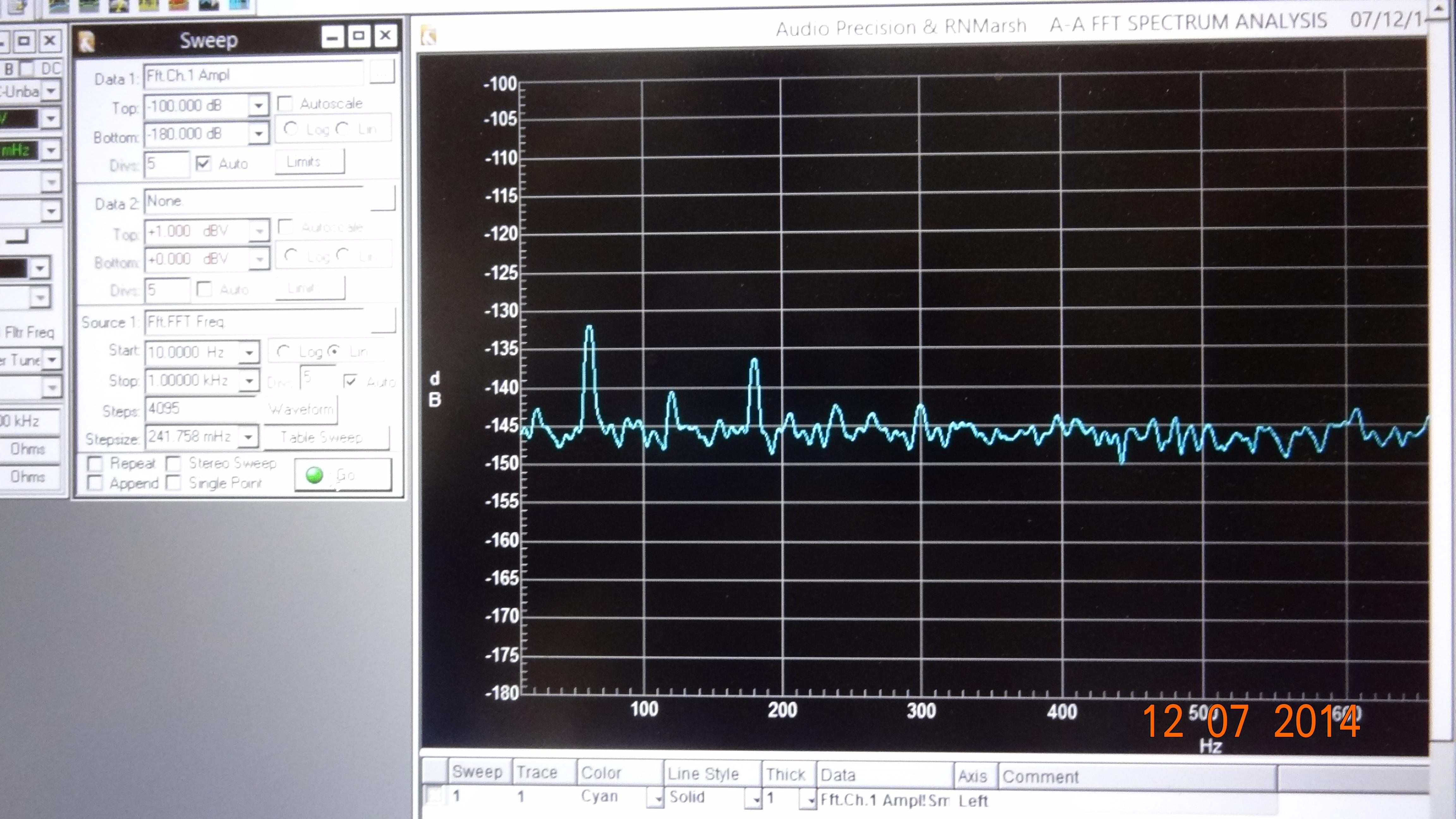

Here is what I am getting now. Where i left off was thinking it is the power supply or EMI.
I changed to battery power and the harmonics dropped.
But only 2-3dB. By-passing the batteries with large caps didnt do anything. It is interesting that if I put my finger on the battery B+ or B-, the 60Hz level increases. What does this suggest?
The best effect was to move the unit further away from most electrical... but probably not far enough anyway.
