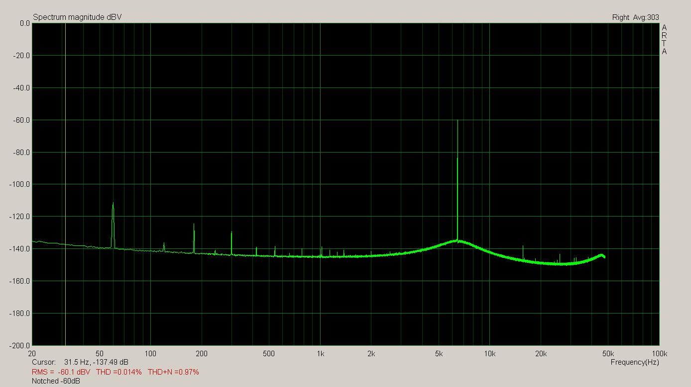

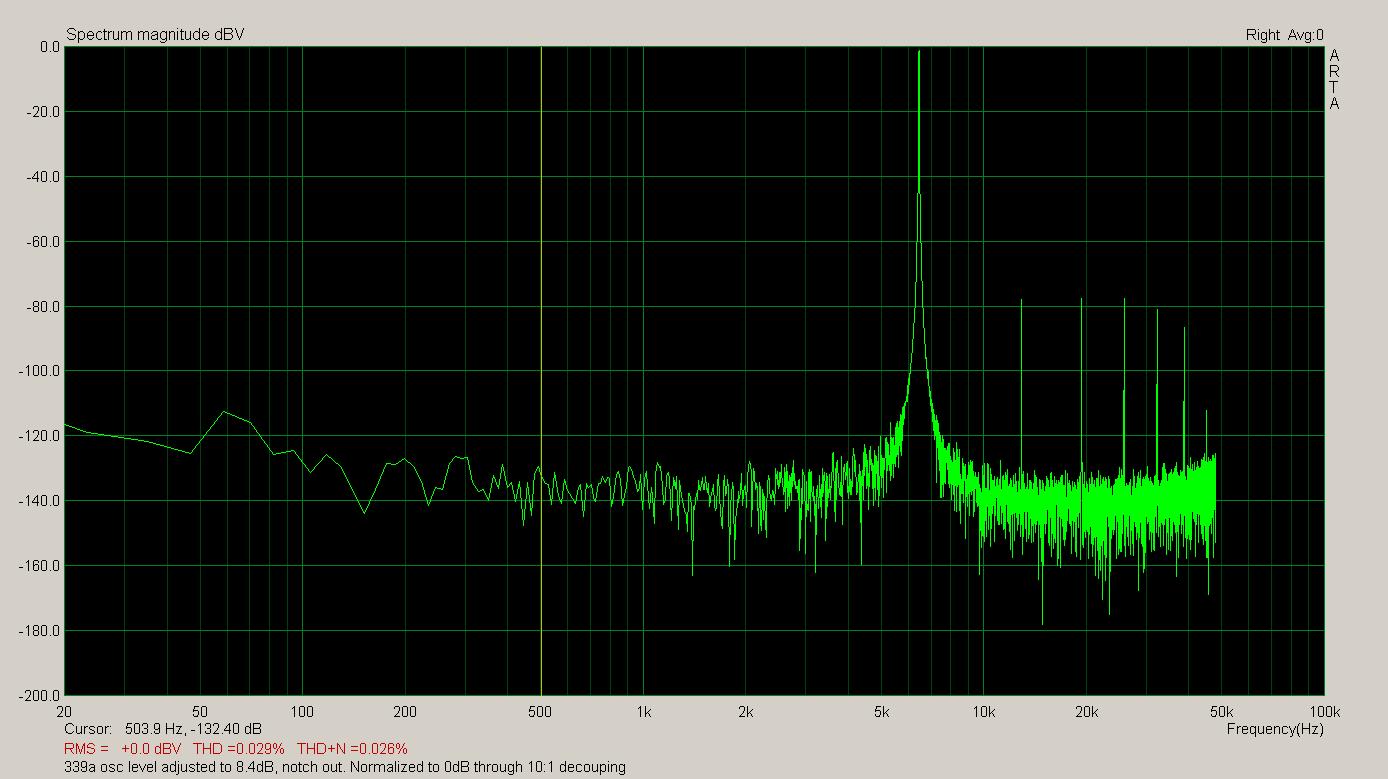

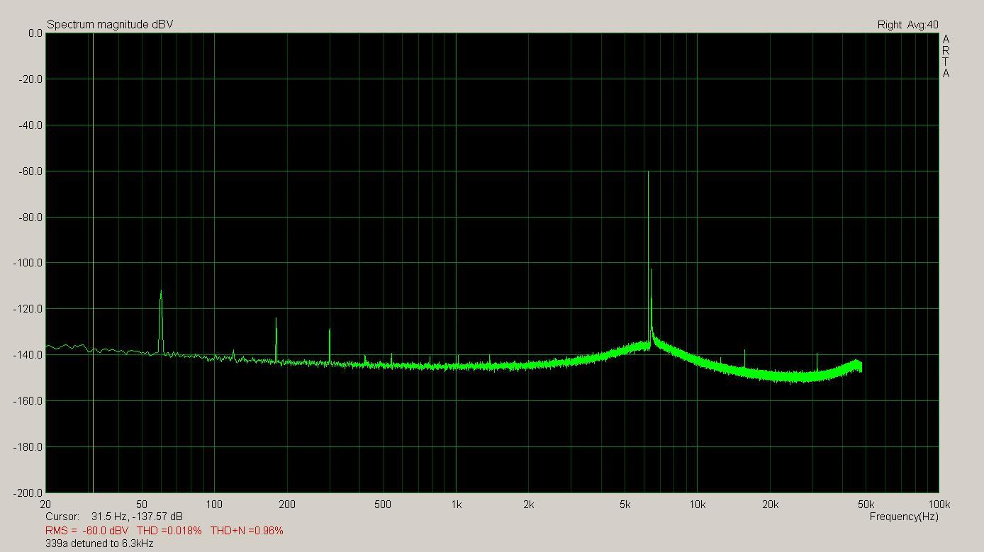

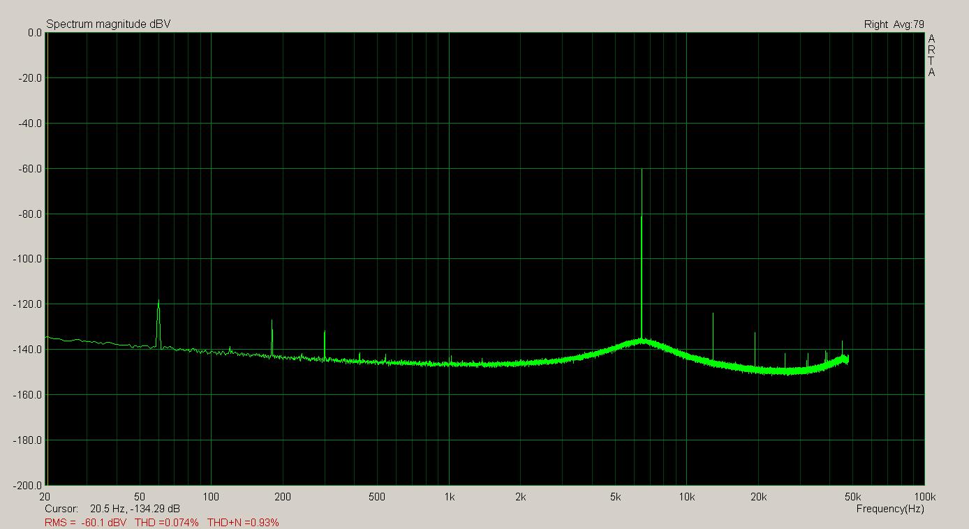

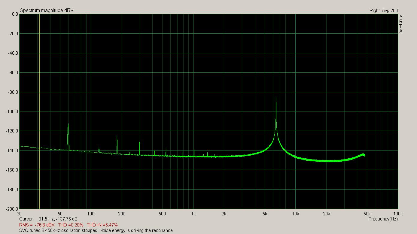

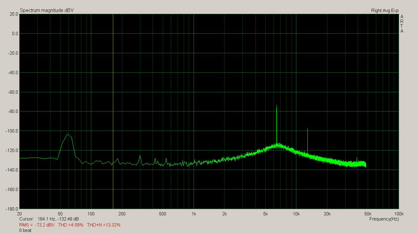

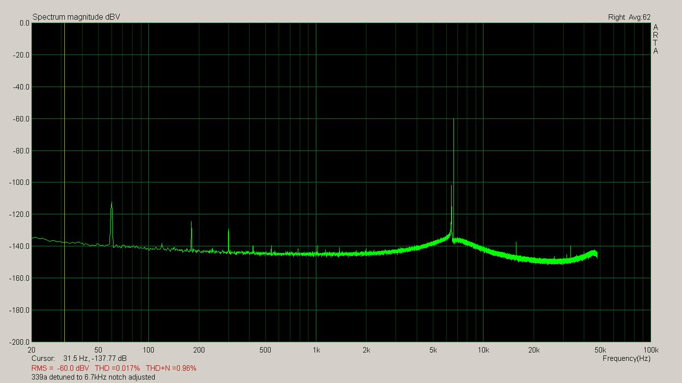

I've got the 339a osc running again. here is a little experiment.
The agc of the SVO is disconnected and replace with a 9V battery and pot to control the Vc of the multiplier. A 10:1 decoupling is used to inject the 339a into the inverting node of the summing amplifier of the SVO. The Vc of the multiplier is adjusted just until oscillation stops and only the noise of the system is driving the resonance of the SVO. The 339a is connedted and tuned to the resonant frequency of the SVO as closely as posible. The ouput level of the 339a is increased to normalize a 1Vrms output from the SVO. A -60dB notch is applied.
Here are the results. The first pic is the 339a at 1Vrms.
The rest are labeled.
I'll repeat this with the SVO open looped.

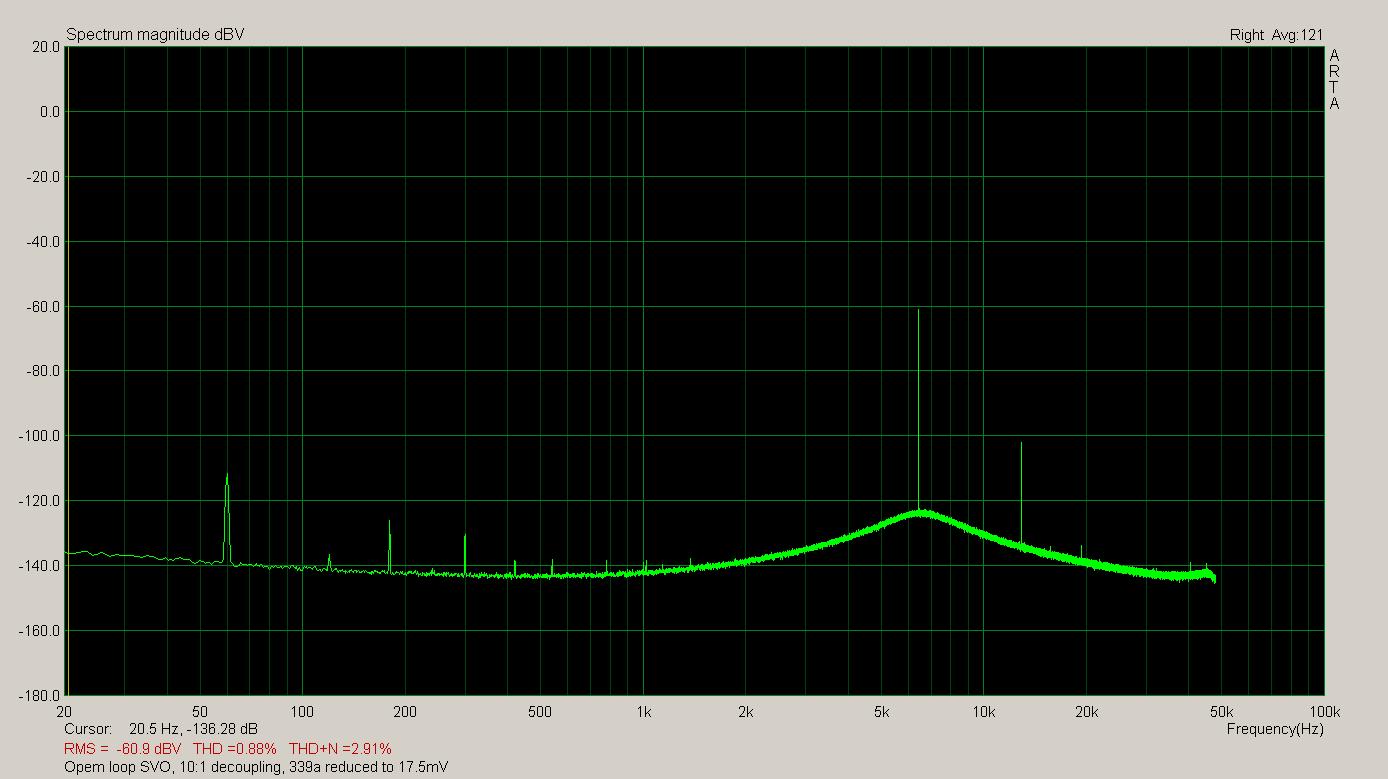

With all else the same. SVO is open looped. 339a tuned to resonance of SVO and 339a level reduced to 17.5 mVrms. SVO set to 1Vrms out.

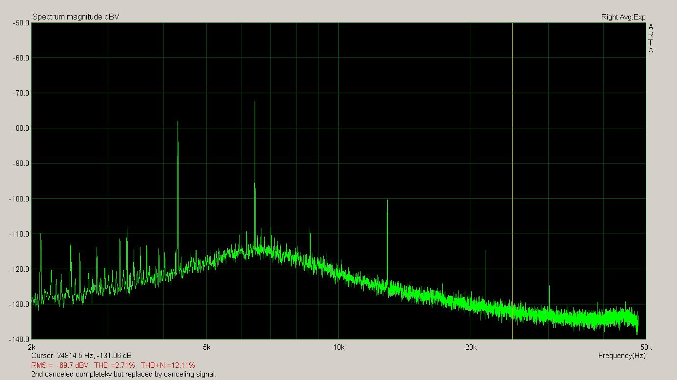

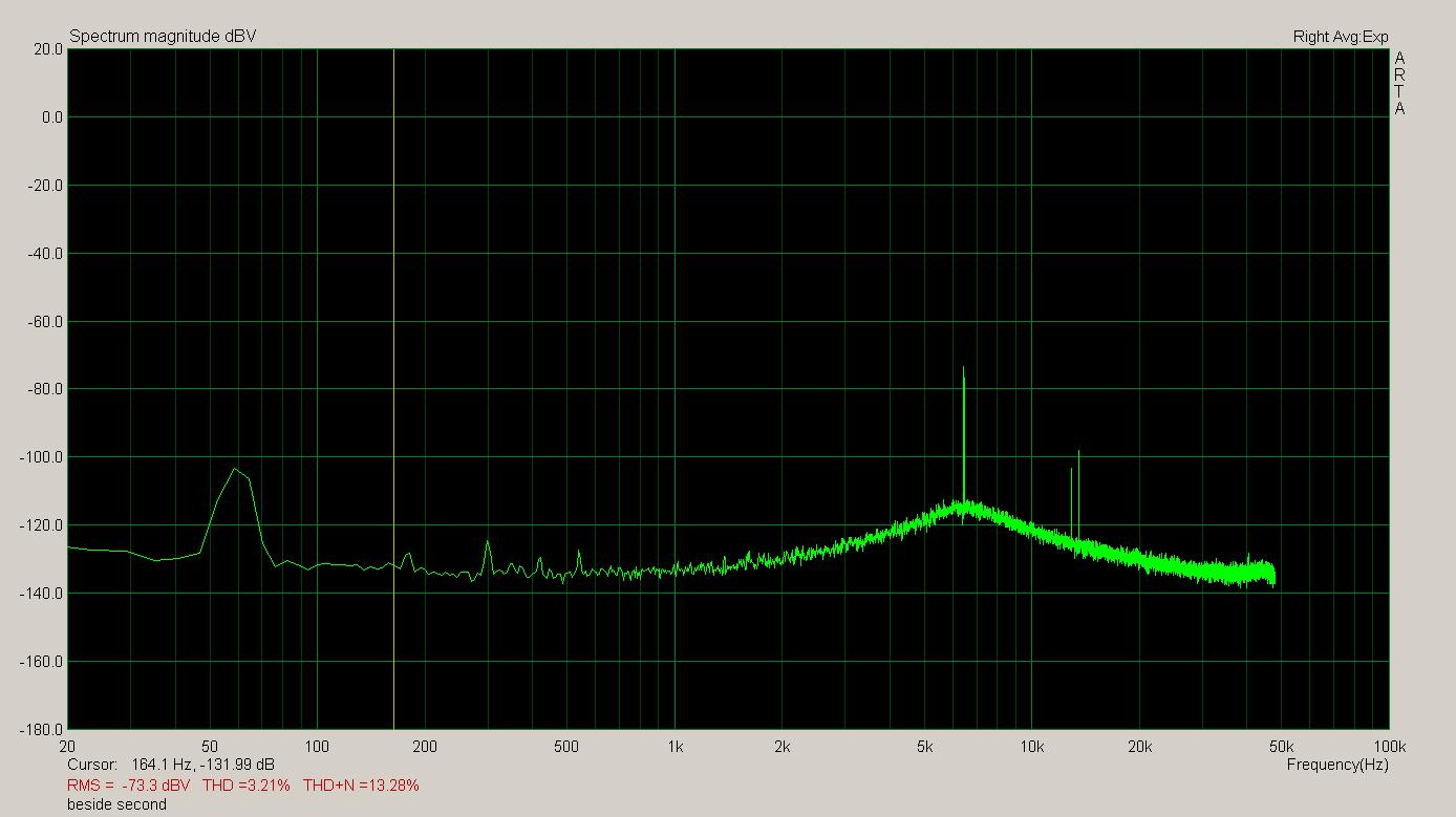

The canceling signal is injected through a separate resistor into the SVO inverting summing node.
I can add to the distortion quite easly and most cases this is what happened.
I reversed the polarity of the canceling signal and am able to completely cancel the 2nd.
However the canceled signal is replace by the canceling signal.
Canceling a distortion is like tuning a notch filter manually. It's miss most of the time.
It more likely a second source of distortion will add to the distortion unless the second distortion, (canceling distortion), is supplied by the source.
Edit: I did try canceling from the fundamental as well.

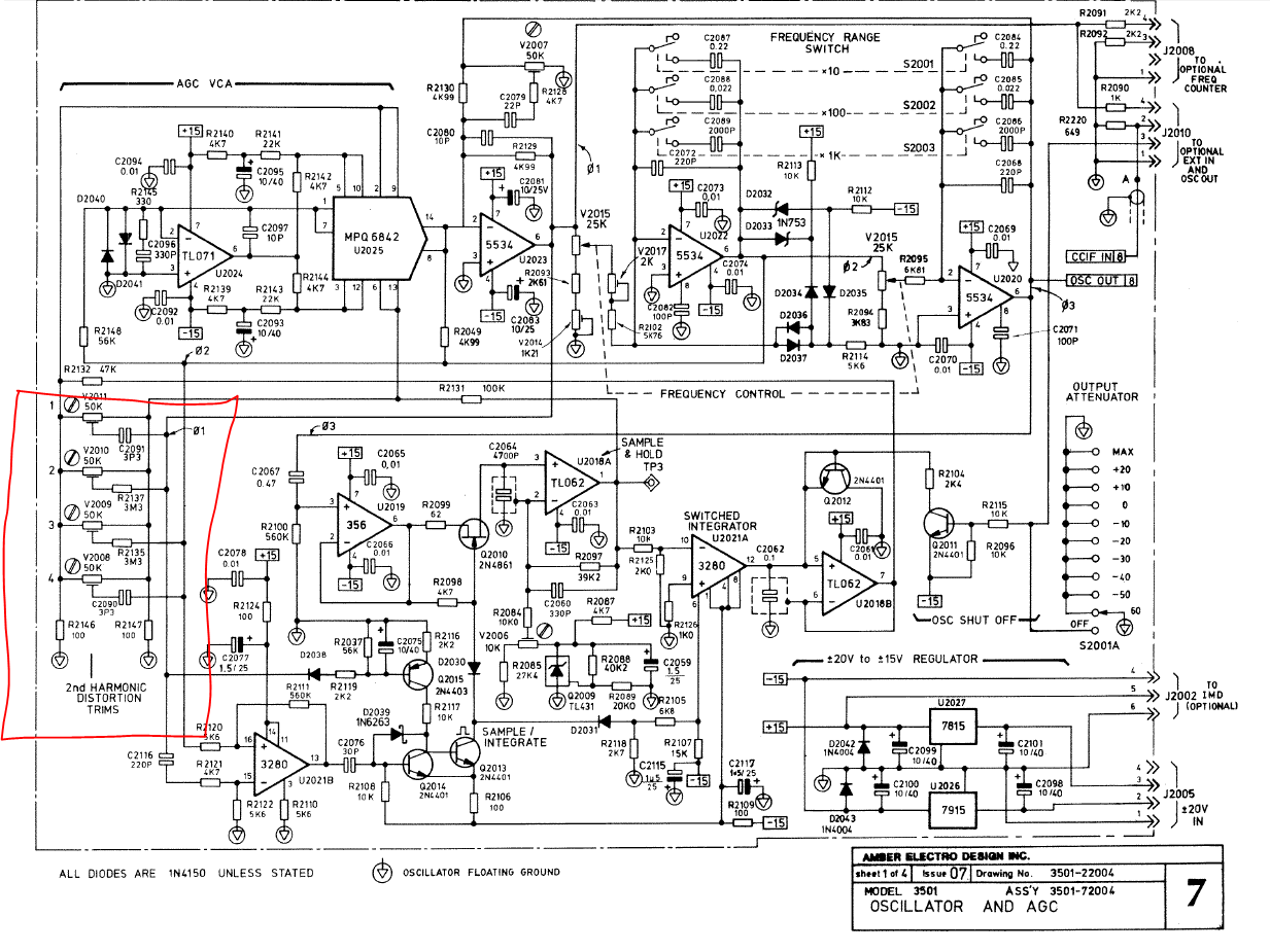

I posted this once before. The part circled in red is a second harmonic cancellation circuit in the Amber 3500 SVO. I see no reason why it couldn't be implemented in other SVO's. It feeds from two phases in just the right amount to cancel 2nd harmonics. I don't have a suitable platform to try it right now.

Seconds are secondary it's the thirds that are inherent in the gain contol process. This still might be useful.
Also, Hickman did 3rd cancellation by mixing outputs LP + HP/9 (Analog circuits cookbook, Hickman 1999)
The APF in post #1 does it too (yeah, that thing again) It can be gain tuned for a different harmonic.
The downside is it can increase other harmonics and increase noise, but it's good if you have a single very dominant harmonic.
