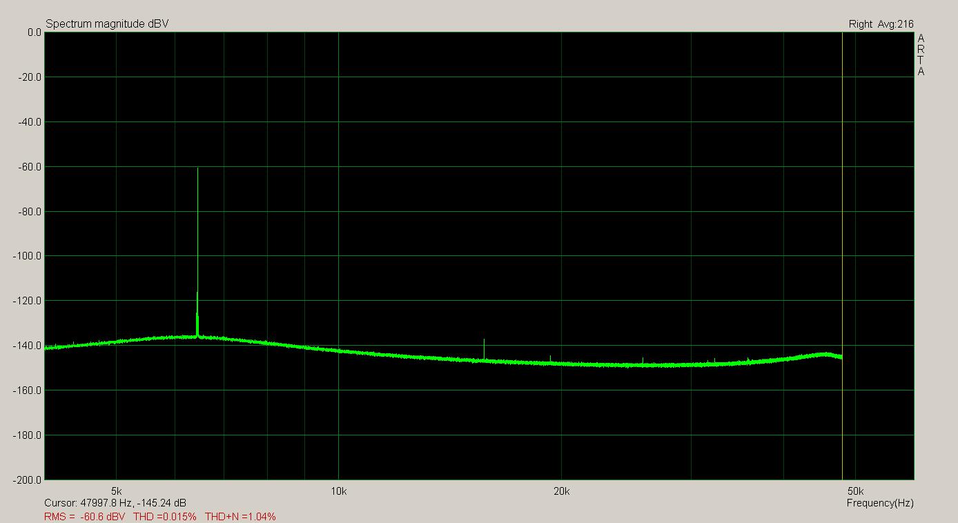

Yes I see this. It the relative improvement I'm looking for not so much accuracy of measurement. Even phase noise translates to amplitude change with a sampled servo agc.
The sample pedestal has to be in the exact position of the peak each sample.
There is a lot going on that can effect the amplitude. Sorting it all out is tricky.
If the servo is working right I should be able to blow on the lamps without seeing much disturbance.
There is a 3mV thermal modulation from the lamps at all frequencies.
It doesn't seem to show up as distortion though. The settling time from power up at 1Khz and up is less than a second and about 15 seconds at 20Hz.
This is 6442.4Hz at 3Vrms.
