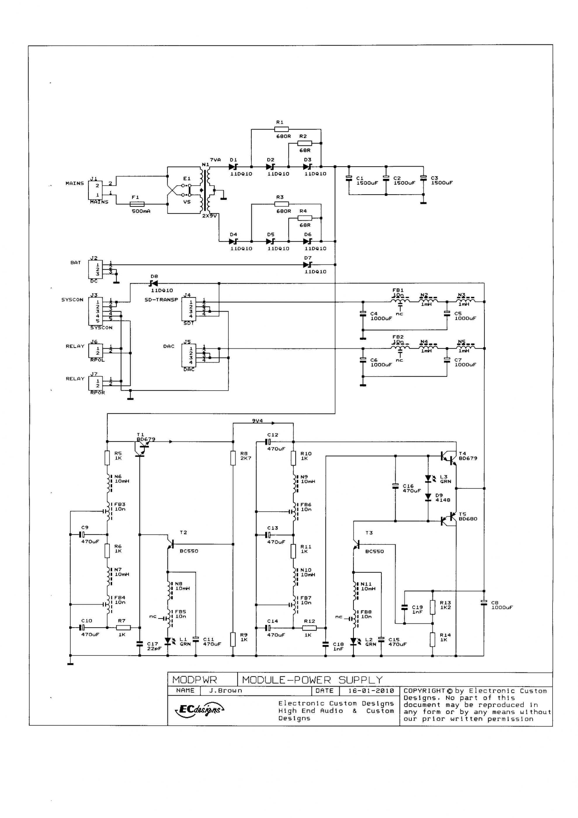

I attached full schematics of ISD player 5.4V main power supply. This power supply can run on both, mains power supply and external 12V battery.
Rectifier consists of a 3-stage stepped rectifier, conventional rectifiers, even Schottky, produce too much noise (peak charge current / back-emf) for these demanding applications.
T1 and T2 form a discrete 9V4 pre-regulator with a filtered LED reference (L1). T3, T4, and T5 form a discrete 5V4 post regulator with complementary output formed by Darlingtons T4 and T5. Bias is set with L3 and D9.
The filters in base circuit of T1 and T5 ensure clean base drive voltage.
Power supply dynamic response is fine-tuned with C17, C18 and C19. In order to achieve lowest possible grain, no constant current sources nor current mirrors could be used. The short feedback path ensures fast response. Transistors T2 and T3 are selected for low noise.
5V4 output voltage then passes 4th order LC filters that further reduce noise and interference levels.

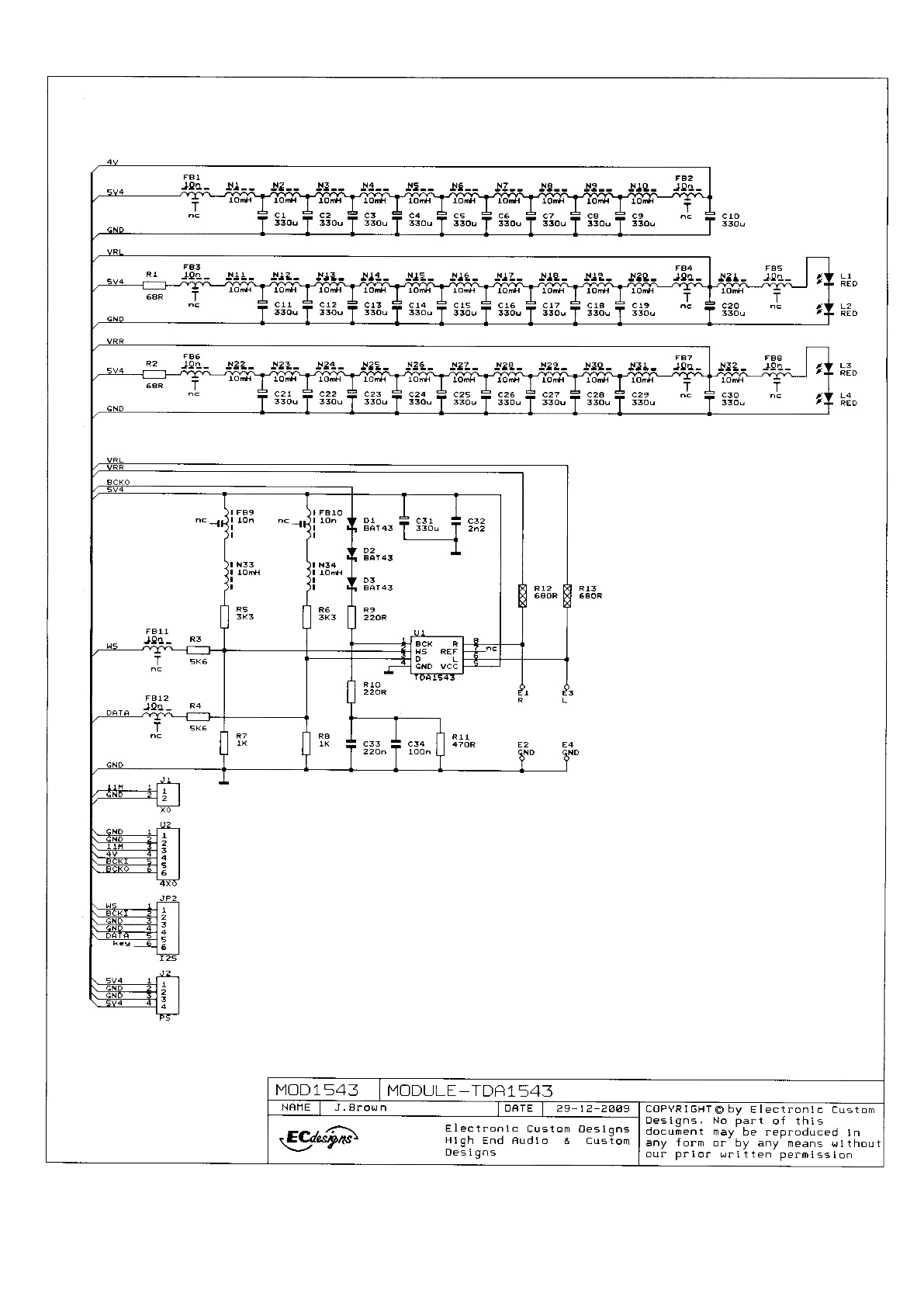

I added a second schematic diagram showing the TDA1543 DAC module, used in the ISD player (TDA1541A DAC module is currently being developed).
Upper 20th order LC lowpass power supply filter / current limiter (FB1 ... FB2) feeds the 4-crystal superclock and limits current (choke DC resistance). The 4-crystal superclock uses 2 filtered LED shunt regulators that provide +2v and -2V with respect to the reference voltage.
next two 20th order LC filters provide both L and R channel reference voltages (VRL / VRR). I used filtered LEDs as shunt stabilizer.
Circuit also shows I2S attenuators for WS and DATA, BCK uses a DJA circuit.
4-crystal superclock is indicated as U2 (4XO).

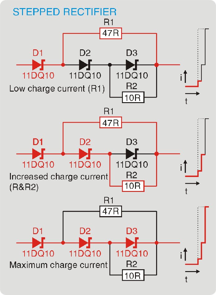

The stepped rectifiers solved the problem at much lower cost. Problems with charge transfer supplies are increased switching noise (peak charge currents), and increased ripple voltage.
The stepped rectifiers greatly reduce switching noise as they switch-on and off in stages. Single rectifier goes into full conduction after transformer voltage exceeds reservoir cap voltage plus diode voltage drop, and switches-off immediately (risk of back emf and oscillations) when transformer voltage drops below reservoir cap voltage plus diode voltage drop.
3-stage stepped rectifier starts with low charge current (series resistor #1, one diode conducts, step1), then increases charge current (series resistor #2, two diodes conduct, step 2), finally it provides full charge current (3 diodes conduct, step 3). Switching-off goes in reverse order, reduced charge current (2 diodes conduct, one is switched-off, step #2), lowest charge current (one diode conducts, two diodes are switched off, step #1), then it switches-off completely.
I use diode threshold voltage in combination with bypass resistors to achieve this (resistor already provides charge current when the diode is not yet conducting). One diode is not bypassed with a resistor, making sure current cannot flow in reverse direction.
I see that the Charge Transfer technique has not been included - is the performance unsatisfactory?

Hi John,
Thanks for your quick reply!
I coud find C19, but I don't see C17 en C18???
Interesting that you say that Current sources give grainy sound.
I found C18 it's 1nF, it looked in the picture like it was C10. And C17 found it in the stage before 22pF.

Hi Overm,
I use diode threshold voltage for switching between 2 or more different charge currents. Using 3 Schottky diode in series requires approx. 3 x 0.4V = 1.2V drop before all diodes start conducting.
When secondary voltage exceeds 0.4V plus voltage across reservoir cap, only one diode can conduct. The charge current now flows through a resistor, bypassing the two diodes that cannot conduct yet. When voltage exceeds 0.8V plus voltage across reservoir cap, two diodes start conducting. Third diode can't conduct yet, so current flows through resistors. When secondary exceeds 1.2V plus voltage across reservoir cap, all 3 diodes conduct, bypassing all resistors, providing full charge current.
So what basically happens is that charge current is increased and decreased step-wise (stepped rectifier). This avoids peak charge currents and possible back emf / oscillations.
I also attached a diagram that shows charge current flow at each step.
