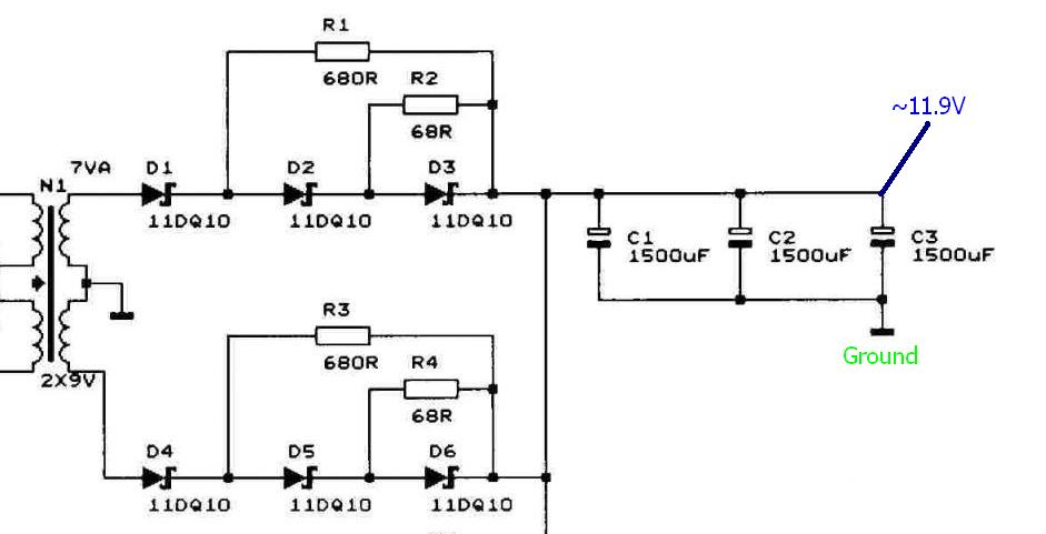

As for your 3-stage stepped rectifier, I just want to confirm with you that you are using it to replace a regular rectifier. A shortform of it will be as the attached?
I assume It can be used for almost any other circuits(amps, pre, CDP, etc) as long as the rectifier meets the demand of the circuit, right?

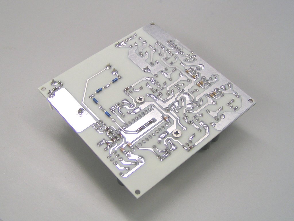

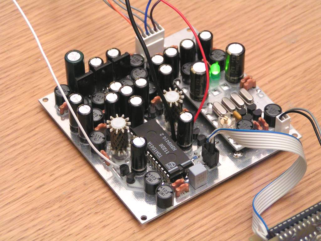

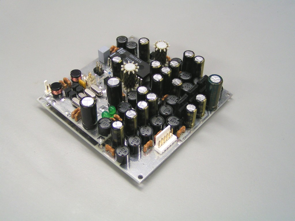

Well, why not have a look at the new TDA1541A DAC module that has just been completed. On-board voltage regulators and filters, can be connected to 3 x 12V batteries without any further power supply circuits. Module requires +10 ... 12V, -10 ... -12V and -20 ... -24V.
Extensive on-board power supply filtering ensures low noise levels.

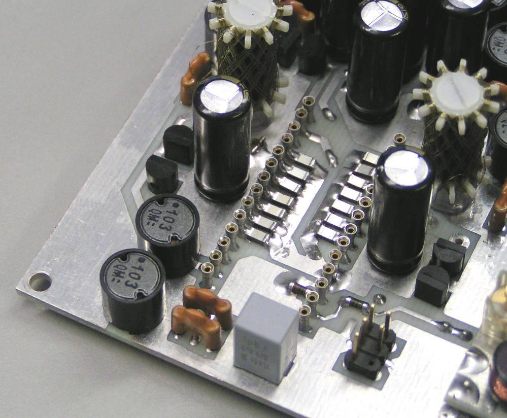

DEM capacitors (currently using 1206 NPO SMD) are mounted underneath the TDA1541A and decoupling caps of each channel have dedicated GND plane that connects to pin 5 (AGND). DEM clock uses R-D injector at 1.4112 MHz (= bit clock).
Output circuit uses Darlington stage to create external reference that allows pure passive I/V conversion (2Vpp across 500R) without the limitations of TDA1541A output compliance.
It has I2S attenuators and Dynamic Jitter attenuators installed.
4-crystal superclock / synchronous reclocker is located close to the DAC chip where it belongs. Clock output (11.2896 MHz) can be used to slave the source.
The compact module measures only 10 x 10cm.

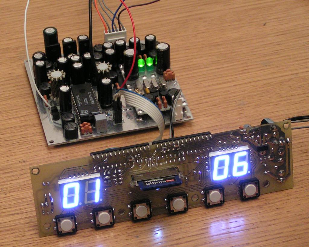

Second picture shows the TDA1541A module being driven by the SD-transport.

John, in the above photo are you using LVDS or other type of transmission between boards? If not using drivers, what is the max length cm that you suggest for DIYr who use dac board with the master clock slaved to transport board before SQ degrades? What kind of connectors are you using and why not twisted pair instead of flat ribbon?

Hi riotubes,
No I use plain 3.3V signals, I try to keep all (digital and analogue) signal paths as simple as possible. Drivers would add jitter and cause extra power supply pollution (switching currents).
It's always best to keep I2S interlinks as short as possible. I tested 1 meter ribbon cable I2S interlink and it works fine, though not advisable, but it shows the interlink isn't very critical due to 1.4112 MHz being the highest clock frequency used.
Biggest problem would be master clock (11.2896 MHz) that is required to slave the source. Jitter levels will increase with interlink length due to various reasons like increased (capacitive) clock load, and interference picked-up by interlink.
Practical interlink length should be kept between 5 and 20 cm.
I use sockets that match the 2.45mm pitch headers. Wires are soldered directly to the pins.
I tested twisted pair, ribbon cable and coax. I couldn't hear any difference in sound quality. I settled for ribbon cable connected as follows:
GND, DATA, GND, WS, GND, BCK, GND.
DATA is kept as far away from the BCK signal (sample timing) as possible.

Hi soundcheck,
The prototype TDA1541A DAC module PCB was just completed so I had little time to tune it. I didn't receive the required 33nF SMD 1206 PPS decoupling caps in time so I had to use 4.7nF NPO for testing instead. Power supply was a quick and dirty plain mains power supply that produced plenty of ripple voltage. Audio interlinks were over 50cm long and picked up interference. I also created a ground loop by connecting an external mains-powered device to the ISD player (I used auxiliary analogue input on the ISD player to connect TDA1541A DAC module). So it's obvious that the module wasn't performing optimally.
After installing the 14 x 33nF decoupling caps (picture), the TDA1541A module already performed better compared to the TDA1543 DAC module. There was better bass and more detail (refinement) similar to the breadboard prototype setup that already had 33nF film decoupling caps (leaded) installed. I also attached some other views of the new TDA1541A DAC module.
TDA1541A has different ripple rejection on each of the 3 power supplies (Philips datasheet page 7)
+5V, -76dB
-5V, -84dB
-15V, -58dB
-15V is most sensitive to power supply pollution, since I connect I/V resistors to +5V, this voltage needs to be clean too. The -5V (digital) power supply of the TDA1541A is not that critical.
