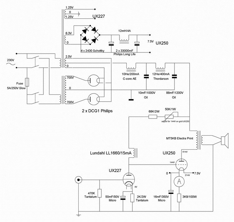

The schematic linked appears incomplete... seems they left out a filter cap for the 227 stage which is choke loaded. There should be a filter cap from the top of the plate choke to ground, otherwise you're just running the 227 with a resistive load.
Regards, KM
Hello Bryant,
Designing on paper and implementing are two different things. A closer look at the posted 50 SET reveals some other problems as well. I'm somewhat reluctant to think that this circuit was actually built... and if it was it's not final or probably doesn't perform very well.
All bias points and calculated values are lifted verbatim from the typical operating section of the 27 and 50 respectively and just joined together. The only variation is the OPT impedance... it looks to be a 5K load while the particular operating point published recommended 3.6K. I would suspect this design (as is) would barely output 3 watts.
Addtional problems, beyond number 0 below:
0- As noted previously... you would need to add a filter capacitor from the top of the plate load choke on the 27 to ground. Something in the neighborhood of 20uF would be fine.
1- AC input wiring is flawed. A 5amp fuse is far too large and only (seemingly) fuses the plate transformer. It's a moot point however as both switches need to be closed to get power to both transformers. Closing both switches shorts out the fuse... If the intended goal was to fuse both transformers and provide a "standby" switch, two fuses should be used (one for each transformer) and they should be properly calculated for values against the actual load.
2- The DC filament supply looks to be marginal... not for filtering but for output voltage. The voltage drop between the diode bridge and choke will probably result in an output voltage less than 7 volts.
3- The 27 input tube has low mu... about 9. Despite being choke loaded, you won't see a gain of 9 volts/volt... probably closer to 7 volts/volt. As a result, driving the input grid to 18 volts peak-to-peak will only output 126 volts peak-to-peak. It's also a bad idea to think you can drive the input grid to zero without having linearity problems. As a result, you will not be able to fully drive the 50 triode. End result is lack of full power due to insufficient drive and higher distortion due to the input stage being "on the edge".
Perhaps if the original source of the schematic was located, they may have done a prototype and changed the design in the process. I'm not a huge fan of direct-coupled designs... and the 50 is a difficult tube to drive, not due to it's input capacitance but due to the grid leakage. The original specification for the 50 triode was clear that RC-coupling was NOT recommended, hence transformer coupling. Later (revised) specifications show RC-coupling is okay provided the overall grid circuit resistance does not exceed 10K... which is pretty low and having a proper driver stage means something fairly beefy. In any case, you might be able to tweak the circuit a bit and get satisfactory results, but it will require higher B+ voltage, a shift in the input/driver stage operating points and you'll need to ensure you don't have any grid leakage which would result in a runaway condition on the 50 which would eventually burn it out.

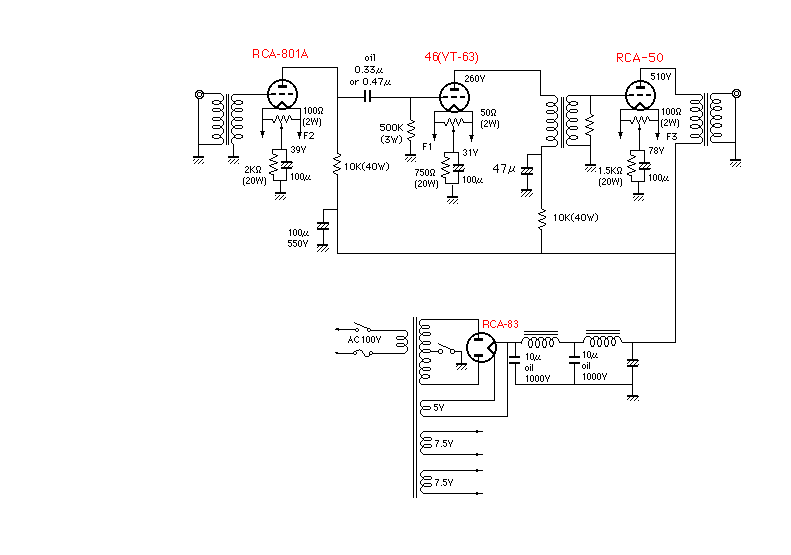

Kevin, et al,
At the risk of getting run out town for hijacking this thread, here's a preliminary design for an all-DHT 50 amp. The tubes were purposely chosen to voice the amp and balance out the darker sound of the 50.
Note that the power voltages are not optimized - this is a "paper design" little more than a cleaned-up sketch.
Enjoy,
-- josé k.

No hijacking worries.... looks like an interesting design... and transformer-coupled to the 50... very nice. Are you building this?? That means you have some 50 triodes, I'm envious! if you do build it, would love to hook up and take a look-see and a listen of course ;-)
Bryant,
Again, if you have the tubes by all means... build an amp. If had some, I would be inclined as well. My current 2A3 amp delivers 4.5-watts output with decent NOS 2A3s... my preference being Sylvania dual-section. But I agree, it's a pretty tube.
