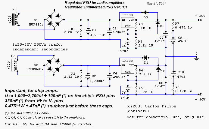

MKT vs. Ceramic SMD
I am eagle-ing my LM4780 SuperSymmetry with LM338 snubber. For the 300nf (connecting V+ and V-) and the 100nf (bypassing V+ and V-), should I use 1210 ceramic smd chip capacitors on the pins of the LM4780, or should I stay with the MKT type capacitors?

MKT.
100V rated for the 330nf (not 300).
The 100nf caps can be 63 or 100V MKT, which are small.
Put these as close as possible to the chip's PSU pins, as always.

Thanks Carlosfm,
Do you have any brand preference? I can get the Vishay from Mouser, or the Epcos and BC Component from Digikey.

I mostly use Philips / BC.

Hi Michael,
Yes, I would not use more than around +/- 25 V for the bridge version.
Before the regs you should not have much more than 10V headroom, so that gives you an unregulated voltage of around +/- 35V.

The tradeoffs can be found using National's interactive web-tool, based upon Excel. When you download it you have to "enable macros".
http://www.national.com/appinfo/audio/files/Overture_Design_Guide15.xls
In the bridged version, PdMax is 4X that of one chip -- this is because each chip sees a complete swing from Vee to Vcc.
I use a whoppingly big heat sink on the Bridgeclone -- and can get distortion stats which are nothing short of sensational.
Because this is an opamp on steroids there is a tradeoff between running the chip hot (with very low distortion) and "mean time between failure".

i would like to know if i change it to voltage variable. what values should i change to to r3 and r5?
What voltage do you need?
The formula is: 1.25 * (1 + R5/R3).
To make the PSU variable you could use 1K trimmers in series with 1.2k resistors in place of R5 and R6.
That would give you an adjustment between ~17.5V and 31V.
