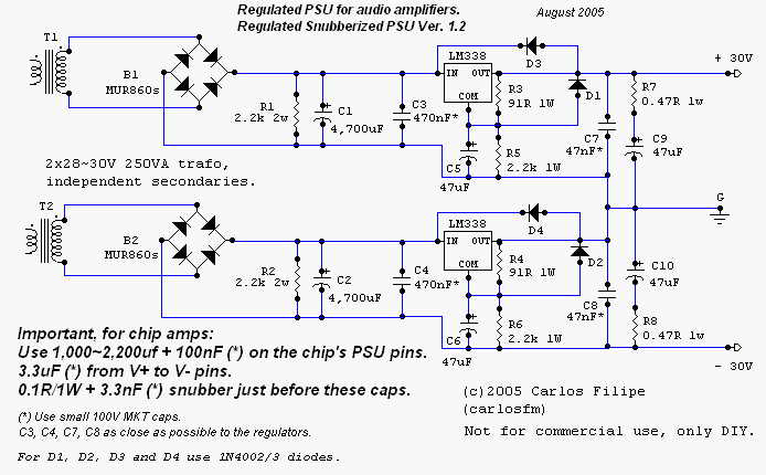

This is easy calculations if you understand how theese adjustable regulators works.
There is a constant voltage difference between the adjust pin and the output pin of 1.25 V. The resistor between adjust and output sets the current that goes throug the other resistor that goes to ground
If you use 91R between adjust and out, this gives you: 1.25 V / 91R = 0,013736 A.
This current goes throug the 1k trimmer. In worst case the trimmer is set to 1 K and gives you a voltage drop of : 0,013736*1000ohm = 13,736 V
Watt=Volt*Ampere. For this case: 13,736V * 0,013736 = 0,18867.
This means that in worst case the trimmer must handle 0,19 W. Some safety margin, and you are all set with a 0,25W trimmer.
It`s all about ohms law

I know that the goal of this PSU is to make it as high quality as possible for chip amps, but I'm looking for ways to cut corners a little in order to reduce price for a multi-amped system. The project includes 10 3886's: 3 stereo and 1 bridged stereo 3886 amps (based off of Carlos' Non-Inverting v4 design), so the total cost is adding fast.
Any suggestions to help reduce the cost, especially in PSU land, without hitting quality too hard? One thing I was thinking was consolidating the traffos. If so, what would it be acceptable to combine down to? (as obviously a single traffo would not cut it for a regulated design when this many channels are needed). Any and all suggestions are greatly appreciated. Thanks for your time.

I had my amp playing into a pair of 8 ohm 50W resistors for about 100 hours before I put it into my main system for some serious listening.
Even though, the amp has improved alot the last few days.
When I first listened to it, the sound was exellent, but you could sense just a little bit of "roughness" in sound sometimes. I thought this was because of my tda1543 dac wich sometimes can sound a little rough.
But now the roughness is completly gone.
It might have been that the rest of my system needed some burn in time. It has not been used much during the summer.
Carlos:
I will try your new output stage.
But I have to wait until I have modified my speakers for biamping.
For now, when paralelling two chips, I need the output resistors.

Ok, and try the new snubber values on the chip.
Did you find where to buy the 0.1R resistors?
Btw, I suspect you will benefit from biamping instead of paralleling chips, as you have now.
Yeah, I never thought a single LM3886 could get to this point of driving my speakers in perfection, but it does.
So much talk about damping factor and output impedance around here...
The PSU is essential for a good amp.

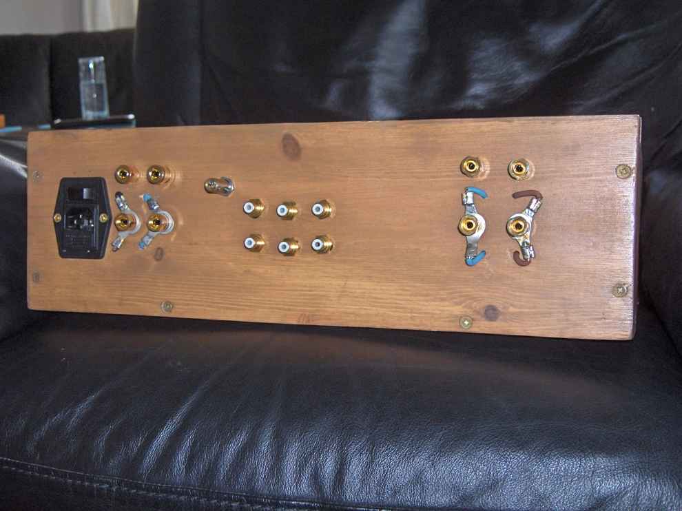

I made my amp such as I could change between parailell and single chip mode in a minute without soldering.
Listening to single chip now. The soundstage is even more holographic and the sound is a little cleaner with more details.
I`m going single chip from now on!
But I suspected this. The plan for this amp has always been biamping, not paralelling. Don`t think my Epos needs paralell chips with a minimum impedance of 7,2 ohm, and this in the trebile.

peranders said:Take 1 ohms metal film, 0,6 watts, 10 pieces but I'll suspect 5-8 will do The power in this position is zero, microwatts.
Yes, thats what I use today, 2 pieces 1 ohm 0,66w metalfilms to get around 0,47 ohm.
But paralelling 10 of them I think will take to much space for easy implentation.
Tor Martin
Tor M said:I made my amp such as I could change between parailell and single chip mode in a minute without soldering.
There's always something to be lost when paralleling devices.
Glad you like it.
Now, before the resistors arrive you have something to entertain: adding another pair of binding posts to the Epos ES14 speakers.
