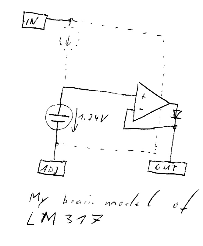

And the picture might help to explain my simplified understanding of
the LM317. I don't care where they run their idle currents as long
as they manage to keep it low.....
Not a nice picture, but it was faster than with ORCAD.

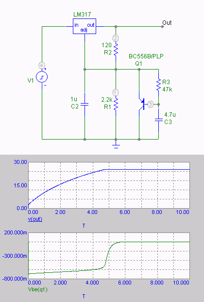

Fred Dieckmann said:is just a slow start circuit (which indeed does function as a slow start circuit) as outlined in the data sheet. No one's competence (well ... no engineers at any rate) has been called into question by me.
Wow, 180 degree turn around, . Sounds like you are in strong, no complete, disagreement with the person who said the following:
It is not a soft start circuit, which is more easily achieved by putting a cap across the resistor from the adjustment terminal to ground. The concept of the circuit is fine but the implementation is wrong.
"Not a soft start circuit", "implementation is wrong". Sounds like pretty incompetent to me.

I was building this soft start regulator with LM338 (12.6V/3A) and LT1085 (6.3V/1A) for tubes heating supply (6C33, 6SN7,6J5) in my new tube amp (not finished yet). Soft start circuit works.
With 100k/10uF release time is around 2-3 sec. Just what I need.

moamps said:Soft start circuit works.
Regards
Thanks, moamps. It is the 2nd real life confirmation that the engineers at National didn't implemented it wrong, contrary to some expert's view.

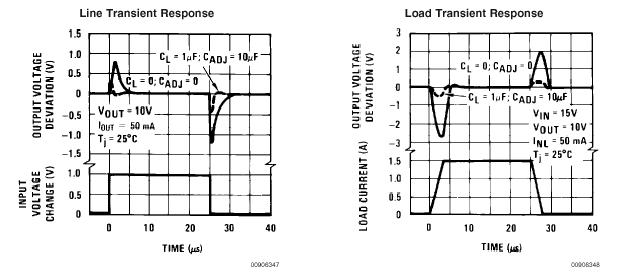

Pedja said:And as I said, there was certain difference in sound with and without it. Does anyone know why?
I would venture a guess on the lm317.
it seems to me that its transient response isn't too good, from the datasheet. so during peaks, its output may go down too much, vs. using a straight capacitor.
Not sure tho. if that is what contributed to your sound differences.
