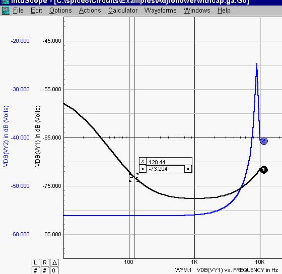

Great looking chart Fred you have there.
Pity that they aren't for the right circuit,
Fred Dieckmann said:The output of my simulation below:
Talk is cheap.........

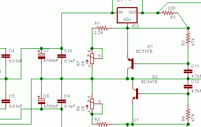

What circuit are we talking about
R7 is 47K and corresponds to R5 IN THE CIRCUIT IN THE FIRST POST OF THIS THREAD........ YOU KNOW..... THE CIRCUIT THAT THIS WHOLE THREAD WAS ABOUT.
If we are now talking about a different circuit let me know what it is please. This thread is one again drifting away from the technical issues
into nonsense and I will keep dragging it back as long as it takes....

Results with 10uF ADJ cap bypass. The model is the same as the one show earlier with slow start circuit replaced with circuit with cap across 2.4K resistor. The two regulator circuits are identical except for cap. rejection went from 56dB to 73dB at 120 Hz

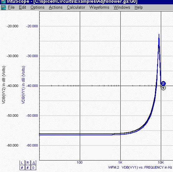

Yes Fred. Nobody refutes the fact that a cap from ADJ to ground improves ripple. The question - as originally stated - was if Slones circuit improved ripple rejection further, in addition to being a slow start circuit.
So, pray tell, how is R5 in the original circuit connected? And how is your R7 connected? Is there a faint chance they might differ?
I just want you to run a simulation on the same circuit as Millwood, but you'll have to actually look at the circuits!
Rune
Rune
R7 connected to ADJ instead of Vout
If you guys would stop being cryptic and say what the difference is.
Moving R7 to ADJ where it should be gives a about a 0.4dB difference due to the 47K impeadance being in parallel with the 2.4K resistor as the capacitor impedance decreases with frequency. The transistor is turned off in either circuit version and it offers no improvment as a follower. You would be better off putting the cap across the 2.4 K resistor if you were look to improve the perfomance of the regulator.

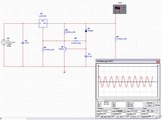

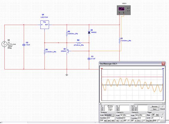

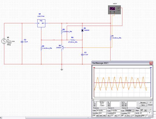

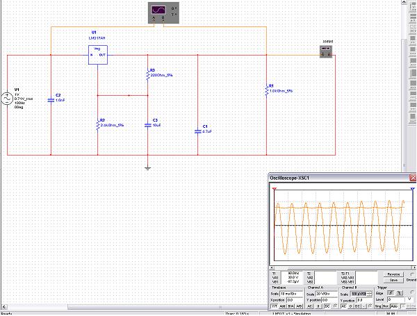

Re: Re: Thanks for the sim! This is great!
now, here is a new chart. I put the ground probe on the emitter of the bjt and the B channel probe on the base of the emitter. so now B channel shows the be junction voltage.
it is about 4mvpp.
so Steven is right: at steady state, the BJT is essentially take out of the circuit and it will not impact ripple rejection.
My prior (substantial) improvement was due to reading the wrong ripple (on the base of the bjt). sorry for the mistake.
millwood said:On Steven's question, I didn't look at the steady state to see to what extent the transistor is conducting (i tend to agree with you there). I will poke around more tonight.
it is about 4mvpp.

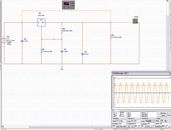

millwood said:without Cadj: 4mvpp
with a 10uf Cadj: 0.4mvpp
the soft start circuit: 25uvpp
so this table should really read:
without Cadj: 4mvpp
the soft start circuit: 4mvpp
Does anyone have any doubt about if the soft start circuit is incorrectly implemented?
