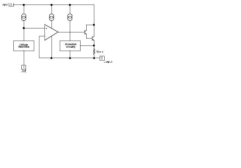

janneman said:It can only regulate if the output deviations, caused by the varying output current through the non-zero output impedance, is somehow fed back as information to the input of the error circuitry which is at the adj pin. With a cap, that info doesn't get there.
is it possible, Jan, that the regulator doesn't work the way you think it does?
janneman said:It does a great job keeping out ripple, but it doesn't regulate.
I don't know, Jan. I thought a regulator is there to kee ot the ripples. can you find a regulator that leaves ripples in place?
janneman said:So, to answer your question: the one with the 4mV is the better regulator.
that might be a nice business: to make regulators that have lot of ripples,
janneman said:With the cap, it basically is a voltage follower, which has been confused with a regulator more often on this forum than I care to remember.

Re: Back to the origional question.........
My reasons for starting this thread here were the following, in decreasing order of importance:
And just to set the record straight, I was not looking for a slow start or slow turn-on circuit, though I now realise that it might be a nifty fringe benefit if I can get it. Nothing in Randy's book, or in my email exchanges with him, ever mentioned the term "slow start" or anything like it.

millwood said:is it possible, Jan, that the regulator doesn't work the way you think it does?[snip]
Could Millwood, not janneman, have been right all along?
Hi Millwood,
Well, I have to admit, after doing some more headscratching, that I probably wasn't right about that cap. Let me give you my reasoning, see what you make of it.
If the output let's say goes up, and the delta between output and adj is constant (1.25V I guess), and there is impedance in the adj leg, the adj goes up with the same level as the output. That doesn't bring the output back to what it is supposed to be. There's no regulation here. So far so good.
Now we put a cap on the adj, so the jump in output level is absorbed (shorted to gnd) so the adjust stays as it is, and the output tends to go down back to where it was.
Agreed?
Jan Didden
Since I was the one who brought that up, I found a very clear graph in the datasheets which tell me impulse load regulation improves with a cap. Like Millwood, I tend to think the datasheet authors know their stuff, so I guess that's how it works. It's visually confusing, since it really looks like a low pass filter in the feedback loop. Just goes to show you can't always trust instinct...

you got it right, Jan. the key I guess is to hold the voltage on the adj. pin constant. By doing that, you indirectly hold the voltage on the output pin constant -> regulation.
EVA's chart is very illustrative of this.
regulation characteristic
I am still sticking to my simplified brain-model.
Please do not misunderstand me wrong, I love PSpice.
But normally I make up my own brain model first and then
check the opinion of Spice....
Happines comes when both match somehow AND
reality proves it in the end. (Sometimes reality does
not care about my thoughts... )
My simple model brain model of the L317 is the following:
-Floating regulator
- It regulates the output 1.2V above the adjustment pin,
no matter on which potential both are.
-Internal structure can be modeled by a floating
band gap reference (or any other precise reference) followed
by an power OP amp (unfortunately without much sinking capability) which is connected as a voltage follower.
-Current into the adjustment pin is small.
Coming from this the resistor from the output to the adjustment
pin will statically work as a current source.
I will try the dynamics in brain.
-Load current jumps to higher value:
==> As the regulation has a limited speed, the 1.2V will
decrease. May be to 1.19V (depending on load and open loop characteristic of the internal OP amp. The current through the
resistor from the output to the adj-pin will also decrease.
If there is no cap across the resistor to ground, then the current
in this resistor will decrease in the same proportion. And the voltage
between the adj-pin to ground will also decrease.
==> 14.875 V output until the regulation can correct the thing.
Now let's add a capacitor parallel to the resistor towards ground.
Let's think it's a big cap.
OK, the jump in the output current will decrease the 1.2V to 1.19V
again. The current in the resistor between output and adj will decrease in the same way as above. But the voltage from
the adj-pin towards ground will not drop much.
==> about 14.99V output until the regulation corrects.
In reality you only need to chose a cap which makes the
moving of the adj-pin slow compared to the regulation
of the LM317.
Do I think to simple?
For input voltage regulation I do not have a proper brain model....
I just think: It is good
Sorry.
Cheers
Markus

Are You Experienced? ;-)
Hi ,
After 100 confusing posts may I quote from Horowitz?:
These wonderful ICs are typified by the classic LM317 from National. This regulator has no ground terminal; instead it adjusts Vout to maintain a constant 1.25 volts (bandgap) from the output terminal to the "adjustment" terminal. Fig.6.29 shows the easiest way to do it. [showing R1=240 from output to adjust and R2 =pot of 5k from adjust to ground/EK]
The regulator puts 1.25 volts across R1, so 5mA flows through it. The adjustment terminal draws very little current (50-100µA), so the outputvoltage is just
Vout =1.25(1+R2/R1)volts
In this case the output voltage is adjustable from 1.25 volts to 25 volts.
And one page further:
Improving ripple rejection
The circuit of Figure 6.29 is the standard 3-terminal regulator, and it works fine. However the addition of a 10µF bypass capacitor from the (ADJ) terminal to ground (Fig 6.31) improves the ripple and (spike) rejection by about 15dB (factor of 5 in voltage). For example, the LM317 ripple rejection factor goes from 65dB to 80dB (the latter is 0.1mV output ripple when supplied with a 1V input ripple, a typical value).
I addition I may add that no one less than John Curl provided a circuit for the powersupply of the JC2 or ML-1 Mark Levinson preamplifier with 100µF at the adjustment terminal with LM317/LM337. This circuit, which I also builded sounded better than the extremely complicated (and expensive) PLS-150 supply made by ML for the ML-1!
Now what is all the fuss about?
