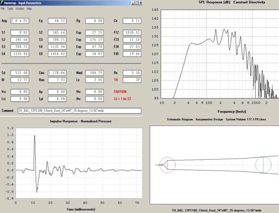

12PS100 Dual for FlipC
Hi FlipC,
Thanks for the additional information and pictures.
I'm attaching the Hornresp model and the drawings for a Dual 12" box using the B&C 12PS100. I tried to design the horn into a fixed 23-7/8" x 48" x 15" box for easier wood cutting, and better wood use. I also tried to keep the funny angles, and little support pieces to a minimum. It turned out to be a bit more difficult than I thought it would be, and the details for the driver mounting will have to be worked out with the drivers in hand, e.g.: final sizes of driver mounting plates and support pieces.
Let me know what you think.
Hi FlipC,
tb46
how are you going to accomplish your desired compression, on your Dual 12 TH.
I'm not sure if your planning on making a Karlson Coupler style slot in front of one of them. But I'm pretty sure you want even loading on both of your drivers. Which looks unlikely in that layout.
I don't think that Horn Resp is really capable of accurately modeling what you are proposing to build. You may be able to come closer with AKABAK.

Hi sumsound,
You are correct, Hornresp does not provide for the complete modeling of this enclosure, but it provides for exporting of the Hornresp model into AkAbak. At the low frequencies involved the distance from driver to driver is so small, that they basically work as one. That fact allows Hornresp to be used for modeling. You will have noticed, that the S2 and S4 points are half-way between the drivers. I believe that the model is just as accurate as the model that has been used successfully for the THSpud, which has a similar driver arrangement. I reduced the S1 area over the one used in the THSpud, but it would make sense to make the filler block removable (the one that closes off the lower part of the S1 to S2 section of the horn). That way one can experiment .
Please see:
http://www.diyaudio.com/forums/showthread.php?threadid=134369
There is no need to reduce the entries of the driver outputs into the horn. The cross-section of the horn provides for the necessary compression and coupling. It would be interesting to investigate that subject in depth; e.g.: introducing throat chambers between the driver diaphragms and the horn. This could be done in AkAbak. The resulting models would then have to be build and measured. The concept of removable mounting plates provides for just that. There has been some modeling done in the "Collaborative Tapped Horn" thread. It was around the same time when Cordraconis posted his "AkAbak Th's for Dummies", Post #1187 (and, should he read this: thanks again).
Hi sumsound,
Please see:
Hi sumsound,
Hornresp takes care of the driver related changes for multiple drivers. The individual horn sections are so short, that the best you can do is get somewhere close. I draw the section height v. path length, and then measure (using ACAD dimensioning tool) the section heigt at the path length to e.g.: a corner, or other point of interest.

tb46
I will start modeling this in Sketchup.
I like the design. After my test box I through out that thought process and was looking at the SPUD layout myself.Give me the week to get this done as I need to finsih off the Mini Clone to boot.
Also on the very first box I built
I made it so I could change the throat relatively easy. Speaker baffle mounted to another one that mounted into box. Cheap OSB box.
I choose final from my ear.

Post #654
Hi FlipC,
Time just flies, doesn't it? I agree that it is important to give oneselves as much flexibility as possible in a test box, particularly in the throat area of the tapped horn. As an aside, when you replace the two 12PS100s with four 55-2421s you end up with a similar response, and they actually fit .
Hi FlipC,
