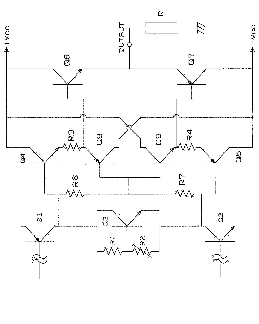

Someone have more info on the Technical Brain TBP-Zero amp. Its regarded as another of the significant amplifiers of all times and as being an even better amp than the soulution ones. "Its excellent performance is due to the elimination of emitter resitors and is also patented according to articles.
I havent been able to locate any patents attributed to its designer in this respect in either EU, US or Japan itself. Anyone have more info ??
Japan Patent 4284102

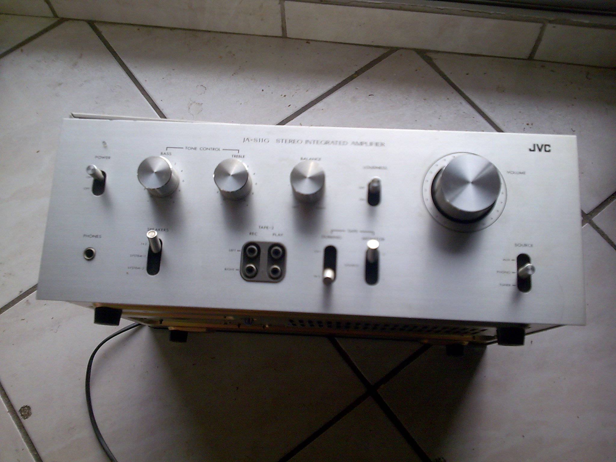

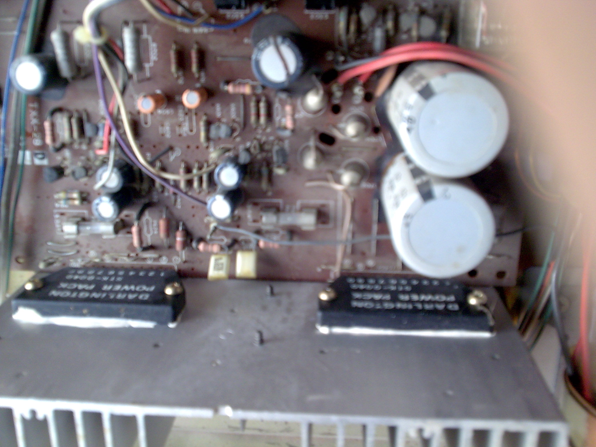

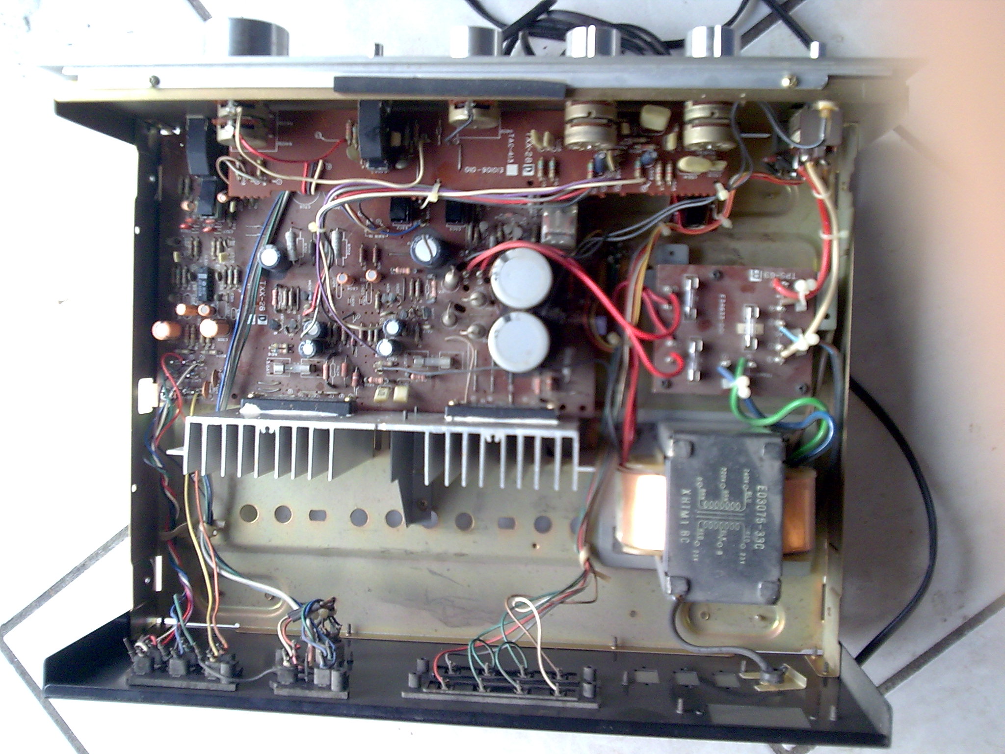

In the mid 70s JVC did sold an amplifier the JAS11G that was using
Sanyo s Darlington pack STK0040.
These have no internal emitter resistors and JVC didnt add external ones,
just connecting the emitters directly together.
I did find one at the local scrapeyard one day in good shape
a few years ago...
Once at home a rapid examination of the beast and the harsh
crossover THD showed that one channel had one of the two
output device that was definitly open circuit.
The second channel did work , though.
That s even surprising that it managed to survive at least 30 years
before its owner did throw it surely because one channel did fail recently,
but it s worth mentionning that these output modules have integrated
VBE multipliers that can track the thermal variation quite faster
than usual heatspreader fixed separate T0126/220 devices..

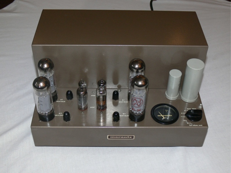

My Brother in Law Bruce had a dear friend pass away - and his wife said that he wanted Bruce to have this old beat up tube amp that needs the capacitors replaced and a couple of new tubes. The original owner had always meant to get around to doing it but never did because he didn't know electronics.
So now my B-i-L Bruce has asked me to help him out with things. I'm very tempted to tell him that I'll give him $50 bucks for it and use a couple of the tubes. Sadly - he may not know beans about electronics - but he does know his amps - so trying to con him out of this amp won't work.
This is an old school - boat anchor heavy - Marantz 8b
The 1st photo is just something off of the internet and not one of the amp we are working on.
The 2nd photo shows Bruce's 8b - there is gonna be a lot of fun playing around with this one.
