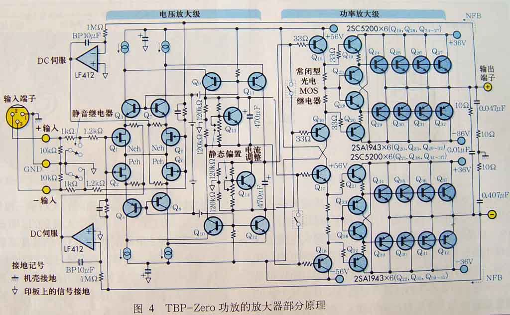

Did you know more about TBP zero? is it hybrid?
Audio is more of a hobby than anything else, I dont make my living from it and I refrain from being too involved in what I consider a very difficult market dominated by audiophoolish poets.s. Investing works good for me as it enables me to gain access to measuring equipment, parts and I like to throw some ideas at design. Maybe a little before retirement I will give it a try fulltime but only if I have a healthy bank account.
The little info I have is what the members have brought forward here, interesting concepts. You can however view the outputstage patent via a japanese patent search, Stinius has provided the patent number and the site has translating service.
The most confusing part is no feedback but voltage stages dont use emitter resistors either (degeneration), this is impossible with SS, I wont comment on tubes as I dont have experience with them.
This is how the TBP-Zero is supposed to be designed. Is it just a waist of time?
" ... he made it possible to eliminate emitter resistors by developing an original duplex
temperature compensation circuit (patented in Japan)."
I saw somewhere possible solution how to avoid the emitter resistors, it was based on using a power transistor, same as those in output stage, located just near output transistor. Such a transistor acts as a sensor and affects output stage idle current.

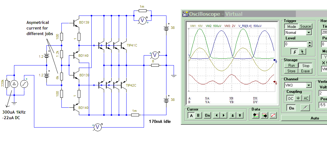

SEE THIS!!!
The claim of no emitter resistance is just fakes, it still work fine with RE. He uses long cables to make some fake RE, so RE is still there.
THIS patent is about non switching mechanism. Using BTL, and feedback is the key to reach low distortions.
Someone that interested in non switching will also interested in this.:D
