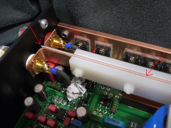

Looks like the dielectric has low permittivity. If it teflon or PP or PE, it should not reach 10nF, may be around 1nF.The Soulution amplifier uses a "home made" capacitor across the output terminals. I suppose the benefit of this design is to have a non inductive capacitor and to stabilize the amplifier under different load conditions.
That configuration is also not work as zobel, but work if they using current based error correction (voltage NFB need zobel that using resistor as voltage damper but current NFB may not). May be they has current sense at the OPS inputs, or it is really open loop as measured output impedance is around 0.06ohm. I am going to try with correcting input current.
Edit: I forgot that it has zobel output, There may a feedback applied as in D400, or not?
Maybe this is a better view. The white film works as a dielectric.
That looks like it's for insulation between the output bars, looks like delrin insulators. how would using such work as an shunting cap..? high frequencies..?
If so the thickness would make a difference ...? yes..?

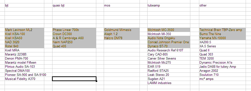

Harman Kardon Citation Sixteen 16, can add it to list of vintage amplifiers....
I agree, the list should collects vintage amps in vintage list. I also planned to add famous/infamous tags, but I am just too busy right now, with prototyping my new N3 buffer and my friend at BSN also demanding low ripple HV generators for his measurement tool.

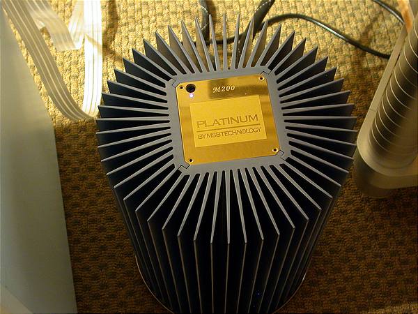

MSB Platinum M200
Who have heard this amp?

Don't know but the heatsink has some problem with dust. I think it is better using helical bubble/sunflower style than radial needle.Who have heard this amp?

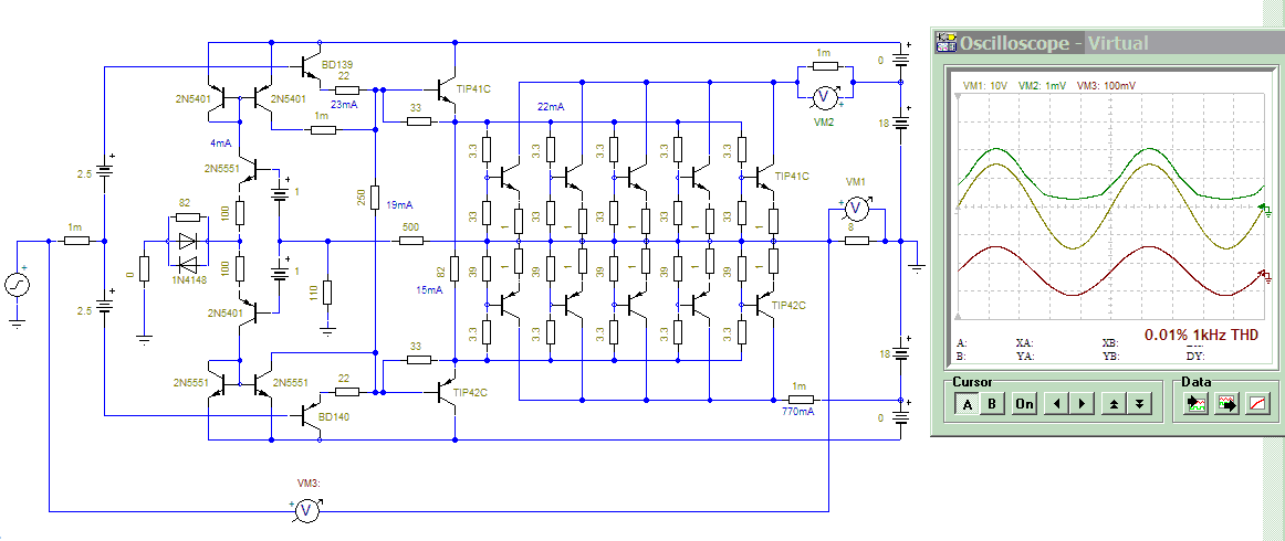

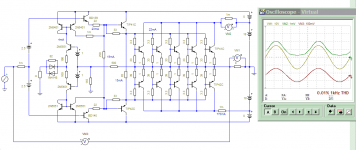

It is my sim of soulution inspired d400, non swiching, no feedback, 0.01% THD, @ 770mA bias (enriched).
May be different with the original but it is good achievement for nonswitching mechanism.
