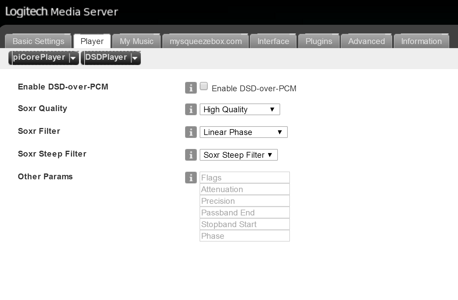

As far I understand I should be using DSDplayer plugin for LMS, then I should prevent player (squeezelite) to attempt playing DSD files in native mode as it should use DoP. (for doing this I need to add -e dsd option for player setup) - and then in the settings of Player in LMS make the DSDplayer active and set to use DoP.
All this didn't give me needed results...
It's strange because I shouldn't be using any pluigins as version 7.9 of LMS comes with support for DSD and only thing I should do is to use -D in the player options as per your post (picture) - but it didn't work.
Maybe I have to use picore player then instead of Max2Play...

OK - I see the detail I didn't check before - the Enable DSD over PCM box is not ticked but the other settings are - possibly this is the problem - we'll see tonight.

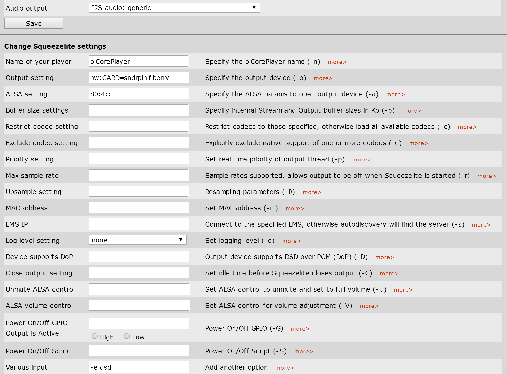

Could you let me know how did you set up the DAC in /etc/modules ?

I'd just thought I'd post my fix for playing RPI3 - I2S - DAM1021
After receiving my brand new 0.02% version and hooking it up to the isolated i2s using the RPI's 3.3v, GND , LRCLK, BCLK and DATA Volumio 1.55 or 2 would not work. All the while keeping the input selector to auto.
Loaded Runeaudio, enabled i2s (via ssh to edit the /boot/config.txt file) and selected hifiberry i2s DAC.
This is fine playing 24/44.1 files like MP3 and the streaming radio but would not play anything else blow 24 bit. It played 24/96 flac fine but would not play any 16 bit flac or wav's.
Eventually I found this:
I2s using hifiberry dac pro raspberry 3 : Raspberry Pi • RuneAudio Forum
where you edit the /srv/http/db/redis_acards_details (I edited the Hifiberry line not the hifiberry DAC+, just depends on which you enabled to begin with) and force it to upscale everything to 32 bit (I think).
All my flac now plays.
Thanks for sharing. RPI3, if updated/upgraded to latest spec kernel uses device tree overlays and disregards the old 'manual' workaround. New rules for this Linux release.
Easiest way to get it to work with DAM1021 via i2s is to comment out everything in /boot/config.txt and add dtoverlay=rpi-dac to bottom of file. While you're there you can reduce the gpu memory allocation to 16 if you're using the RPI3 strictly for audio. You may need to download the dtoverlay for rpi-dac from github and put it in the /boot/overlays folder - check if it's there on your distro.
That said, I am using Voyage MPD for RPI. Plays all sample rates and converts DSD to DoP (max 192, an RPI limitation) on the fly. Comment out dsd_usb "yes" in the audio output of /etc/mpd.conf to enable on-the-fly DoP conversion via i2s.
If you're using an USB-i2s converter (as against the direct RPI i2s out) don't comment the dsd_usb "yes" out. If you're using both an RPI and a USB-i2s board set up two audio outputs in /etc/mpd.conf; one with device. "hw:0,0" (and the dsd_usb line commented out) and the other as device. "hw:1,0". Leave the dsd_usb "yes" line uncommented in the latter....but you'd prob. know all this if you're already using two i2s inputs to the DAM so apologies for wasted words.
