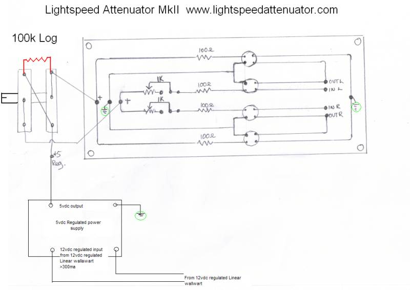

Alazira. I have added 20R as you suggested. That gives me a fully useable sweep of the pot.

I experimented with a lot of different values. Oddly enough 1K made very little difference, 10R too much attenuation, 20R getting there. I think I will try 30R tomorrow.

Eh, sorry can I just ask here.... are you adding the 10R, 20R or 30R in the 5V feed to the pot or are you adding a resistor before each LDR (or even pairof LDRs)?

I added a 100R to the 5V feed and kept the 100R into the LDRs (for a total of two resistors in series, well, actually three if you consider the potentiometer). I am beginning to wonder how much difference the value makes though.

Fran. It is really simple. Poor picture, but you just connect the resistor between the pins 3 L&R
let's assume that we have V+ = 5V.
Vf = 2V
R from 5V = 100r
R to each LED = 100r.
What is the maximum current that can flow to any LED in worst case conditions?
Imax = [ V+ - Vf ] / [ 100r + 100r ] = 15mA
One cannot overload any of the LEDs using these values for the resistors. The pots can be any value from 0r0 to 10M and the LEDs will work.
Fine tuning of these added resistors may well achieve a nice attenuation rate in the pot rotation. Keep trying and report back.

Nope, I must be doing something wrong!!
I wired in a 10K pot in line with the 5V feed to the 500k pot. Makes absolutely no difference what I set the 10k pot at.
Looking at your pics puffin it seems you have the resistor between the 2 feeds out to the series/shunt LDRs, kind of tying the 2 legs together - is that correct? Would be real neat for me to have a more useable sweep on the pot. So at low value resistor, both series and shunt would see the same voltage? and as the resistance went higher, the voltage would differ more. Am I making any sense???!

If his pot is wired as per my diagram, then his resistor (in red) is wired from the 5vdc feed to both channels of the shunt leds only.
What is happening in this case is that the circuit is going slowly back to Lightspeed MkI configuration, which gives less total range to the control of the volume.

What is probably also confusing me is that I am using a single gang pot rather than the stereo ones above. So in my case I think all I would need to do is add a resistor between the 2 feeds out to the series and shunt LDRs, ie between the 2 output legs. That mimics whats in your drawing george, right?

Am I correct in thinking that the resistor should go between the 2 feeds out to the series and shunt LDRs?

OK, I tried a 10k pot across the 2 legs to the series shunts: made no difference other than make it louder at low volumes (lower the resistance the louder it got). Also tried it in series with the 5v supply line: no difference. So to sum up.... no difference!
