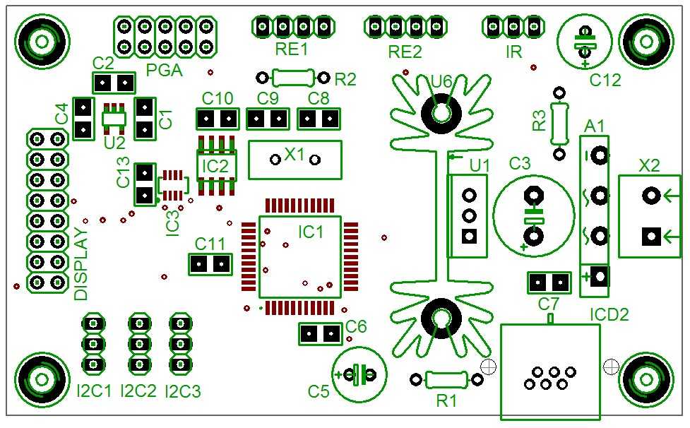

Hey Guys,
Thanks for all the nice comments. You guys rock.
Component silk for new preamp controller which will be part of Shin's preamp along with the PGA modules.
There are some extra bits there which I will use on some other projects.
I would post the full layout with traces but it would just be difficult to read.
Cheers!
Russ

I really hope you make this available to buy on your website Russ. For too long have folks going the active route had to put up with ganged pots such as those from DACT or attenuating at the source and losing precision with digital crossovers. Its all rather ugly and an instant turn off.
This solution is entirely modular where the controller can be connected upto many 2 channel PGA modules to provide the functionality needed. For example the preamp I'll be using will be a 10 in and 14 out solution:
Once thing the preamps won't do is control individual channel level, it only acts as a master control. A shame about that because some people would have found that useful for driver level matching. It can be done using the hardward but writing the software to provide this functionality is a major headache. Maybe in the future Russ or someone else will tackle this and provide the source code for us all to benefit.

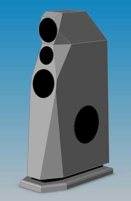

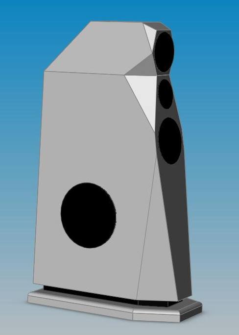

Hezz said:OK,
Not as large or as cool as Shin's design but it has a few similar design elements.
Whoa!
Hezz that is a beautiful design. Its hard to put my finger on one specific aspect but the overall shape is appealing and benefits sound in obvious ways. Its everything I like about a loudspeakers shape.
Tenson said:Can these pre-amps offer balanced in and balanced out?
I might have a customer who would buy a 6in-6out if they do, but he would want it fully built.
I don't know if Russ will be selling these or not, I just think it would be a great idea to do so. However yes they will run balanced in and out.
