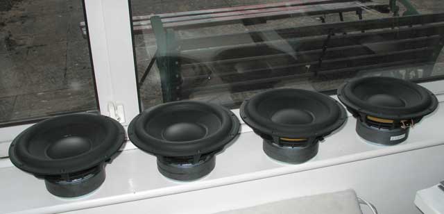

sploo said:That's a seriously good price for XLS10's. Please let us know if they turn up OK, as I'd be very tempted.
Hi Sploo
The drivers arrived OK and are new units. Excellent service from seller considering I paid for them on Saturday.

ShinOBIWAN said:The drivers arrived OK and are new units. Excellent service from seller considering I paid for them on Saturday.
That's great news - they look good too!
What's got me interested is that Siegfried Linkwitz is using them in his Orion speakers, so they must be pretty decent units.
Do you know if they could be crossed over passively - possibly in a three way XLS + 6 or 7" mid + tweeter configuration?
Originally posted by sploo What's got me interested is that Siegfried Linkwitz is using them in his Orion speakers, so they must be pretty decent units.
They're a modern day classic. With almost unique TS parameters and a suitability to tiny enclosures yet still yielding low Q and flat extension to the mid twenties.
They're also obviously well suited to OB usage although it might not be your first choice given the TS specs. Modelling programs also get the predicted response very wrong.
VC inductance is very high at 4.3mH and they have the cone breakup at 500hz. They're best suited to below 100hz IMO. The quad driver 130ltr sealed and 130ltr/14hz tune ported alignments I tried worked well for this subbass region sounding on the ball and tight.
If your crossing no higher than around 150hz then I think they could be well be suited to a 3-way. Active would be the better and preffered option as the inductor size required for a passive cross would be rather large and expensive.
Ah, I knew there was a reason why low frequency passive systems weren't desirable - just couldn't remember it was do to with needing chunky inductors.
To be honest, crossover design is something I have precisely b*gg*r all experience with. I'm just trying to persuade myself to buy some drivers and actually have a play.
I'm planning to mess about with a few sub designs (probably 2 driver, sealed configuration). For a potential three way speaker, my intention would be to cross over with a 6-7" mid/woofer at somewhere between 100 and 200hz.
Thanks for the heads up on the issues with modelling programs BTW.
